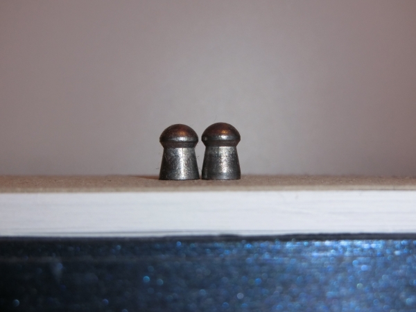

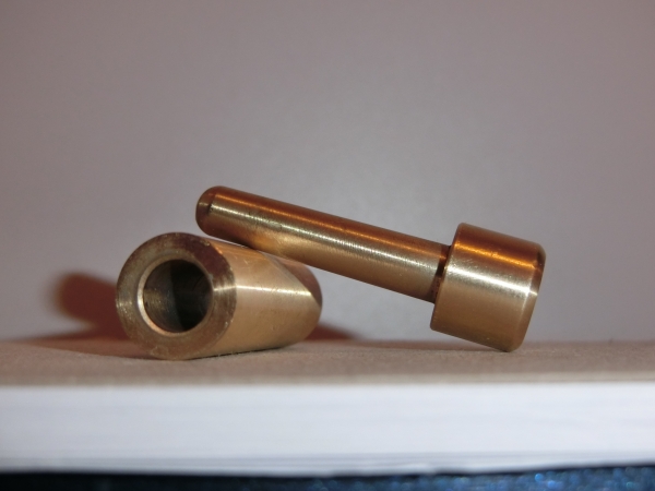

today I’ve got a pellet sizing tool from Krale in cal.25.
I have sized a bunch of pellets so that i can be sure that my ST Barrel has a chance for his lead build up, and then I can say something about accuracy.
Here are two pellets, they are the JSB King heavys .25
the left one was original, and the right one was resized.

At Saturday I’ve time to check out if it helps accuracy wise.
so I’m pretty excited how it works with my rifle. 😉
cheers Patrick

Yes me too, I just Gotha recommendation when i was surfing on his Website and then i thought ill give it a try. I really dont know whats best for the FX Barrels, so I just have to try if it works or Not. But I realized that the heavy kings have little more skirt diameter than the 25gr kings.

Yes it's pretty cool, but I hope i brings some improvements. Jup it sizes them to .250, so my thinking was that the pellets with smaller diameter get more speed on the smooth Part of the Barrel with less friction, and because of that it needs less air to accelerate, and then maybe i get more shots on a full Charge of the rifle. But maybe im wrong, at saturday i can say more about it.😉
