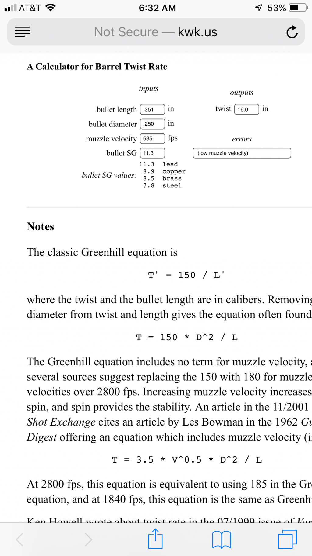

1556274860_14913847815cc2deac2036c8.10895056_52D274CB-86F8-4A8E-BDD8-84EFBD4B9CE0.png
Notice the I’m supposed to be shooting JSB 34.95 at 635 FPS to be “optimal” with a most common 1:16 air gun barrel twist rate. Until recently that is. Well, Sumatra’s, Evanix, have used rates from 1:16 to 1:28 and my 190 yard dead on shot is from a .253 Sumatra with a 1:18 spitting a 34.95 going 950 FPS if my BC is correct at 0.455. Let’s see what The Greenhill calculates for my specs.

The poop gets complicated. Here’s the one I just used for simplicity http://www.kwk.us/twist.html but, I’m told The Kolbe/Miller is best for subsonic correct returns for air guns specifically slugs. In pellets you have A LOT more forgiveness if twist isn’t perfect for diameter/length/weight/speed/SP.
