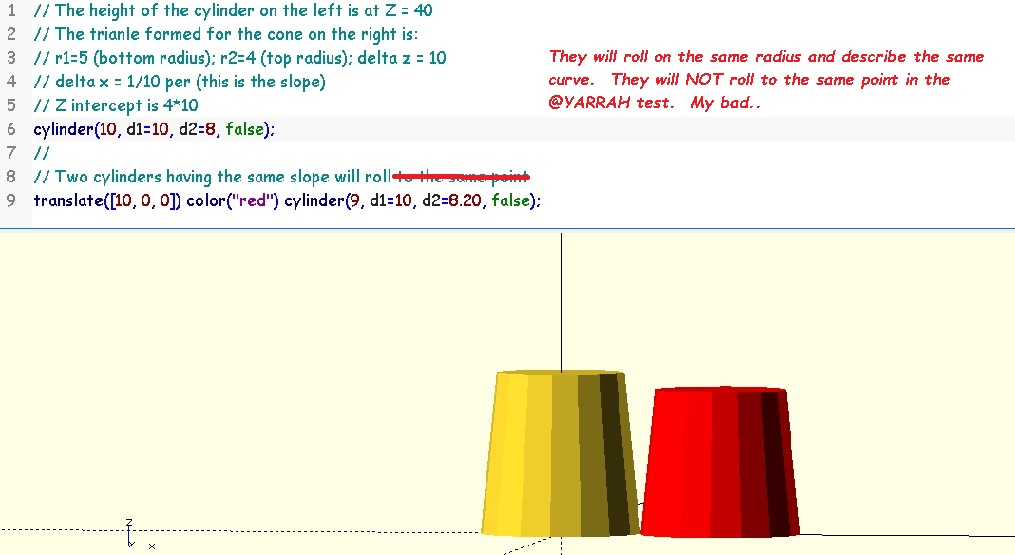

Would you not need to measure the overall length of each pellet as well? 2 pellets with exactly the same head and skirt diameters, but differing overall lengths will roll a different arc, won't they?
Nailed it. Well done.
EDIT: I had not considered that different sections are rolling on different radii. We place the pellet at the same place every time. A section from a different point on the cone will roll on a different radius ... THIS GRAPHIC HAS BEEN EDITED to correct this assertion.
BackStop: the point of rolling it is because it’s hard (if not impossible or impractical) to try to measure each pellet for the reasons you outlined.
But it doesn't actually provide any useful information unless you measure the length of each pellet before rolling. ... and sort by that. I do think that MIGHT be a good solution to the problem and yield positive results.
I'd have to spend more time than I want trying to prove there are other is any way the two pellets which are different could roll to the same point and I am not sure I could prove that. Perhaps someone else would like to tackle that geometry problem, maybe one of the folks here who really understand geometry. Not my long suit.

I have asserted (above) that different sections of the same cone will roll to the same point. They wont. Because they are rolling on a different radius. My bad. This proves that assumption was false:
