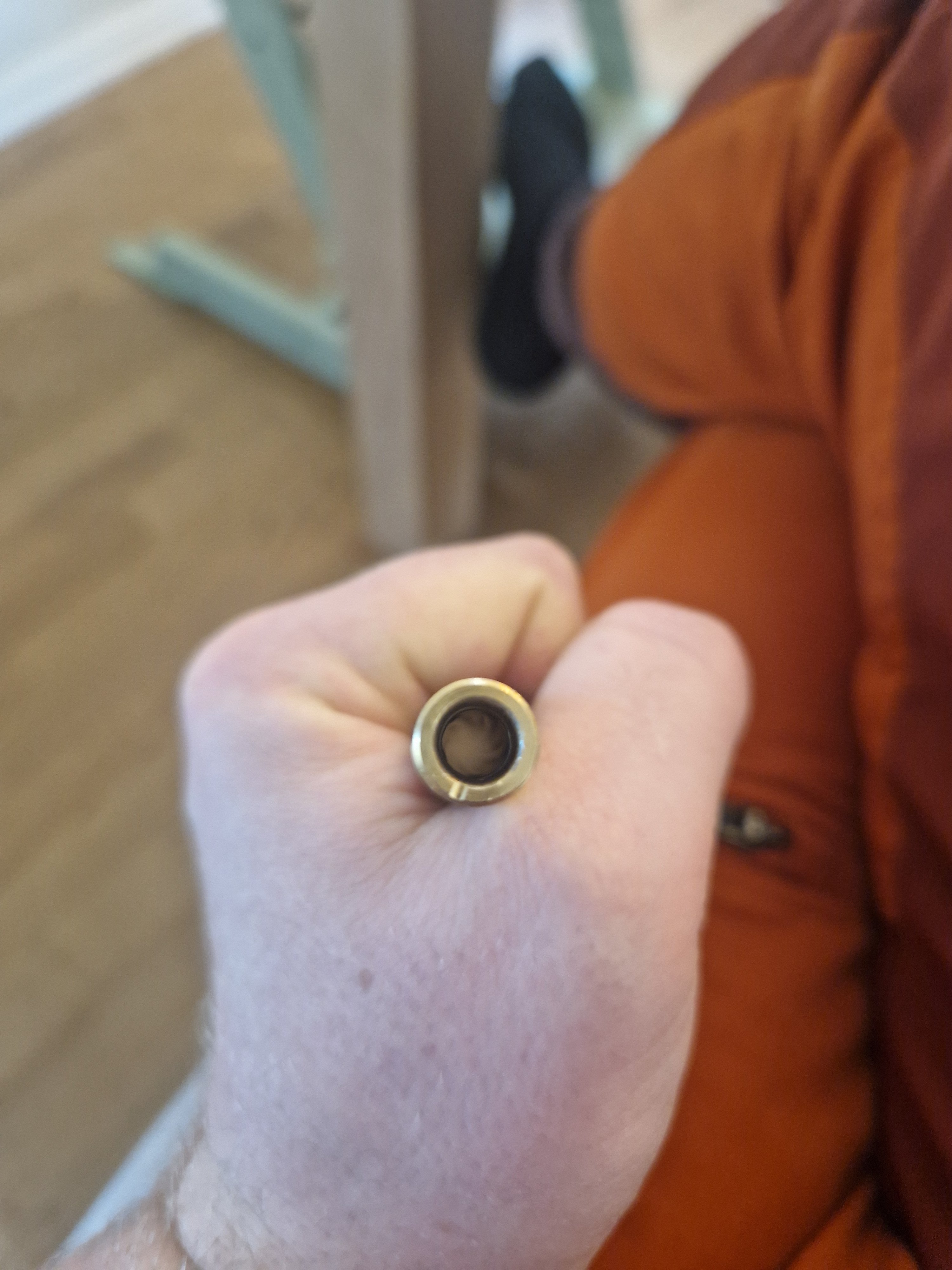

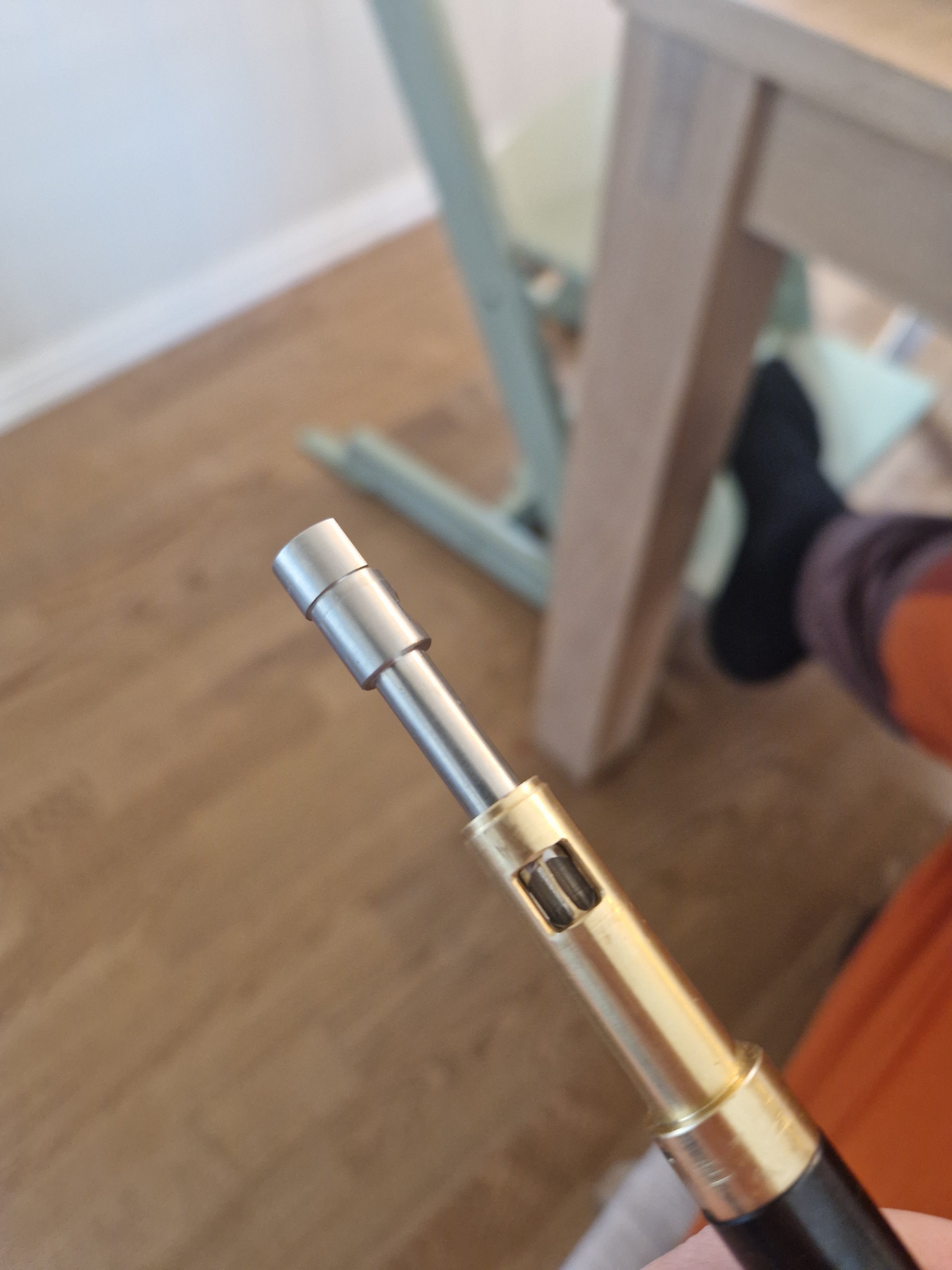

Hi. When I was shooting my drs today i noticed that my barrel had moved 1-2mm forward (the brass that sticks out to guide magazine was flush with the block) dont know how long its been like this, probably since I upgraded it from 177 to 25. So I let all the air out today and took off the air cylinder loosend the 3 set screws and pushed it in and put everything together and filled it up again.
But now I had to force the cockinglever open the first part, I tried to close it and it goes smooth all the was until the last mm. This was not a problem before when the whole barrel assembly was "wrongly" mounted. Does the liner go all the way back so my pellet probe get stuck inside the liner?
Edit: there are no visible marks on the probe.
I did not clean anything, just loosend the 3 grup screws and pushed the barrel assembly in all the way where it supposed to be. I did not have any acc or fps issues before either, but after pushing it in where is should be i gaind 20fps so maybe the 2 transferports where not lined up before. But still dosent explain why the probe gets stuck, I can try to film when I come home from work.
The probe hits the liner is whats the problem, I dont know if there is any adjustments to the probe so I can dial it back 2mm? Cuz the liner will have to stay where it is, and option is to put on a slug probe so the edges on the probe wont hit the liner ? Also looks like the probe pushes too far when lining up with the tp so the best would have been to adjust the probe back if thats possible?
Yeah i was thinking of take abit off from the probe, i also tought about opening up the liner abit but was unsure of how it will seal agains the slug/pellet. So a quick fix now was Just to take the liner out and put a oring in the to get the needed space for the probe, dont have any idea if it will blow out, if it does my liner will become loose xD but I put everything back together and shot 20shots im happy with without getting the probe stuck. Theese are easy airguns to take apart, the longest time is to drain the air out :D
