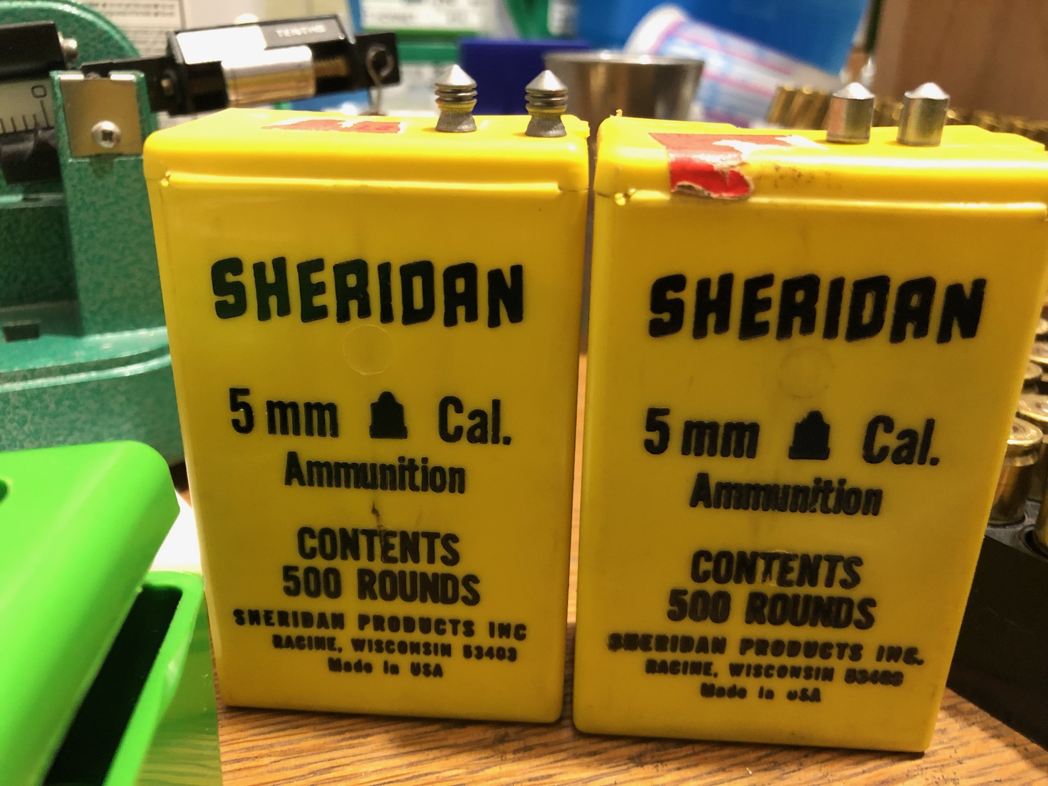

My friend just pulled these out after DECADES of storage. After rebuilding his Blue Streak (also stored for decades) he put them on paper and shot perfectly fine.
