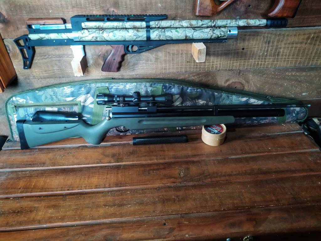

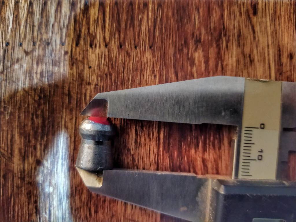

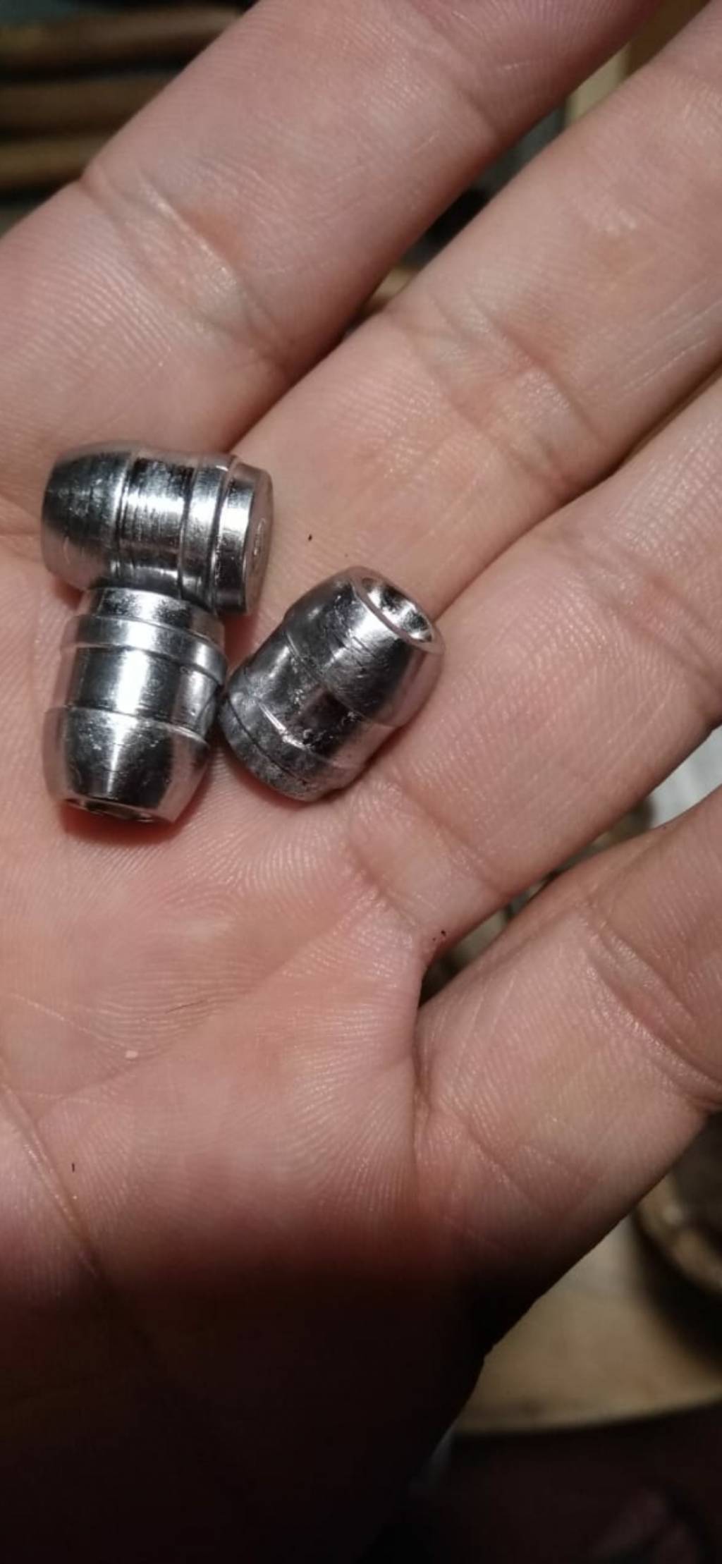

Hi to everyone from Uruguay, I want to know if any of you know, if exists o some in the USA that could make a .45 pellet mold, so I can make my own pellets.
Here in Uruguay It's not easy to purchase .45 pellets they are very rare ( I have try different slugs but with 185g pellets my pcp it's by far much more accurate).
Any help will be very appreciated. Here are some pictures of the pellets that I'm using and the gun thanks.
Contact these guys is you want a custom mold made. They have the ability and can do it to your specs. You need to be specific in the pellet head and skirt size that you are seeking to shoot, as size matters when they drop and cool out of the mold. Sending them a couple of pellets pushed through the bore would probably be best to get the best possible sizing.
http://www.accuratemolds.com/index.php
Noe and accurate molds are top notch. I've used a ton of them for many different applications.
I know noe does some pellet type molds and tons of bullet and slug styles that might fit depending on what you're after.
Lee push through sizing dies and a little hand press will make sizing them however you want.

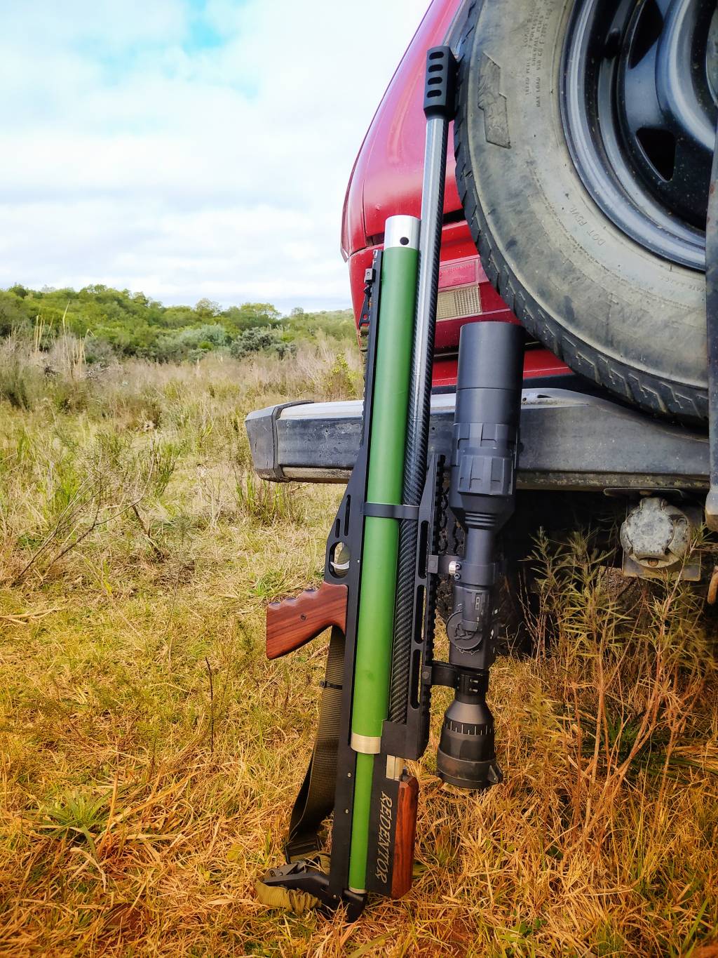

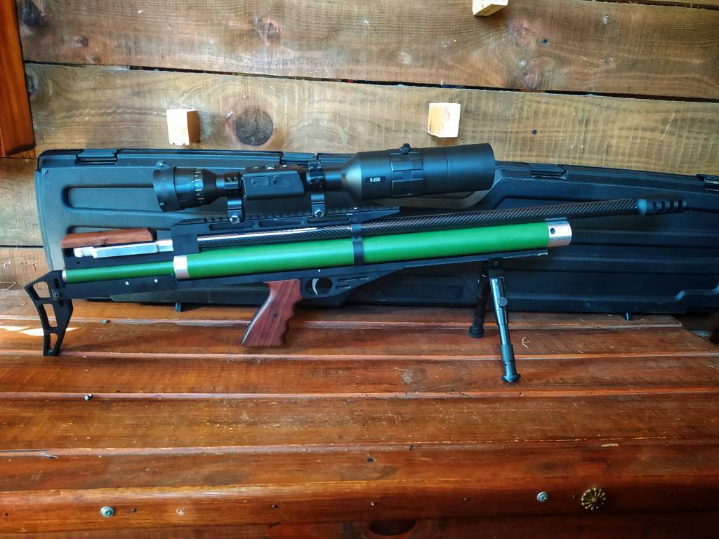

I am intrigued by the gun. Is that a homebuilt or custom made?
It's a custom madebased on the Slayer 357. It's pushing 185g pellets at 1070fps ( 3 shoots)
This is the original color.

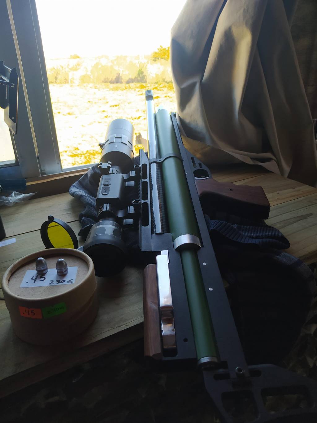

It does resemble the Slayer. I looked up the definition of "Redentor" and find it interesting, 'redeeming' if you will. It is really slinging those .45 pellets. It looks looks like it is set up for long range shooting, have you tried any heavier hollow point bullets yet?

Thanks , yes I have try hollow points and 230g solids but I haven't have goods results at more than 35 yards (but with the pellets shape it's very very accurate) ,here it's difficult to find that kind of ammunition so I don't have much variety.
