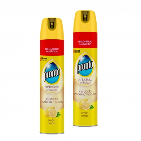

Hi Tom
You know what are the chemical components that the product must have so that it performs its function as a correct lubricant for pellets because pledge lemon is not marketed in my country but I have found this product from SC JOHNSON and I wanted to know if it could be useful
pronto-de-sc-johnson-limpiamuebles-para-madera-con-aroma-limon-300-ml-pack-de-2-unidades.16083...jpg
Regards
Enkey
Nation,
By no means am I a chemist, so I'll just leave this here.....
Lemon Pledge Ingredients, listed in this order on the spray can.....
Water, Isoparrafin, Dimethicone, Octyphosphonic Acid, Nitrogen, Polysorbate 80, Sorbitol Oleate, Polydimethylsiloxane, Aminomethyl propranol, Fragrance, Proprietary acrylamide thickening agent, Methylisothiazolinone.
SCJ Formula #35*16409
Sounds like something one would use for an IED.......
Too complicated......maybe just try pure lemon oil and call it a day.......
