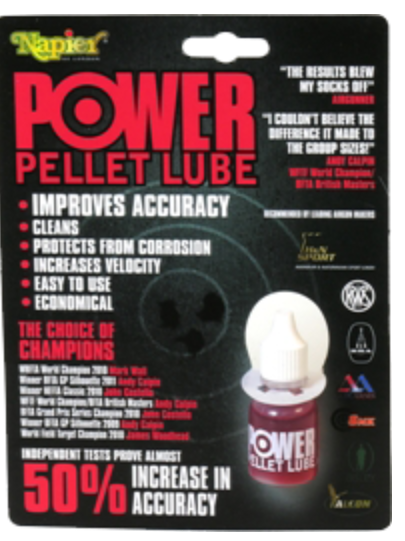

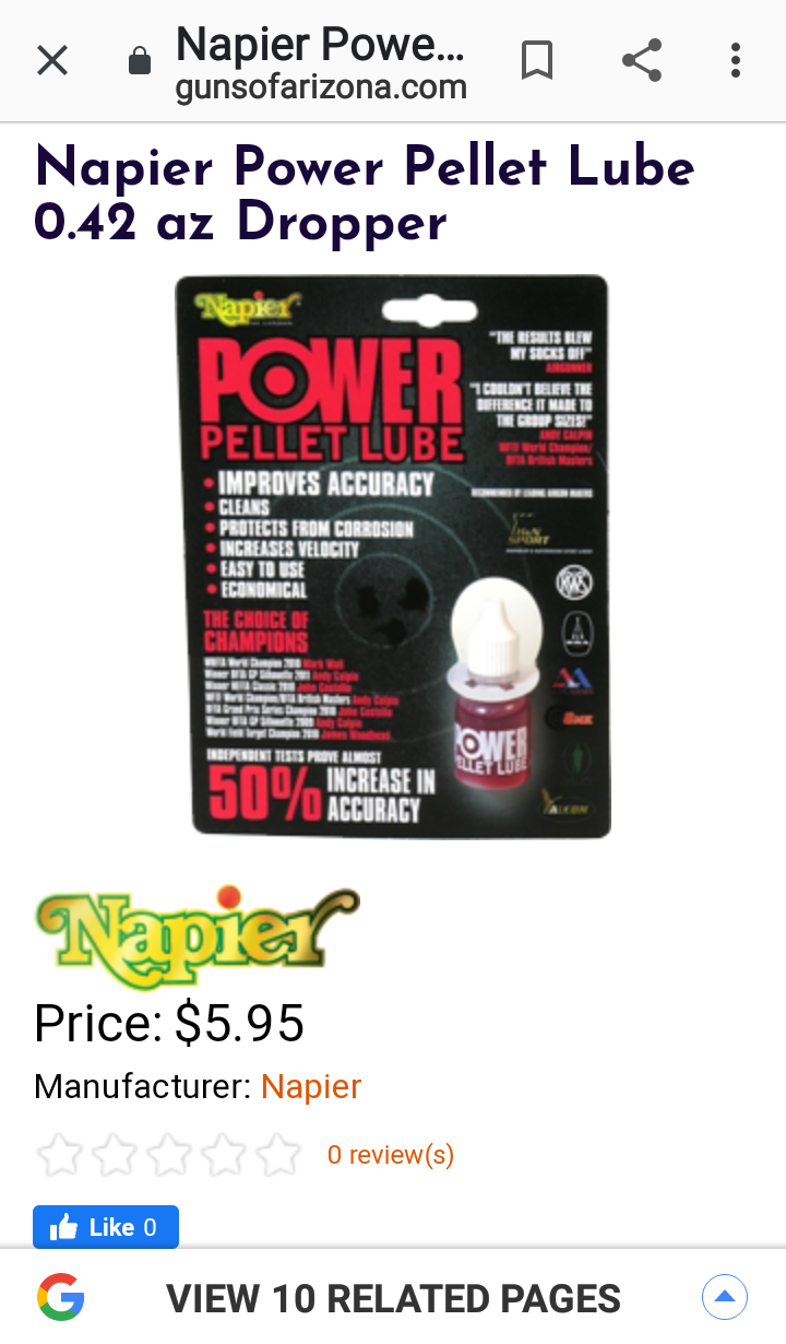

Started with FP10 then Slick50 ONE LUBE then all the nasty stickies and screws up the magazines and smell and irritation made me change to Lemon Pledge.
Pledge to prevent fouling the barrel and Lemon scented specifically to increase accuracy because Tom Holland uses Lemon scented. NO he didn't specifically state that it enhances the accuracy but I think it might.
THIS DIDNT INCREASE MY ACCURACY BY 50%.
YOUR RESULTS MAY VARY. SURE LIKE TO HEAR SUCCESS STORIES THOUGH!!!
