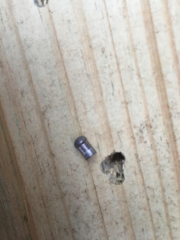

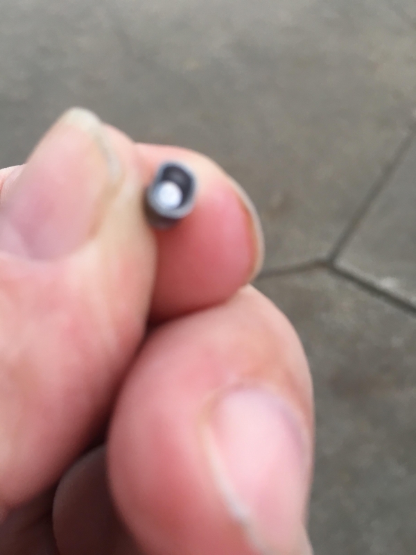

That is what I'm seeing too Ken. If the skirt is just bent inward, it flies alright because I think it gets straightened out. But if it is not bent in, but crushed toward the front of the pellet or if there is a nic in the skirt, it makes a difference.
Granted, I wouldn't shoot these in a match. But for chrono testing or seasoning a barrel they work just fine. And I wouldn't be afraid to shoot them at a pest critter. They seem to shoot pretty good MOST of the time.
