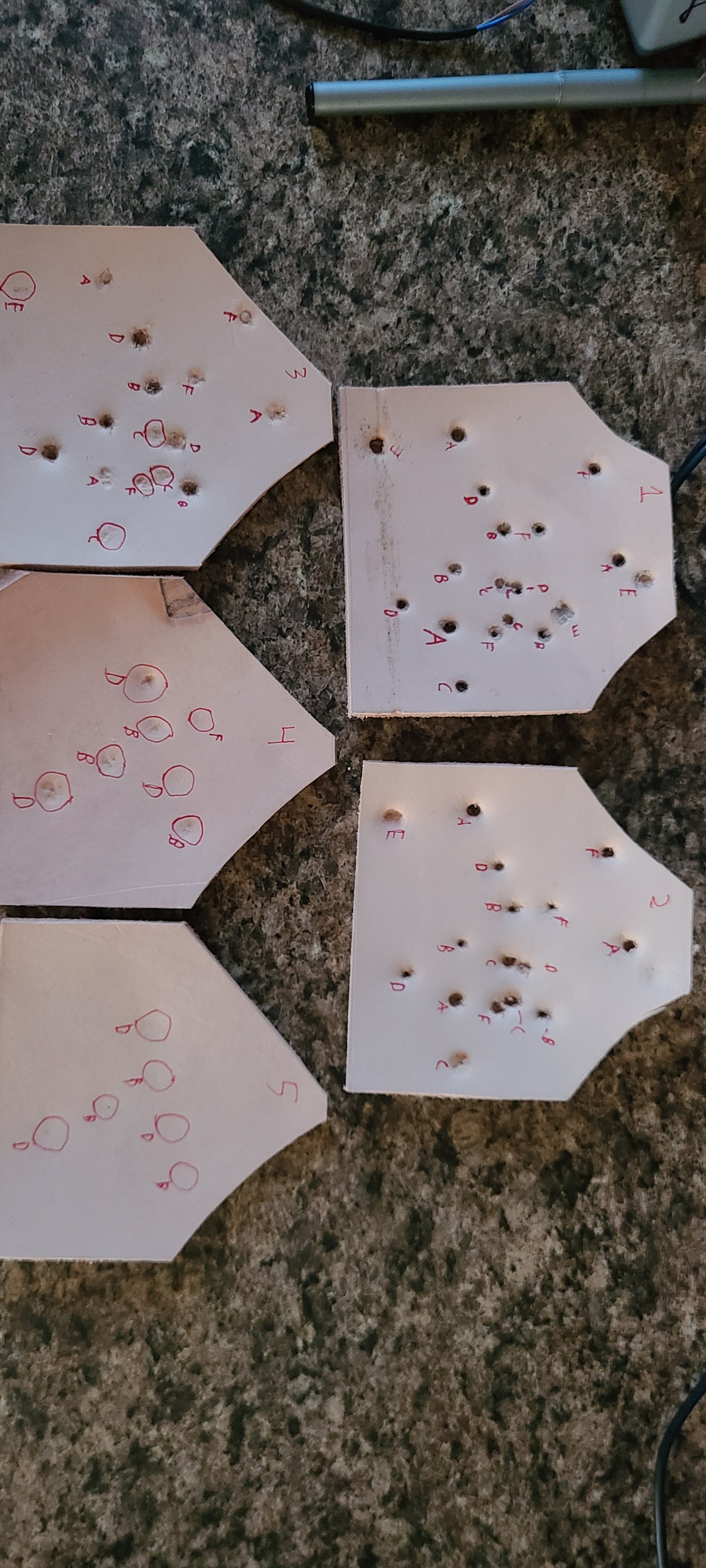

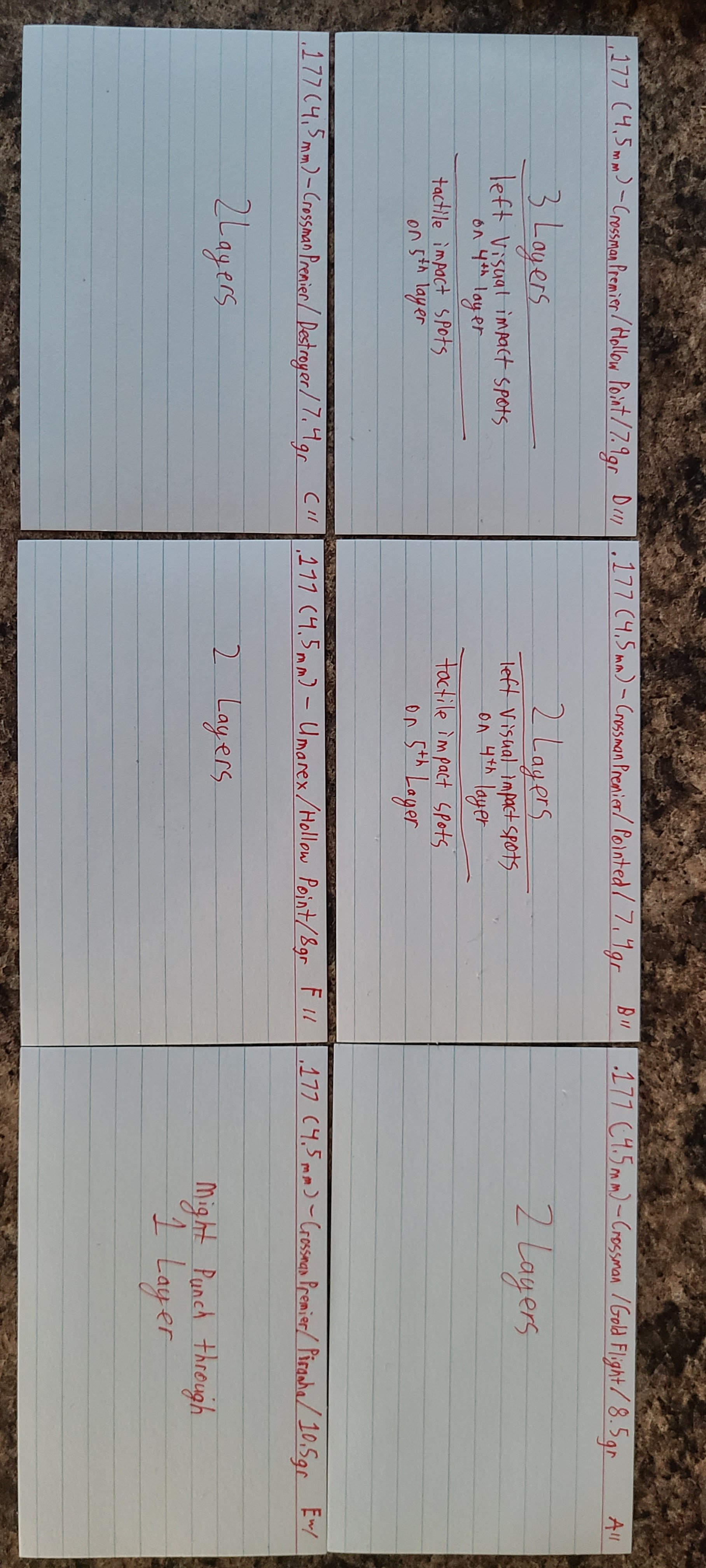

So I did a test, I took my Gamo Whisper Fusion Mach 1 and fired 6 different pellets, 3 times, for a total of 18 shots into 7 layers of 8oz leather set back at 15 yards or 45 feet. Now I will let you all do the math for multiple layers but, 1 layer is 1/8 inch or 3.2 millimeters thick. Also anyone who know leather or hides knows that this stuff is tough. There will be accompanying pictures to show the layers of leather and also the expanded pellets. I only needed 5 layers and wasn't able to recover the 3rd pellet for 3 of the types but the results are amazing.
I normally have 2 additional pellets on hand but, sadly was out for this experiment. I normally have Gamo Pointed Silent Cat and also polymer pointed Red Fire pellets in my stock.
1 Overall I am disappointed in the Piranhas (pellet E).
2 The Gold Flights (pellet A) are decent but expected more from them.
3 The Destroyers (pellet C) had excellent expansion as you can see.
4 The Point and Crossman Premier Hollow Point (pellets B and D) both left deep impact marks on the 4th layer and you could feel impacts spots on the 5th layer.
5 Between the Crossman Premier and the Umarex Hollow Point (pellets D and F) the Crossmans are better as far as penetration, however; the Umarex pellets have a more even expansion. They actually roll down the side.
