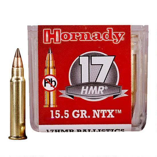

Do you have any pictures of the Hornaday bullet?
There's a picture of a factory load of .17 HMR, to give you an idea of what the bullet looks like. The part that you cannot see is the rounded boattail on the back of the bullet.
To the other responses, my follow-up question in terms of "oomph" required by an air rifle to shoot a projectile of this size: The picture above is a non-lead 15.5 gr offering. Standard lead Hornady rounds are 17 gr.
So is the conjecture that a 20+ FPE air rifle still is not enough to push a 15.5 or 17 gr round down the barrel reliably, or that the shape and copper-cladding of the bullet is not ideal for air rifle pressures in the barrel, or that the round in general is just not ideal for flight under 1150 fps? Or maybe a combination of all?
