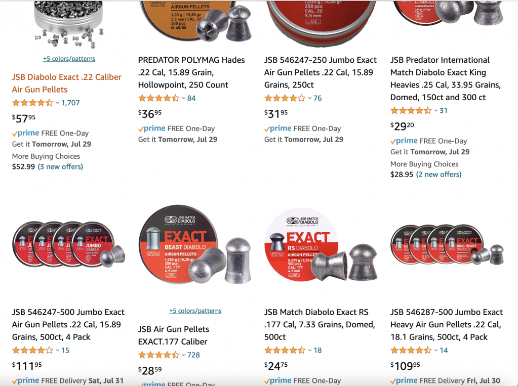

Amazon has JSB’s in stock, with free shipping (for prime members)……$57.95! It’d be cheaper to invent an airgun that shoots dimes…..

Just looked and it appears that A LOT of Amazon vendors are price gouging right now.

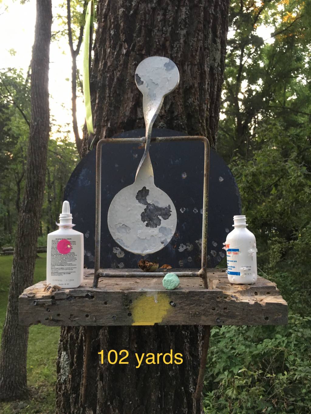

For the O.P.'s question, if getting into airguns right now you might want to look at picking up a gun in .177. Especially one which is easily converted over to a larger caliber later. For a quality gun the Crown really comes to mind. I can be as accurate with a nicely set up Crown (especially with a GRS stock) as I can with my RAWs, at least out the the 100 yards I have shot them.
