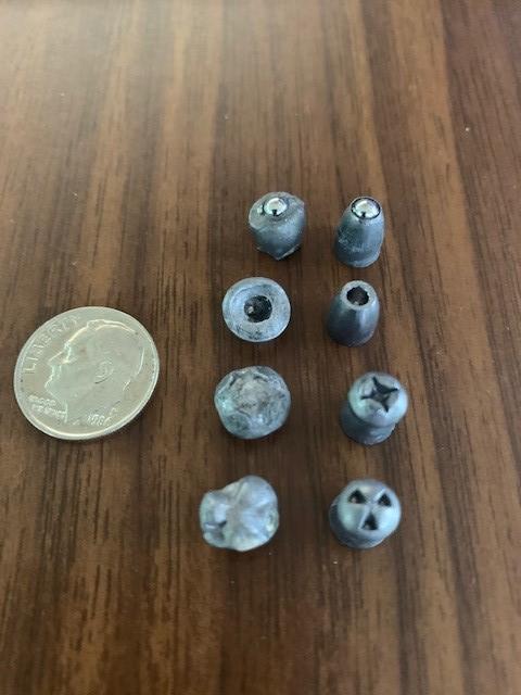

Thought I would share the group- I used my FX MK 1 Impact .25 w/ STX 700mm slug barrel shooting around 820 FPS at 35 yards for pellets and 745-760 FPS with the slugs at 35 yards. . I used the following pellets and slugs...
From top to bottom:
34 gr Lead Fist slug
29 gr NSA slug
28.24 H&N Baracuda
26.54 gr JSB Hades
26 gr FX Hybrid slug (not picture in the expansion)

The slugs where shot into an electrical box filled with HVAC sealant putty.... Its soft and pliable but harder than clay ...EdgunLeshisey has a you tube video on how to make them
A little different than recovered from a (once) living target but still interesting. If possible, post some pictures of pellets recovered from the "pests" you eliminate and post those.
I like to test my projectiles in the same medium that I will be hunting. I found a good method is to head shoot a squirrel and then use him as a test subject. I will take a rolled up t shirt placed behind the squirrel to catch the projectile. It’s a great way to study expansion in the actual target that you will be hunting. Here is a post with lots of photos I made a while back about my method with my Impact and NSA slugs.
