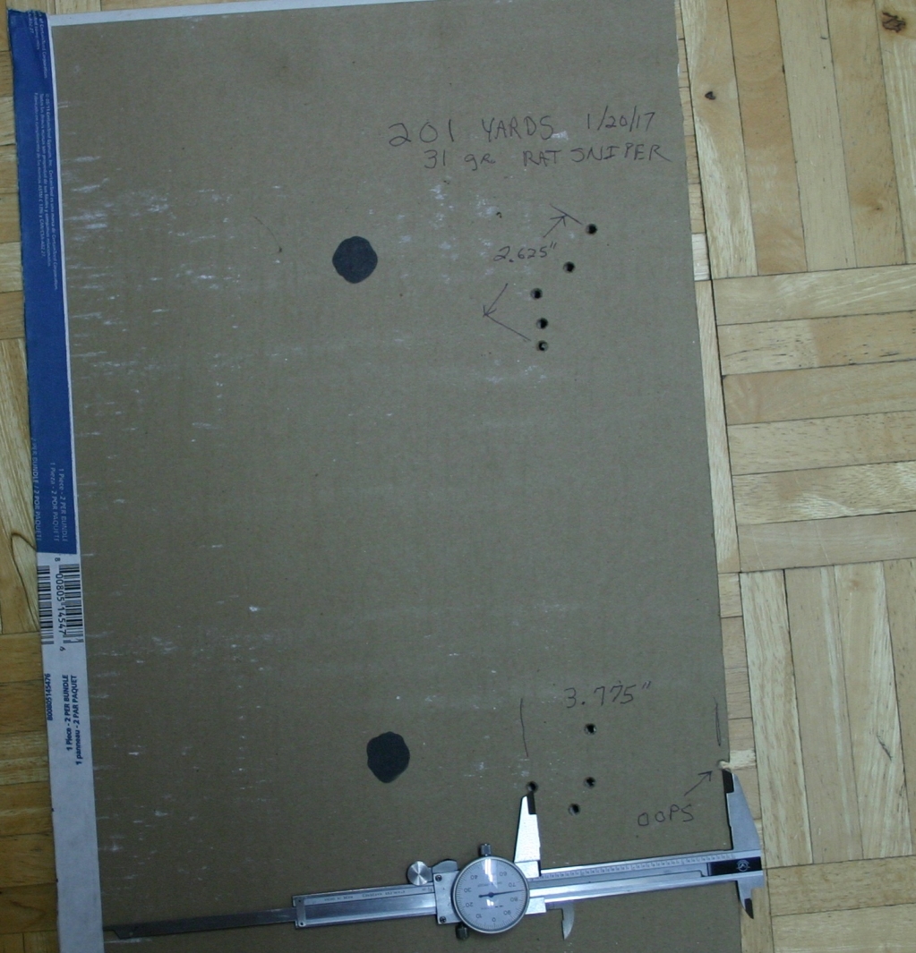

Old photo. All consecutive shots. Held wind-age for the 4 holes in that 12 oz, can on a stake. The last two pasted right trough the 2x6 Cedar block. This with a stock Cricket .25 cal.
I've shot lots of 200 yard groups in the wind recently. 2.5" to 3.75" for most with a couple going 4+" and a 2.125" best. Not photo worthy for me.
That's with a 75 FPE gun - 38gr.@ 940 FPS. A work in progress.

That is obviously a cherry pick windless day for my stock Cricket. It just shows what type accuracy can be achieved. Shot off sand bags on the roof of a VW Jetta.
I would expect groups closer to these. But I've not tried the 30.5gr. that shoots sub MOA at 100 yards consistently at 200 yards.
To busy getting my converted .35 to .25 cal. Cricket going. That's the one I say 200 yards is no big deal for.
A 38gr. slug going 940 FPS gets there pretty fast.
