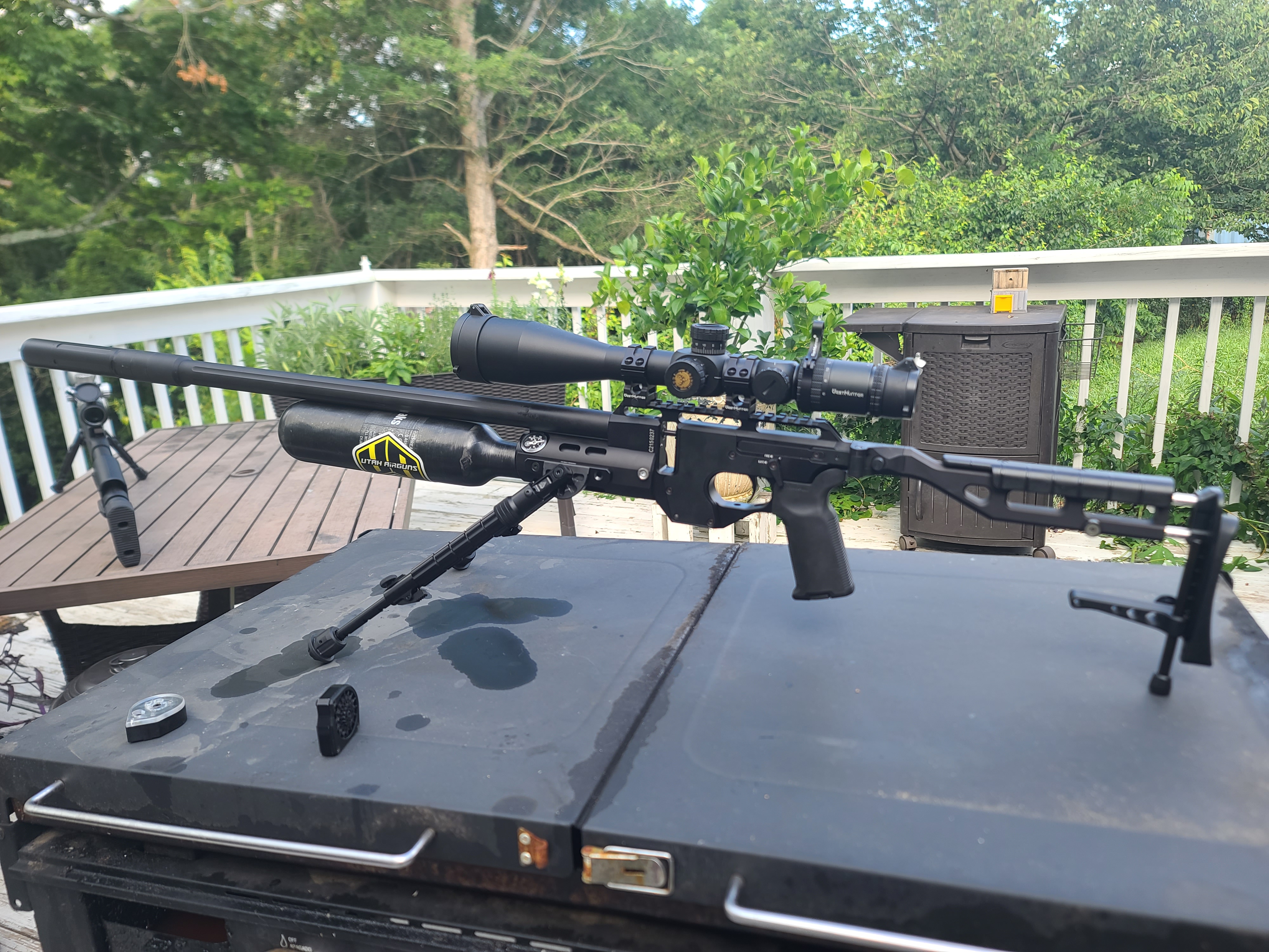

I just received this Airmaks Katran today and I may say it is the smoothest thing I have shot. I may have to recend my previous statement. Lol
