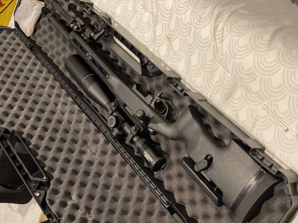

My vudoo walks circles around my impact, which is why I no longer own an impact. These rifles are among the best of the best when It comes to rimfire. Now to build my self a centerfire..

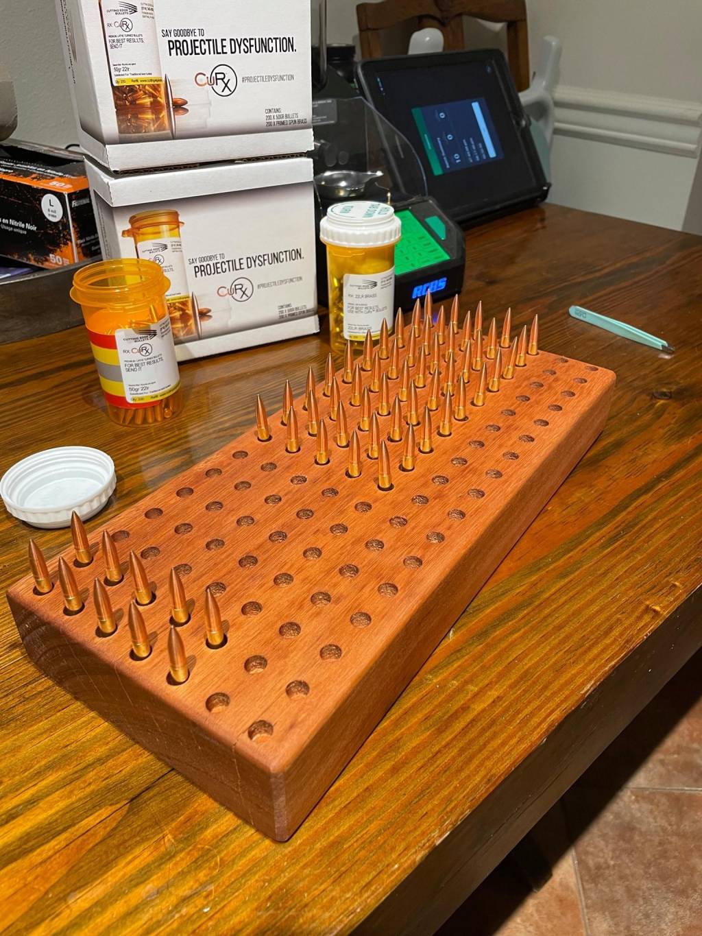

.22lr is expanding as well, these are hand loads. 50gr bullets. 1400 fps .214 bc. Airguns won’t catch up to rimfire ever.
I’ve been working with the 32gn bullets, don’t have a fast twist barrel yet (on order). Do you have a load you like yet? I have a “good enough for hunting” load of 2.2 Longshot with the 32gn (1 to 1-1/2 MOA @ 100 yards), hoping to squeeze out some more accuracy/consistency. Not sure how far we can go with the CCI brass.
