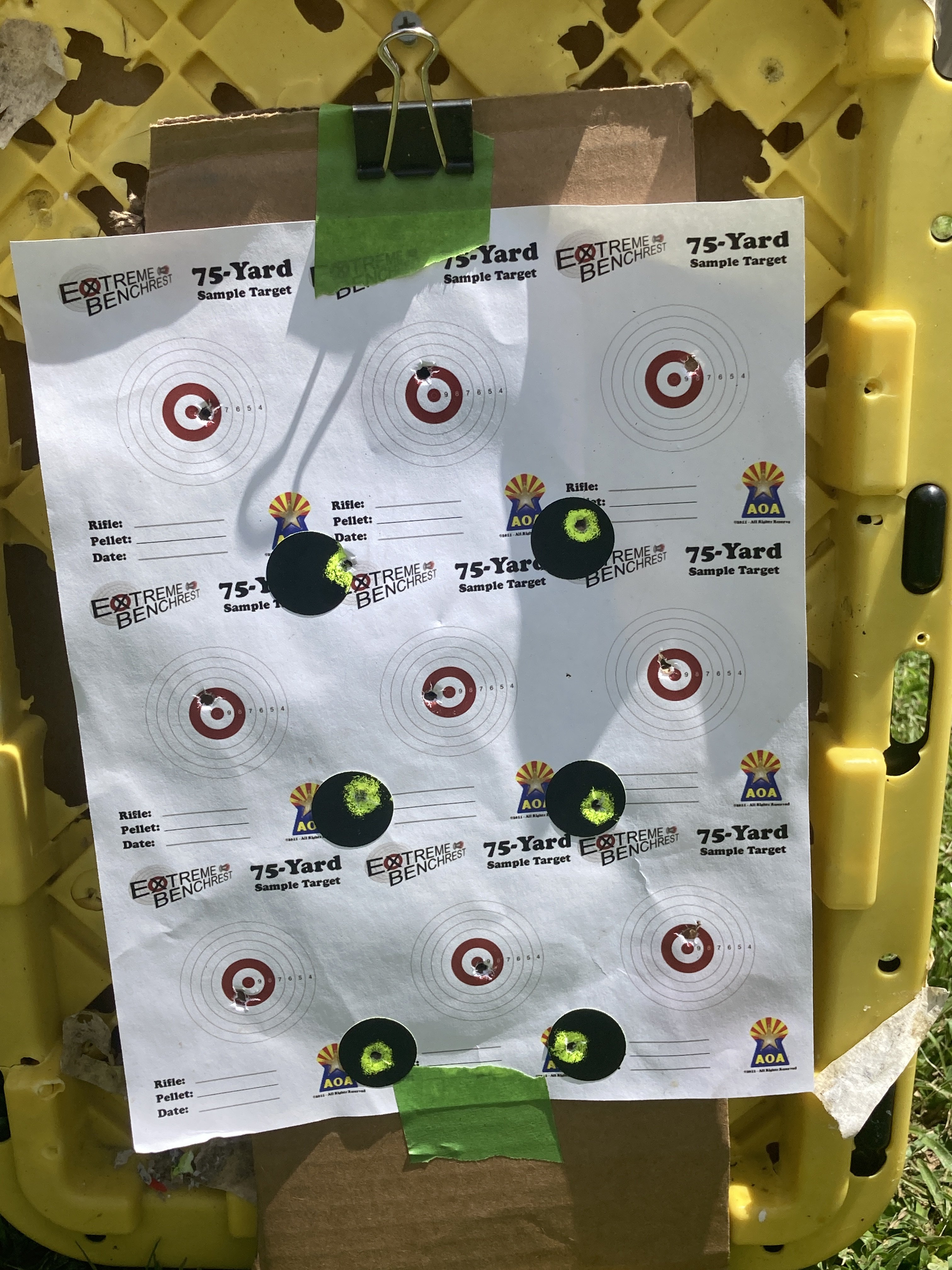

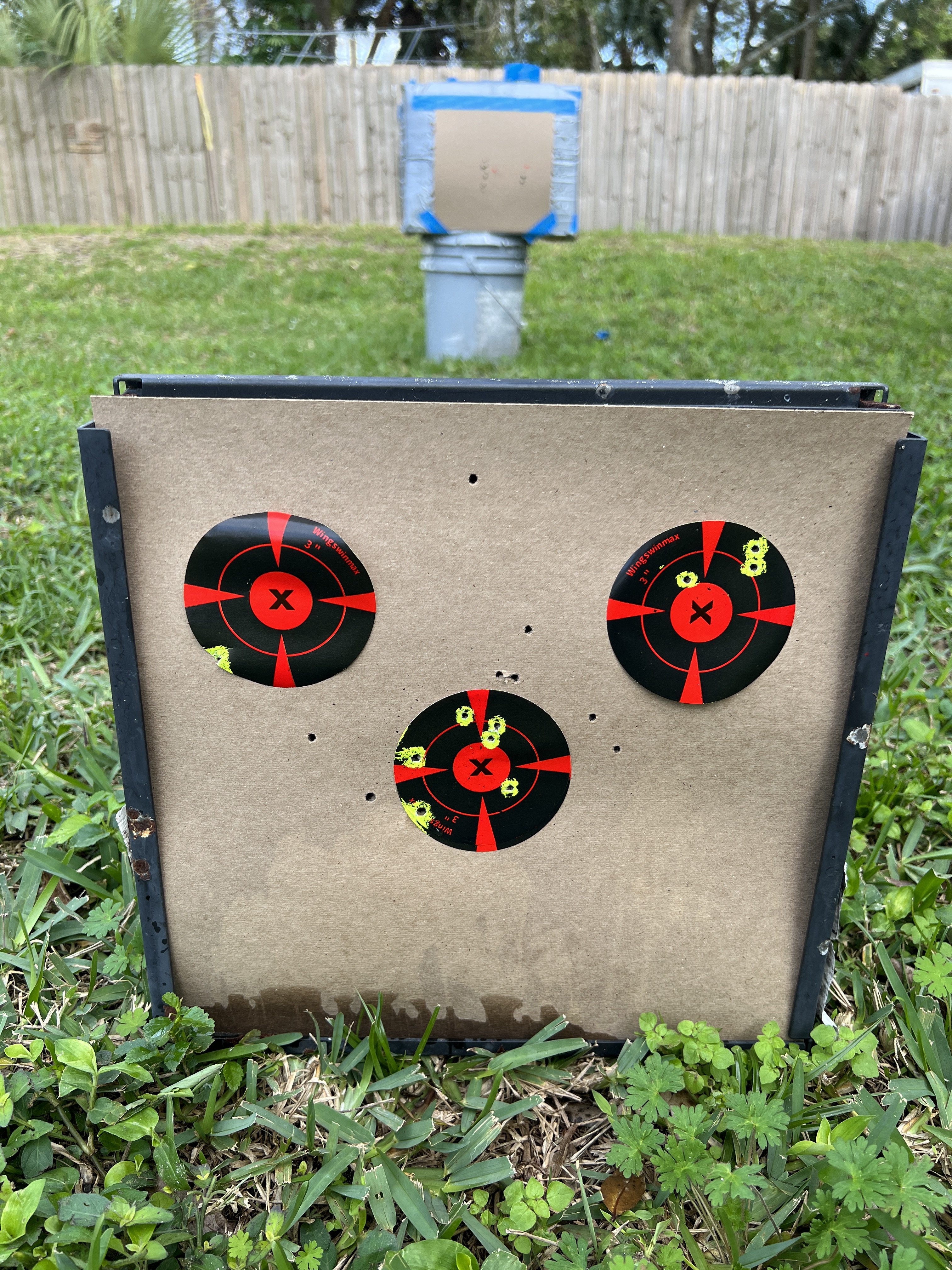

The tuning is vastly different for each. My suggestion is to build a catch box for the targets. I like fabric in a box or rubber mulch in a plastic container. The mulch is reusable, add water the mulch will float and the lead is at the bottom.
Reactions: floridaman
I also have one like mentioned above. The only drawback is the noise they make. My wife could hear 40FPE impacts 400+ yards away. I was in our yard and she went on a walk.
If I don’t want people knowing what I’m doing or shoot early in the morning I won’t use it.
The shots on that target are with a low power springer with open sights. It doesn’t make too much noise with that 9fpe 177.
