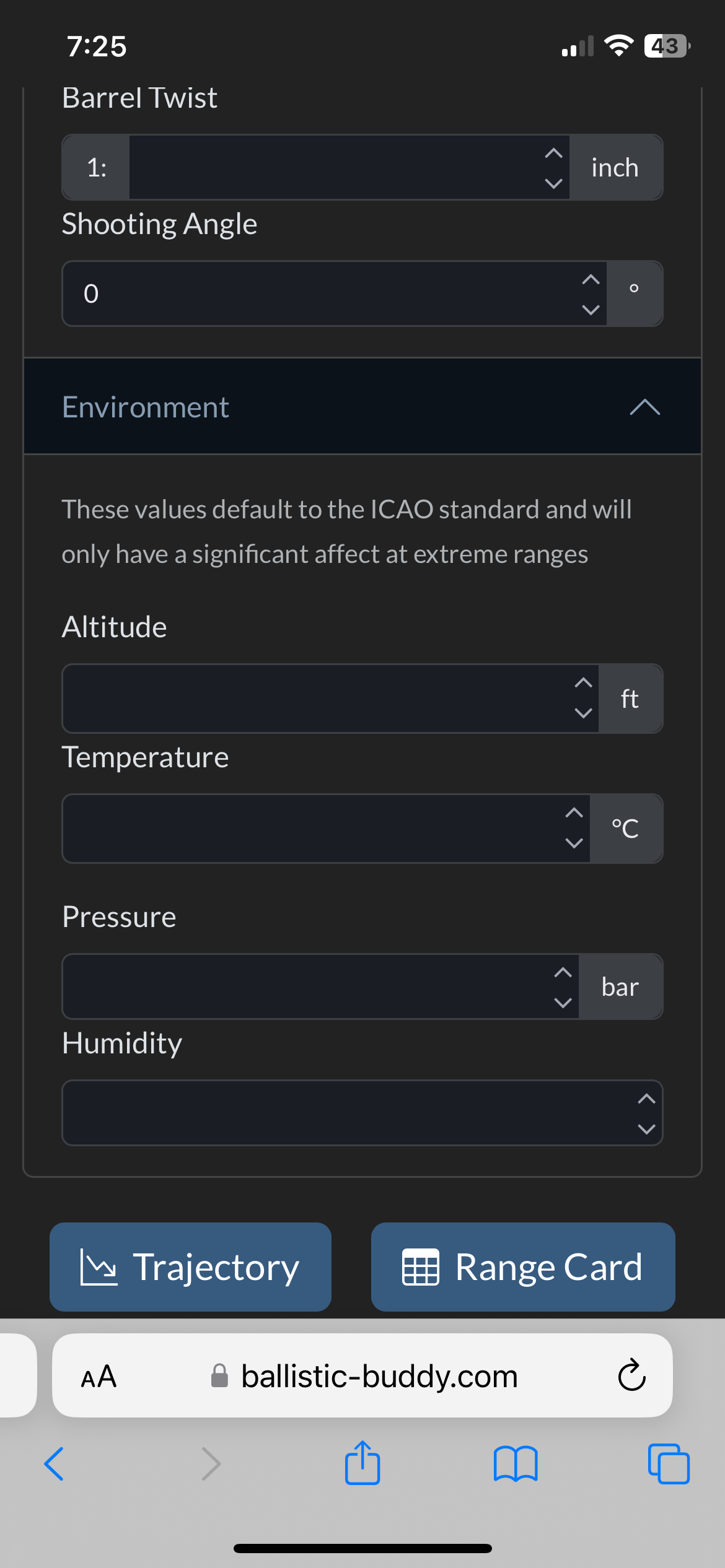

No environmental inputs so only useful at sea level presumably...
-Matt
say wut?
