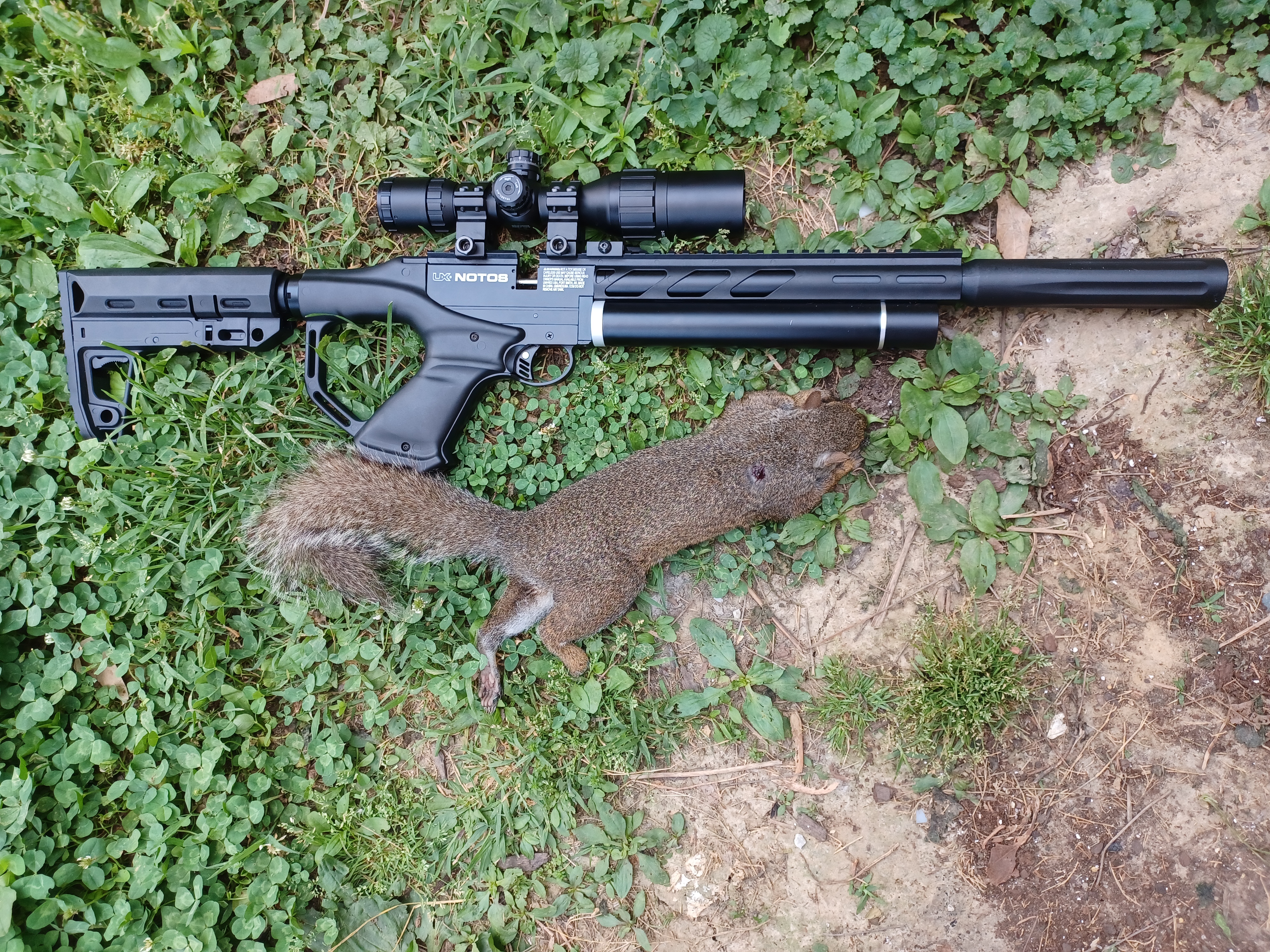

I will recommend my favorite PCP, the SPA P35. I have a 177, 22, and 25. Either of the larger calibers should meet the need you described for less than $500. The Stoeger bullshark is almost exactly the same gun. I added over an inch to my length of pull and they are still just over 30 inches. That also includes pushing the shroud forward about 1.5 inches so I can insert a 120mm printed moderator. They are about 85db with these inexpensive moderators. I'll include a picture of my P35-22 in it's home made cherry stock with a raccoon it killed last week. About 7 3/4 lbs - so a small one. It is tuned to about 32 fpe. My 25 came tuned to about 40 fpe and is in my opinion a better choice for raccoons. My 177 and 22 are very accurate, my 25 less so. But the 25 has killed the most squirrels so far, 18. They also weigh just over 5 lbs before you add a scope. They are regulated. Fill pressure is 250 bar so they could be hand pumped but it will take quite a few pumps.
