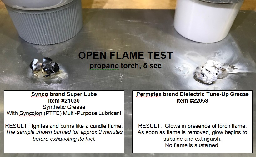

Super Lube is a family of lubricants, some of which are pure silicone. Those are perfectly good for PCP use. However the ones marked "synthetic" and "with Syncolon" are highly flammable. An example:
Krytox is great in terms of its lubricity and inflammability, but needlessly costly for PCP use. The one airgun application I'm aware of that can benefit from it is a synthetic piston seal in a springer / gas ram powerplant.
PSA: do NOT EVER burn PTFE-laden products. This releases fluorine gases that are extremely toxic.
Also do not burn Viton (FKM) or Kalrez (FFKM) O-rings.
These products do have higher operating temperatures than standard sealing and lubricant products, but a torch flame easily exceeds any of these materials and the fumes are NOT SAFE in any quantity.
