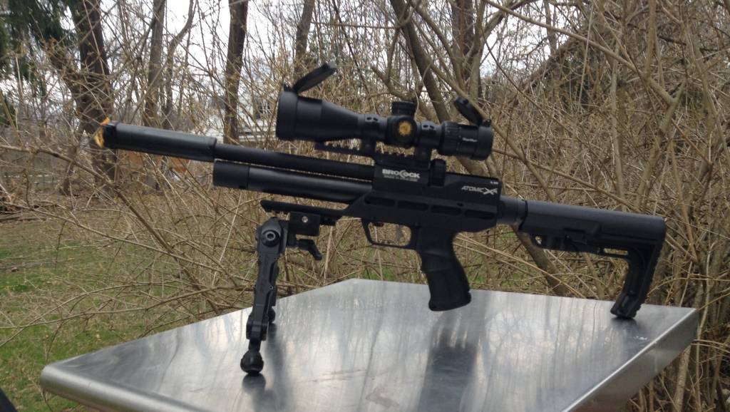

@ltchip, regulated also means that you retain that shot to shot consistency even with partial fills of the gun. I would second a .22 Atomic XR if you could swing it. Easily hand pump able and fits your requirements. Look up the specs, here's mine, under 7 lbs. scoped, without the bipod.
