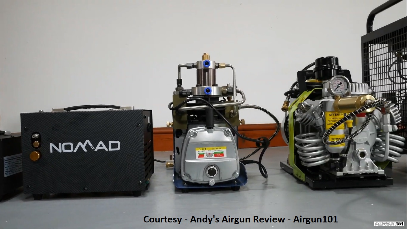

this one is for the long term PCP users out there.
Could You pls. suggest which kind of the PCP Pumps last long on regular *usage?
consider 300cc bottle fill thrice a week, or 15 fills a month (i m at this stage at the moment).
I have the hand-pump and it's sure the best fit on long-life requirement but i'm looking to buy an electric option.
Which last longer than other requiring comparatively lesser service/maintenance?
  1. Desktop Sized Portables (e.g. Nomad 2/Chinese Make)
  2. Noisier heavier but still portable ones, e.g. Yong Heng
  3. Heavier, water-cooled e.g. AirVenturi 4500 - these can fill tanks
    (not breathing quality though, but not really portable either as they weigh around 30Kgs)
    Attached is the snap from Andy's Airgun Review on Airgun101 Channel here.
My intent is to buy a long lasting one, say 4-5 years at least...
-SoulSniper
Reactions: 2372ighost
My cheap Yong Heng is 3yrs old and still going strong on all the factory seals. I change the oil every 5 hours give or take which between filling my Dreamline and Marauder is probably every 300 or so fills. Long story short, it doesn't get changed all that frequently.
I had a Nomad 2 for around 27 days before it burned out. Thankfully Pyramidair was nice enough to refund my money. One thing I can say about it is it definitely isn't made for heavy use and it definitely isn't worth the $800 they charge for it. Its a Chinese compressor and I doubt it is built to much of a higher standard than the $200-$300 versions that look the exact same but in a different color. They also take about 4-5 minutes to charge my guns from regulator to full (220 bar) wheras my Yong Heng is under a minute, even with running it for 20-30 seconds with the valves open to warm it up some/get the oil circulating.
If you can swing $2k on a higher end compressor it would likely be your most reliable bet. I have no experience with those though so I'll let the pros weigh in.
Any Bauer Oceanus or Junior (used is much cheaper)....Joe B has had one (Oceanus) for over 7 years filling his tanks daily and it's still running today! He just had it serviced and it runs like a champ! These produce scuba breathable air and are meant for commercial use, built to LAST. Check ebay and call dive shops, paintball shops, they might have one sitting around.

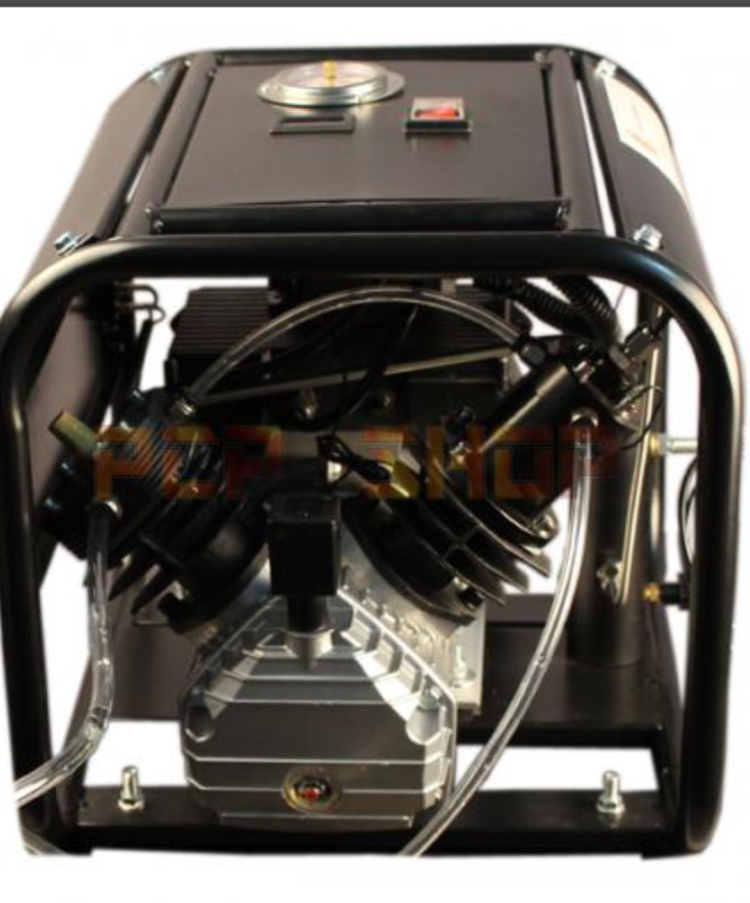

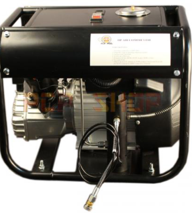

The Nomad-family box is ~350$ which is available locally, and it’s a Chinese clone possibly (I guess Nomad was also Made in China!?!)
A double cylinder Yong Heng like machine with water cooling option (external) is however around 500$ here (also available locally).
The packaging looks like Hill EC300 from Andy’s Video, and sturdy with proper Condenser and other necessary parts.
It weighs around 27Kg and appears to be a sturdy build.
I’m adding snaps for You to see, and demo videos that they have made (sorry for this guy, he didn’t have a partner for other angles)
The not so durable look and feel of the Nomad-like box + thought of weak parts inside, and only a 150$ difference is pushing me to side for the Yong-Heng like machine.
would You mind moving through the video? maybe You might figure out some features/cons of the product that i might have missed?

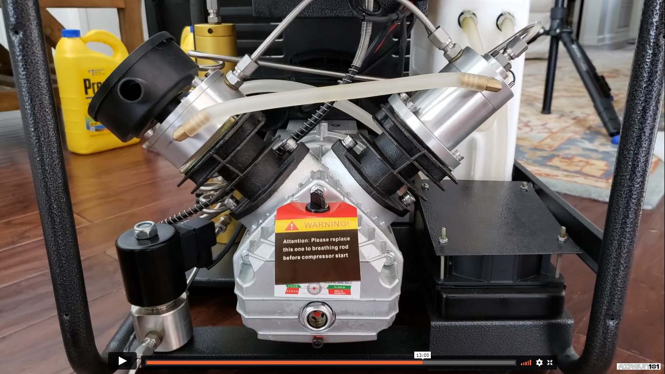

Searching and moving through multiple video reviews across GTA, Youtube, Airgun101 and here, i bumped Steve's Video on Hatsan AirTact.
And it reminded me of the double-cylinder option that's available here (snap below), the Crank Case and Cylinder Head Bolts look all the same.
At the same time, the AirTact casing has Chinese scripts of whatever it reads, so i'm assuming this option is something i'd go for... Though what's available here hasn't got the digital Controls on Purging, Auto-Thermal Cut-Off, it's got the mechanical Pressure Setting knob that'll take care of the filling.
The Thermal cut-off, i can build myself into it.
The AirTact looks like to be a Better Build and equipped Version of what's available here...
What Ya'll say? it's a 150$ difference between the Table-Top Box and the heavier built one...
