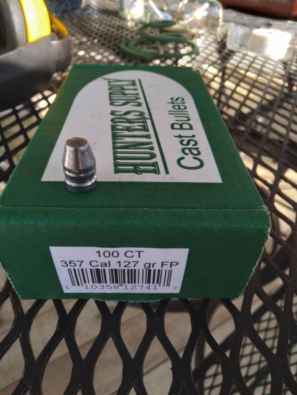

Got the slug out, dry fires fine but still doesn't shoot the slugs. I guess I am going to order some different ammo and see what happens. Here's what I am using
