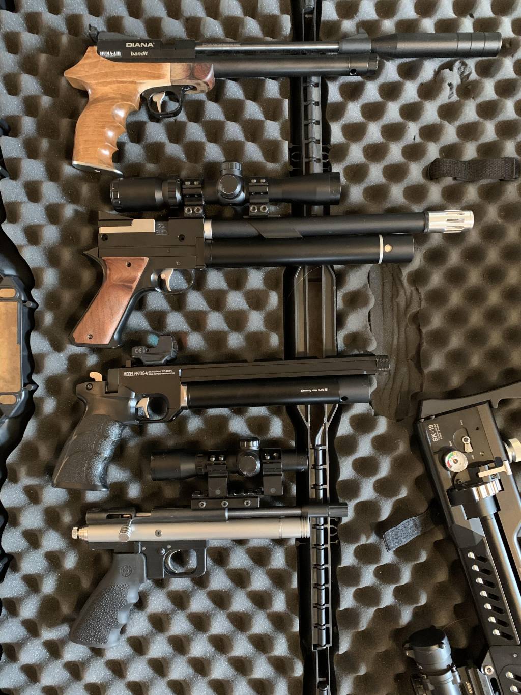

Top is .177, bottom is .25.... The .25 does not come with a mag. The receiver is not machined to accept one either.
