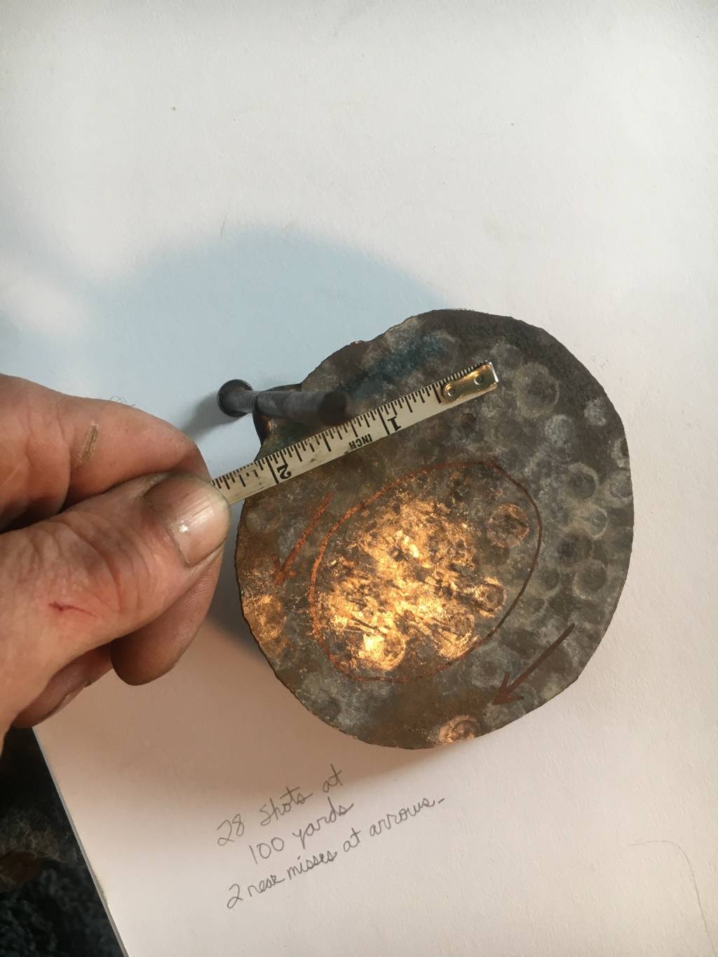

If you can do the extra money for the FX you will have superb accuracy and many shots. I recommend the Crown in .30 cal. Here’s 28 shots at 100 yards with the JSB 44.75 pellet. And you can still bust starlings lol. With all the new guns coming out you can find a good deal on a used Crown.
