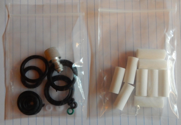

The pump did take a little work to figure out. The Chinese instruction manual was worthless. I found an on line video that helped me get the pump assembled. There were some bagged up accessories that I don't know what their for though. I have some pictures I downloaded on Google Drive that I wanted to attach, but I don't understand how to do it.

The last picture of items in bags are what came with the pump. If anyone can identify these for me I'd appreciate it.
