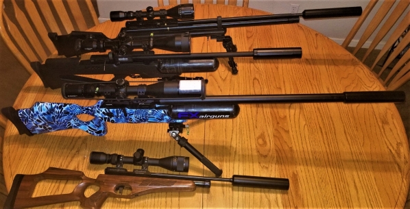

Here are some of the silencers. I don't have pictures of them all.

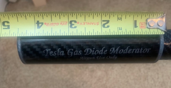

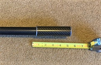

That 'Tesla diode' is 5" if I am reading the tape measure correctly, which isn't that short, pretty standard size for a LDC..the one I run is 3.75" retracted and around 6" extended...HUGE difference of sound signature AND decibel between the two lengths, night and day. When retracted my LDC @ 3.75" has a sound level half way between a properly moderated air rifle and one without any moderator. I'd love for a decibel reading from a phone comparing the Tesla to a comparable 5-6" LDC :)

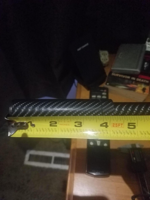

3.75" LDC. Reduces signature 2.5-3 DB compared to no ldc. Internals = 6 conical baffles welded in to keep maximum volume between baffle = tube OD. Greatly changes signature
*I tested multiple variations of baffle spacing / quantity at this 3.75" length and for me 6 spaced slightly less than the stock marauder seemed to work best*
Extended = 6.5" reduces signature roughly 5-6 DB total (+2.5-3 from retracted), no internal baffle added only volume in front of existing baffles. Further reduces sound signature.
