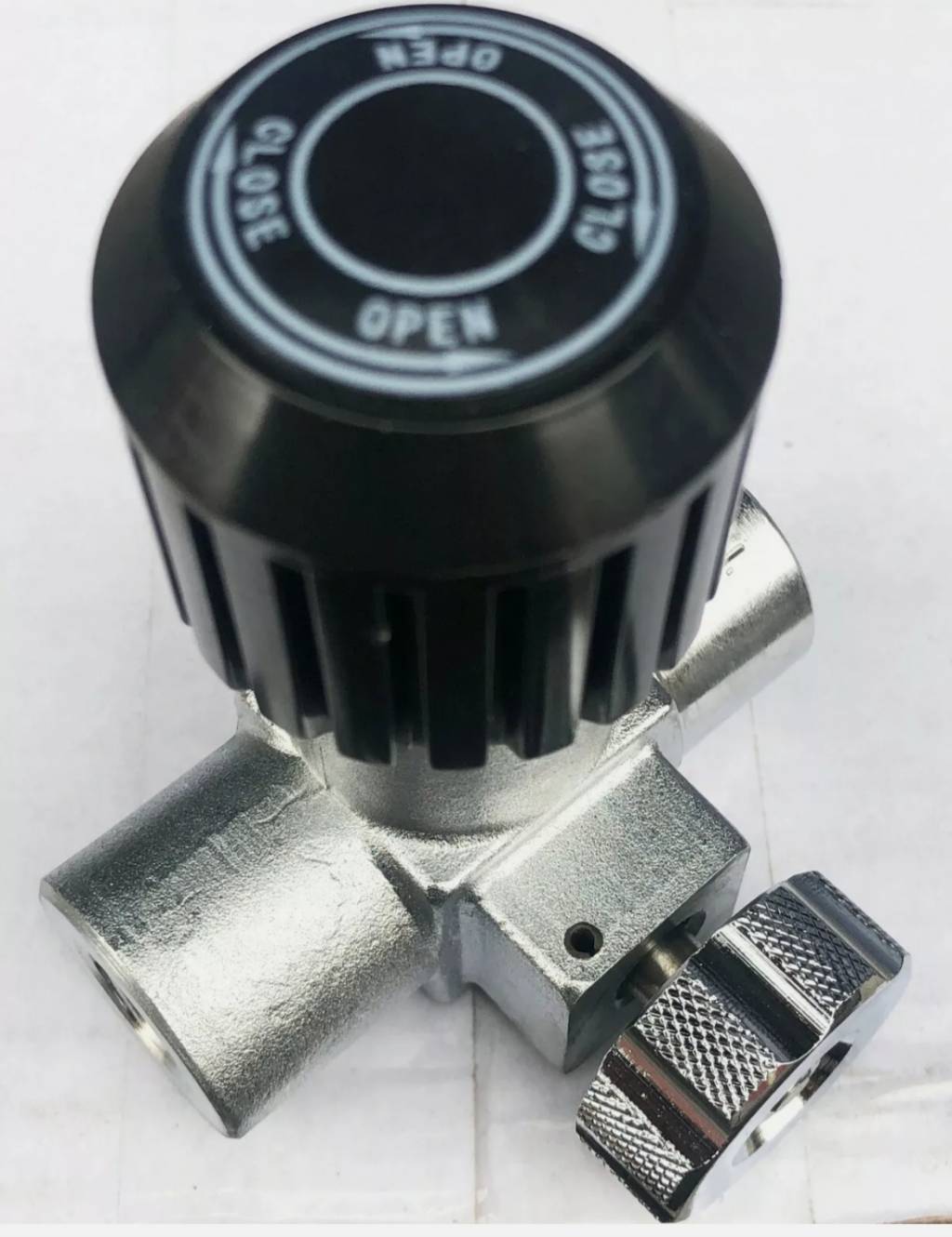

And one of these a oxygen valves rated to 6000psi after the filter to seal the system and be able to also to bleed the gun side down for disconnect and keep the filter pressurized so you dont have to keep refilling the giant filter.
