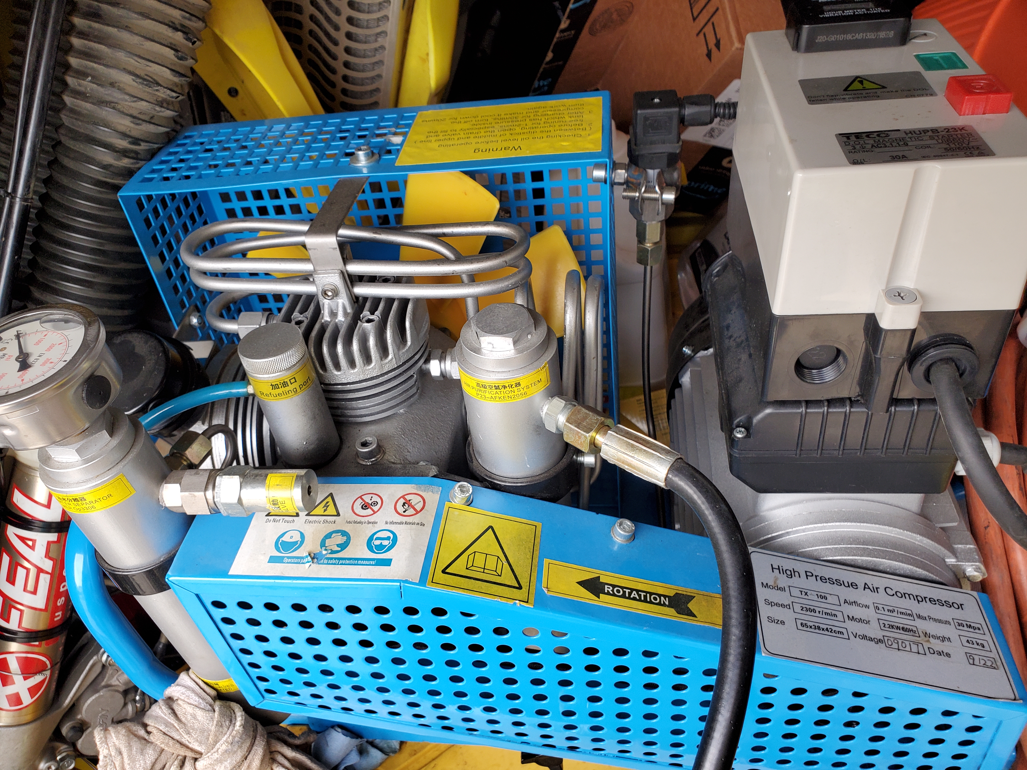

A legitimate dive compressor like a Coltri or a Bauer I got a 4 cylinder tuxing Coltri clone for about 1400 shipped after the mandatory air freight and won't look back from 1 L a min.If you had 3,000 to spend on a compressor what would be your top choice. I am looking at Hill or the Daystate?
Wow. That’s great. So a Coltri clone? Who makes those?A legitimate dive compressor like a Coltri or a Bauer I got a 4 cylinder tuxing Coltri clone for about 1400 shipped after the mandatory air freight and won't look back from 1 L a min.

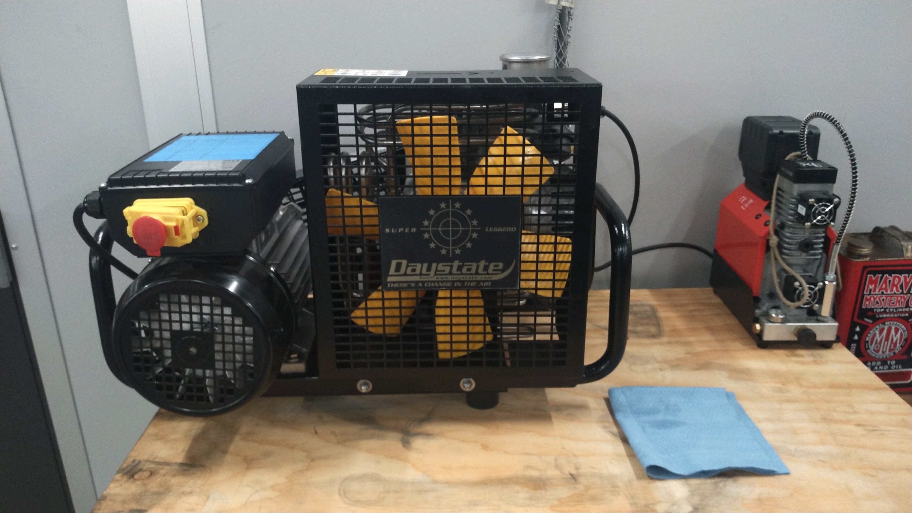

My intent is to have a high qaulity HP compressor that will last a long time so I can continue to enjoy my Airguns for the future. I have some great guns and want to keep them filled with quality air without having to worry about my compressor breaking and leaving me stranded trying to find a dive shop.Comparing the 2 you mention. There is No comparison. Daystate, it's an MCH-3. A real scba compressor configured and marketed to Airgunners. That is the least expensive breathing air compressor that can hit our pressure. Everything else below that price point are airgun compressors with varying quality. I'm very happy with my GX series compressors (cs4 and gx5). I also have a shop and can do the repairs myself, although I'm likely to get the Daystate if I have to repair GX5, rather than spending my time fixing it. It also depends on your intent.

It looks like he Daystate is a Coltri but marketed for air gunners? Same look and design. Different name.Wow. That’s great. So a Coltri clone? Who makes those?
I have set up buddy bottles and a regulator to use in my line of work and go thru a lot of air running nail guns off my hpa collection. I've amassed 17 problem free hours of run time thus far and it came with a while ring kit and reeds. The only gripe I have is what the lra current draw is for their electrical rating. Do not buy a 115 v electric. Do 220v or gas if you don't want to have a dedicated 30a+ circuit.Wow. That’s great. So a Coltri clone? Who makes those?

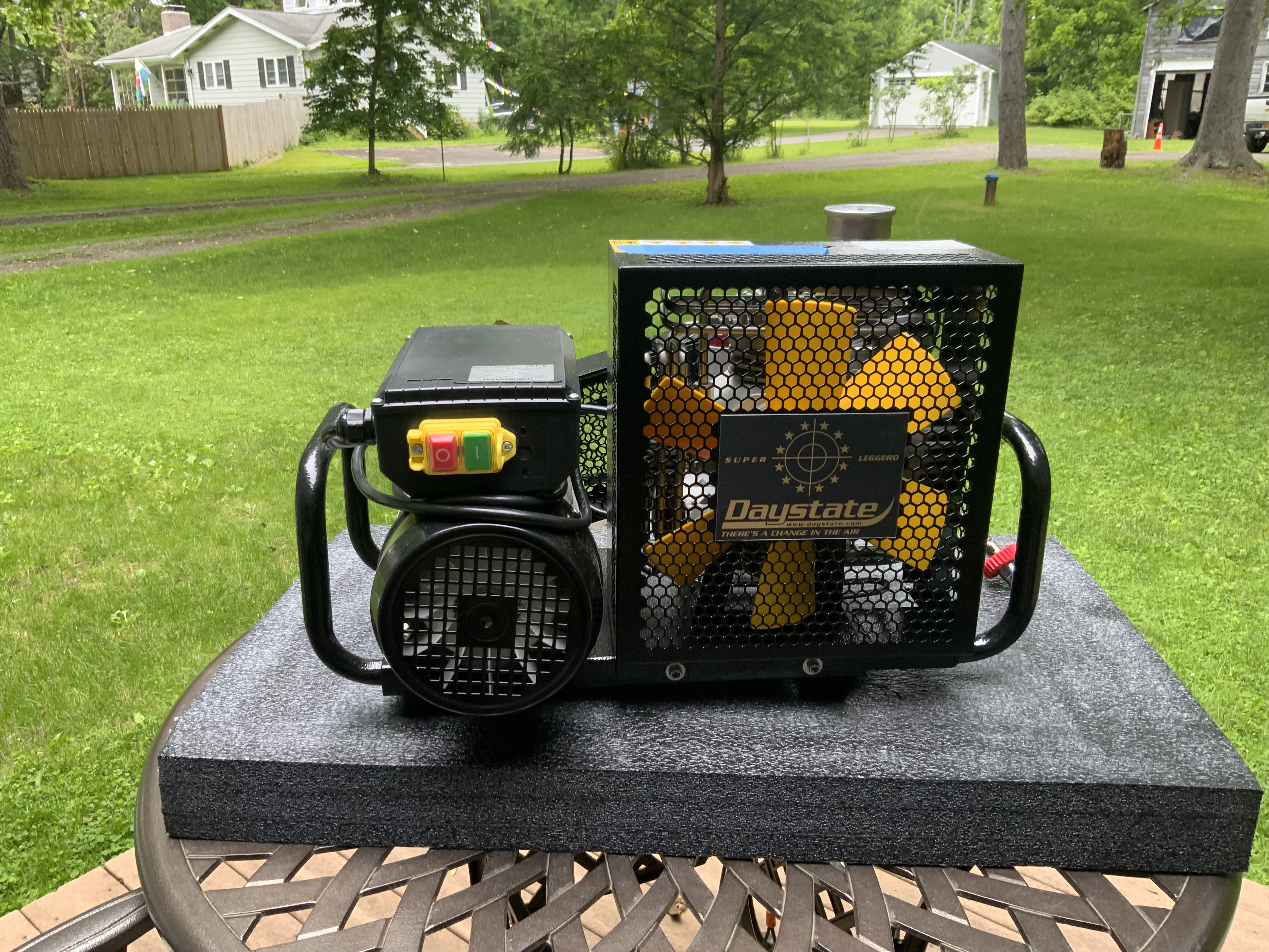

Daystate for me this is the one I purchased. Can run off of any outlet in my home.If you had 3,000 to spend on a compressor what would be your top choice. I am looking at Hill or the Daystate?
I have one and it's great. However the only repair option is do it yourself. The Daystate can be repaired at any Scuba Compressor repair shop. Nuvair sells and services the mch-3 and mch-6.Gx pump e5k2
That's a legitimate one too and looks really nice. I can put a soft start or a different motor on mine to fix the issue. They claimed 2.2kw draw, i put the fluke clamp on mine and saw it spikes at 80 amps for a millisecond on intial locked rotor startup(high but not unusual). I just ran a dedicated outlet in my garage and solved it. I haven't even bothered to pull the covers off the motor to see if i can rewire the chinesium to 220v...i have spare motorsDaystate for me this is the one I purchased. Can run off of any outlet in my home.
