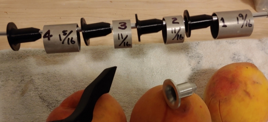

I just took mine apart to clean the barrel. Here is exactly what I have inside my shroud. I used 1 piece of PVC, 2 of those baffles and a "flat" baffle last, then the end cap.
I printed these at the library and pretty sure they are just PLA. This is how they are holding up between 30-40fpe.
