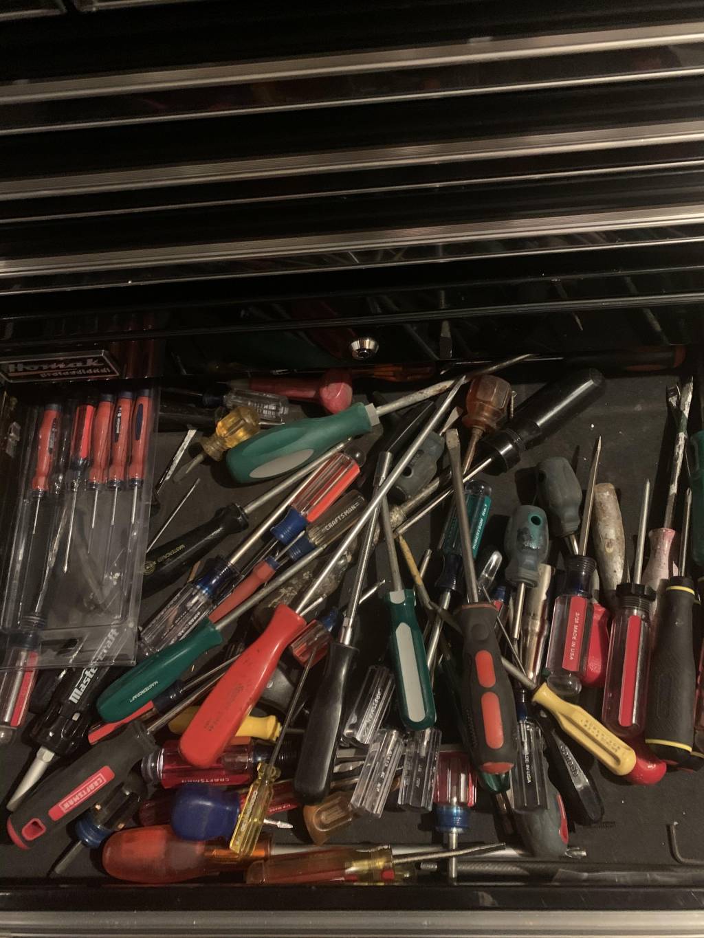

There’s nothing more aggravating than having 200 screwdrivers and it’s still not satisfactory.

There is not a perfect "set". If it is flat head none of the common wedge ground tips like most in your photo are satisfactory. Get hollow ground tips and be prepared to custom grind to a perfect fit. Brownells has a good set. Phillips- buy the best steel you can get and use the right size. I have had good luck with Klein. Airguns use a lot of Allen head screws. Get top quality steel. I am still using good old made in USA Allen wrenches inherited from my dad without ever regrinding them after 50 years. Most frequently I use on on air guns are Allen head drivers for RC toys that have high quality replaceable bits with good longevity. If you are working on guns all day long you will grow tired of exchanging bits on universal drivers but don't discount a good set like from Midway for the hobbyist. I seldom have need for magnetic tip either, although when the real need arises I use them.
Once every couple years I go thru and throw away those old screw drivers. Keeping worn out tools just leads to trouble. Buggered up screws or worse. The gun smith screw drivers kits are nice but I’m not a fan of magnetic bit replacements although I use them. If I did more of it I’d get individual screw drivers for at least the common sized screws. One thing I have learned is use the right sized screw driver and make certain it’s the exact fit not close exact
Yes. Buy the best quality you can find. If you use a worn screw driver on a tight screw your going to strip the screw head and then a good quality screw driver will probably not work or if it does it will likely damage the screw more. No excuse for having worn out screw drivers. Not that much money and it saves easy jobs from becoming hard ones.

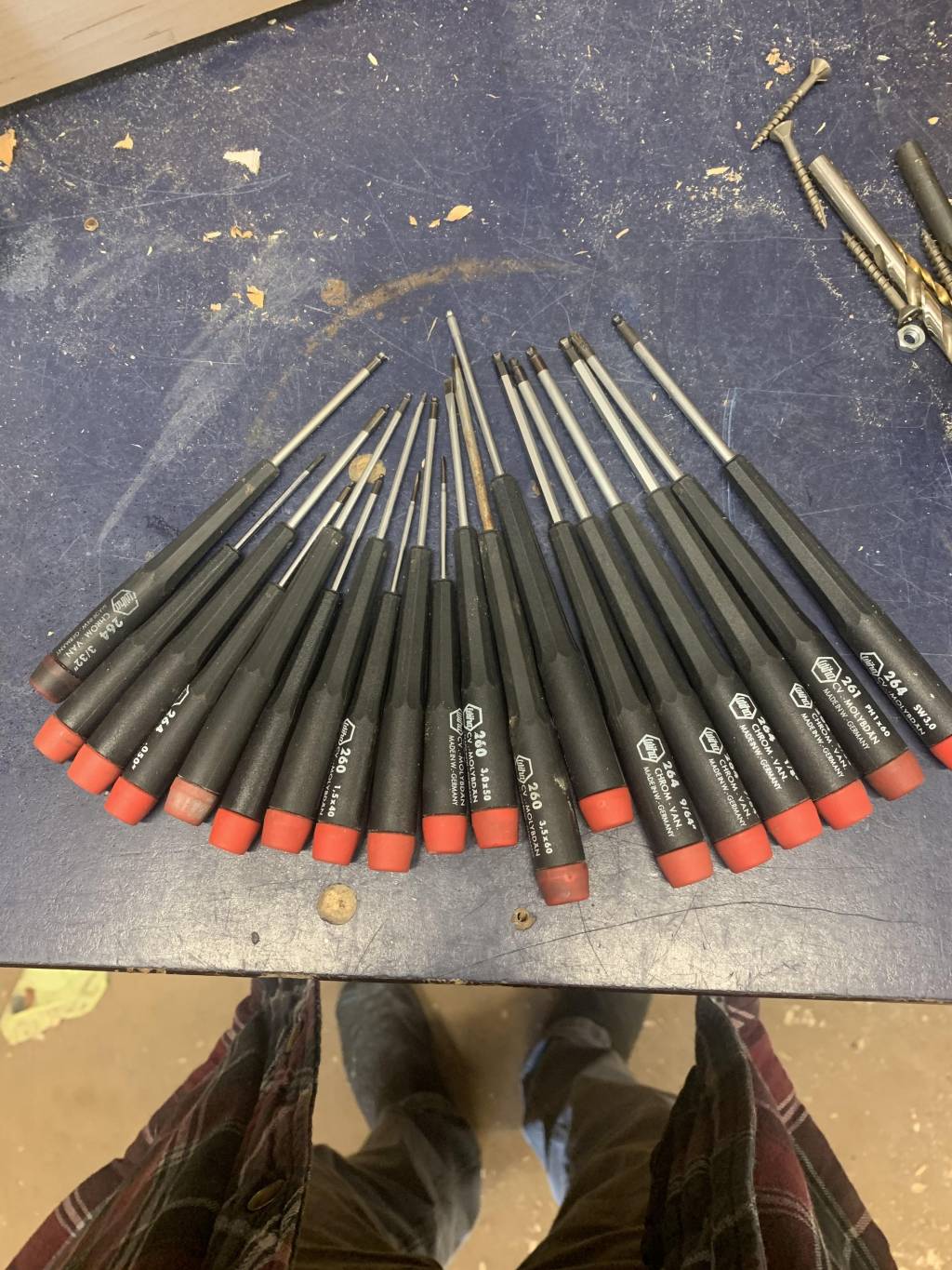

Will those small Allen head drivers fit internal parts of the air guns?
 These are them, look too small to me. I have never had a springer apart so I don’t know. Those are number 8 inch and a quarter wood screws nearby. 32 yrs. old. Probably that long since I used them. I will check Brownells. I started writing this nine hours ago. Thanks for the tips. Crow

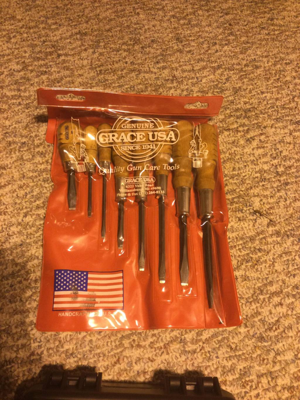

What I like about this set is how little room it takes up, I can grab the small box and take to a table without taking up a lot of room. The Grace screwdrivers are top notch, but a set that would come close to matching the replaceable bit set would probably take o 2 foot or maybe larger area to store so you could see and access quickly. plus being much more expensive, I would love to have a large set but cannot justify the expense or space for them.

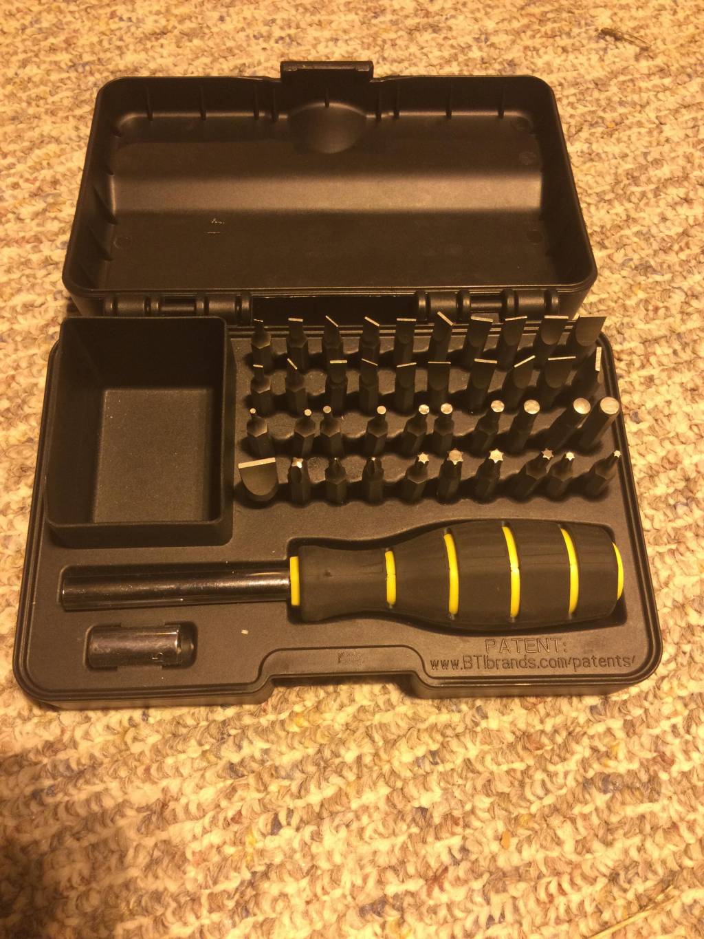

this is the set I have, 58 bits. My long handle has a collet, this one is magnetic, I do not think they offer the collet handle any longer. I have probably had this set over 20 years now.

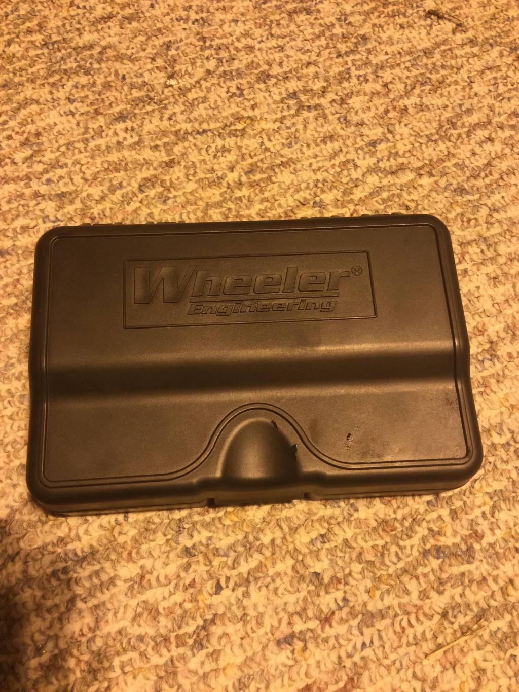

So I bought the biggest Brownell's set years ago. I use it the most and am very happy with it. It was the obvious choice at the time, but there's a lot of other nice sets out there today - Wheeler has a top reputation, and there's others under the Grace, Lyman, Weaver, Winchester, and probably other names.
