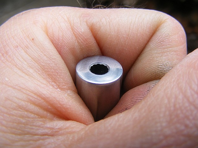

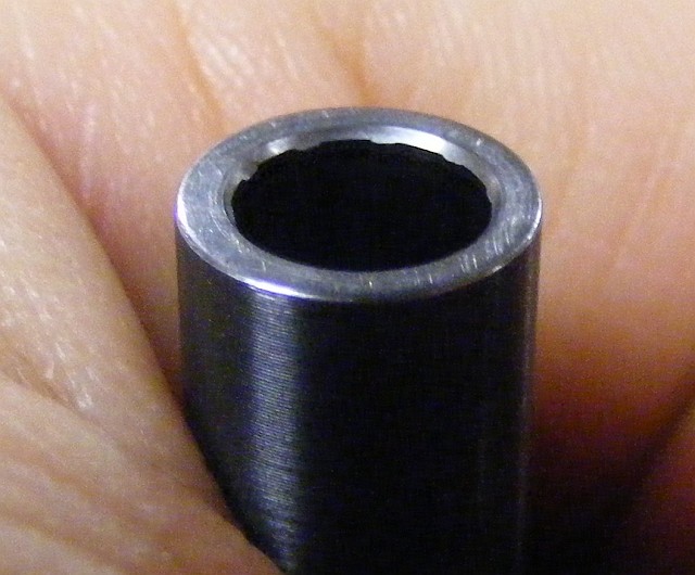

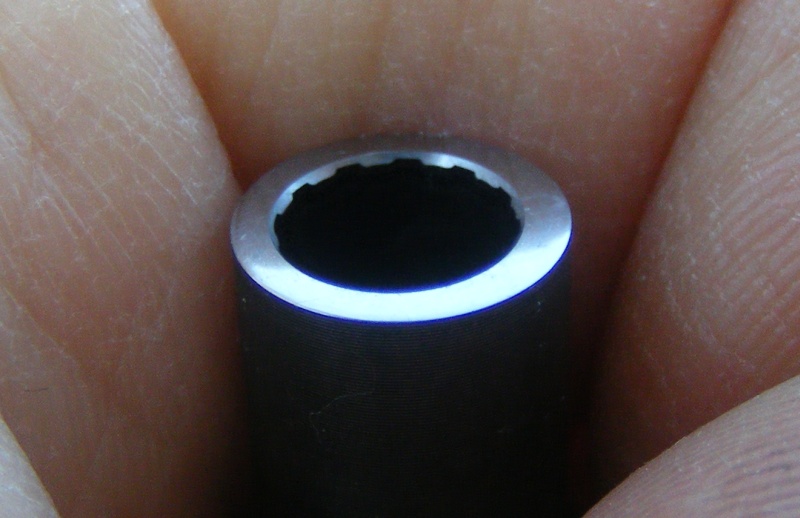

(Part 2) Does this barrel crown look ok to you?

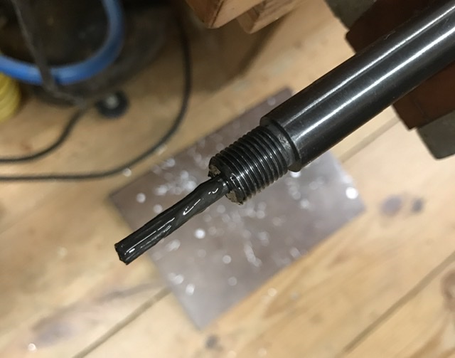

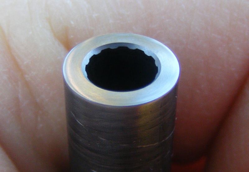

well,the barrel went from this.......

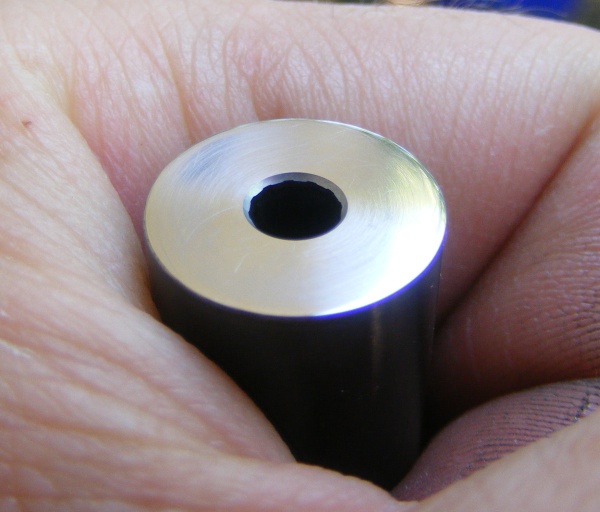

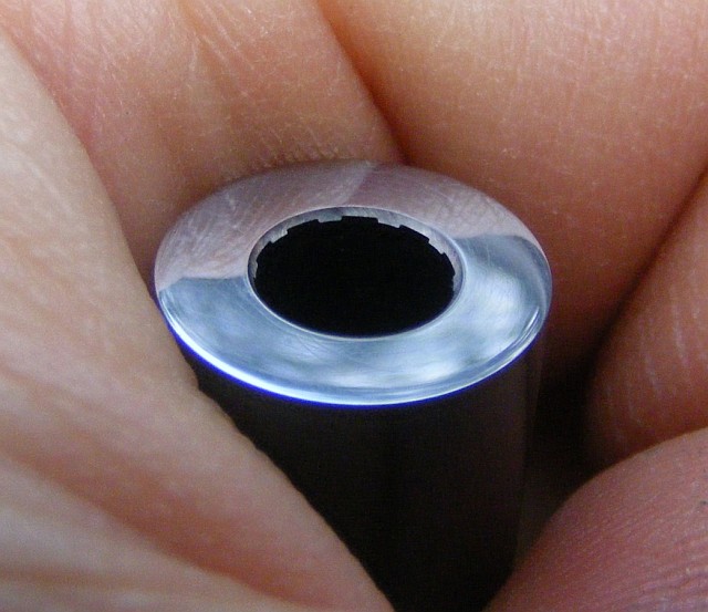

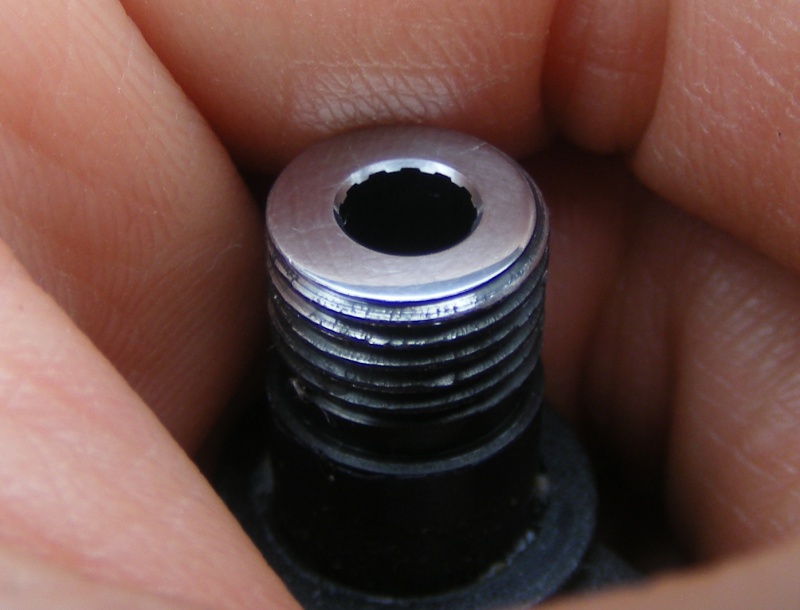

It’s a recipient of the head-to-toe treatment so it will be interesting to see how it fares.

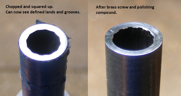

1. Deburred barrel port.
2. Poured a cast lap and worked the bore into uniformity.
3. Smoothed the leade and transition into the rifling.
4. Chopped off the bad portion. Faced off in the lathe.
5. Lightly polished the bore with J-B (already smoothed by lapping).
6. Crowned.

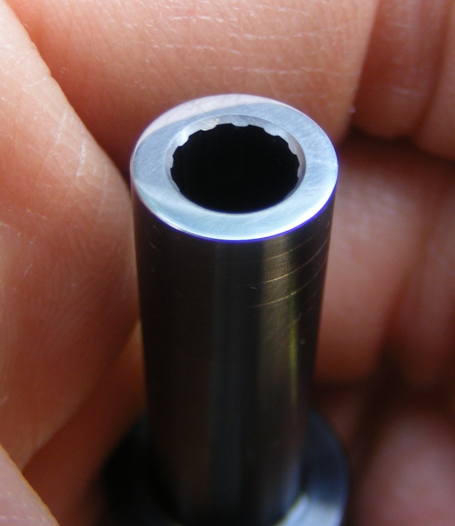

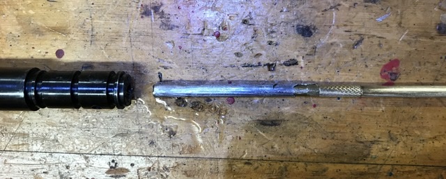

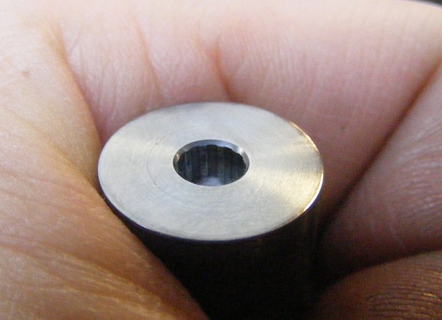

A couple pictures of the cast lap:

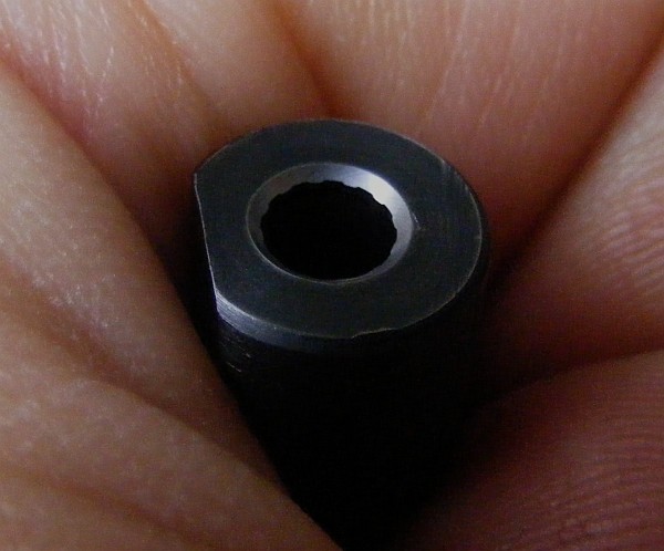

6. Crowned.View attachment 295435View attachment 295436
Just curious if you polished it with JB, what did you use to do the lapping with?
wow, all i have ever used on cleaning up a crown (.22) or rebuilding one,
is a 4" long 10/32 screw (from a toggle bolt) with an acorn nut on the threaded end snugged down.
then apply napa's valve lapping compound to the head of the acorn nut and start dress'n up the exit hole.......
different calibers require different screw and nut sizes :sneaky:

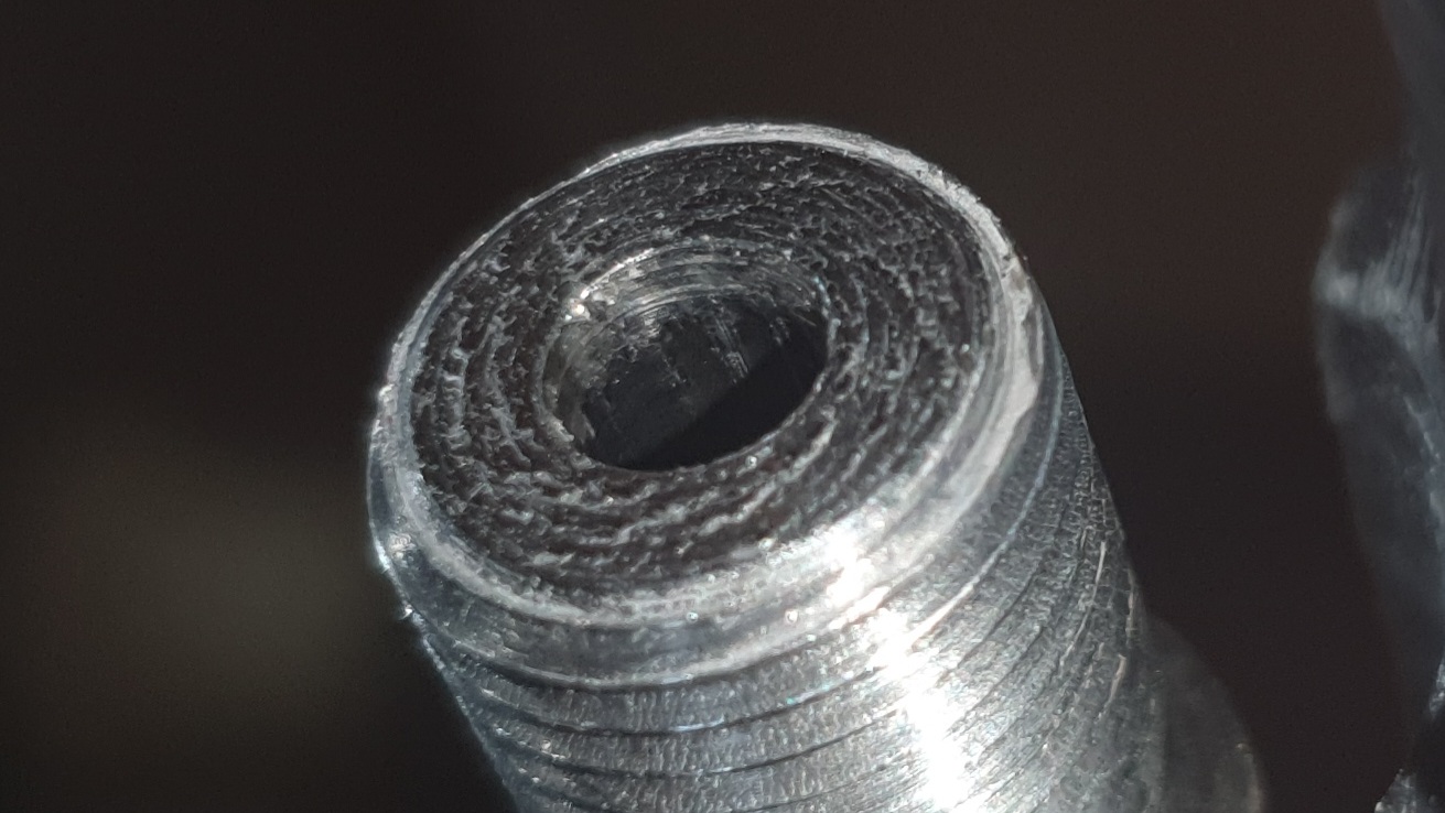

The dial indicator showed the bore about 14 thousandths out of concentricity with the OD. It looks more significant due to the muzzle threading.
