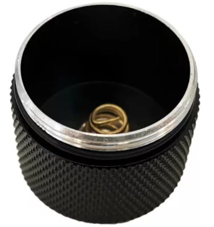

I have a Pard NV008S arriving soon. In reading through the documentation that I could find it will only take a 16850 flat top battery. These are non protected batteries and as it turns out protected versions are longer and will not fit. I just ran across an extended battery compartment cap:
These caps will allow the use of protected versions of the 18650 battery. I'm curious if anyone has one or tried them out, looking for feedback.

Pard has a USA authorized store. I found two references for the extended cap, one in UK and the other in NL if I remember correctly. One mentioned that the new units may come with an extended cap. As soon as I can I'll let everyone know once it arrives.

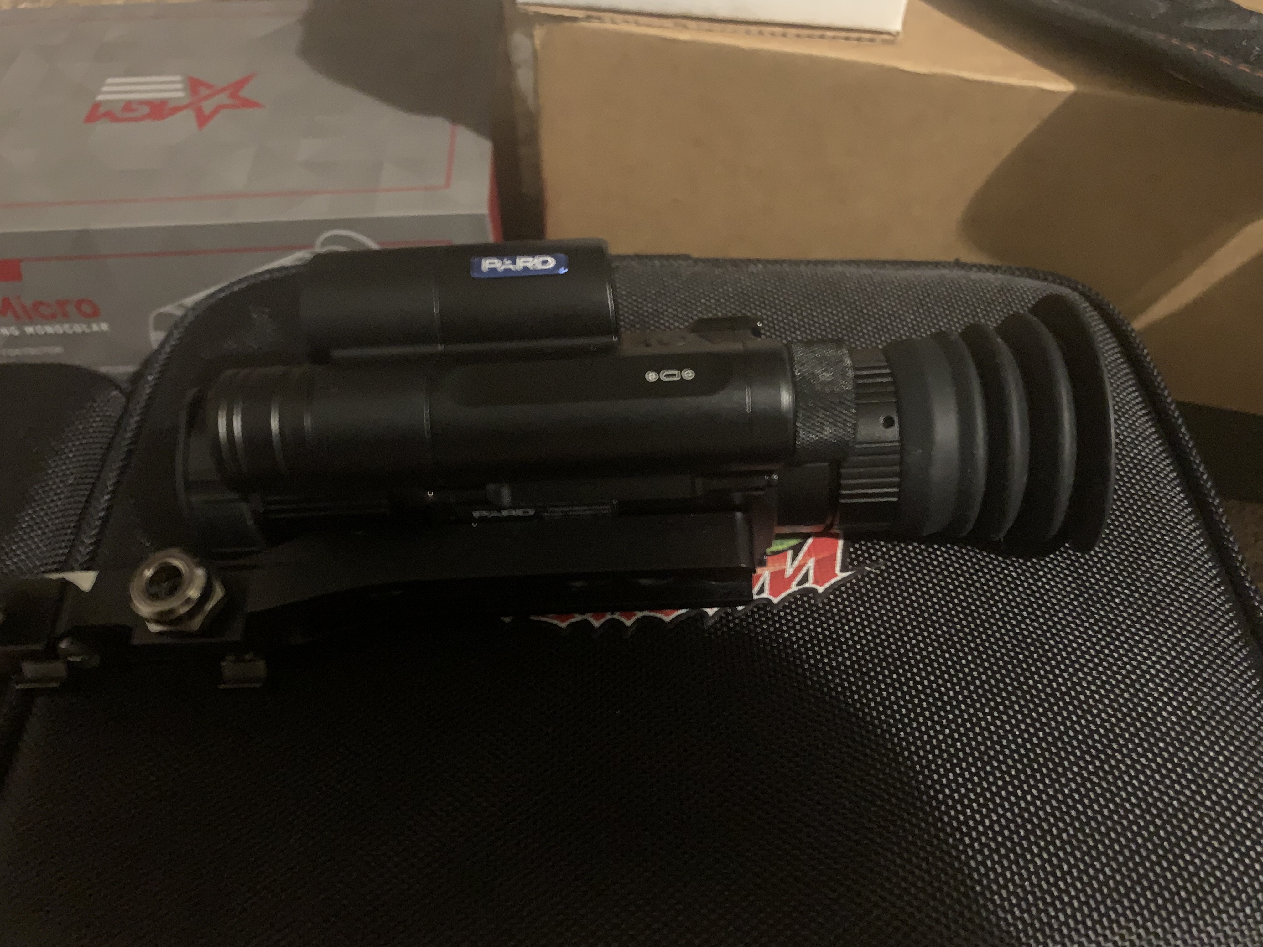

Well, I received my Pard NV008S LRF today. It came with a Pard flat top battery but nothing in the documentation as to it being able to take a protected 18650 battery. If you have a NV008P can you measure the battery cap so I can see if this one on the NV008S is any deeper.
I have to say, it's going to take a little time to get used to all the options/setting this thing has. First impression is I LIKE IT!
So I took some measurements this morning. One of the things I noticed is that the battery cap on my NV008S has a step that hits the outer edge of the battery and keeps the spring from being totally collapsed and possibly damaged. It measured 0.378" or 9.60mm from the edge of the cap to the step. With the flat top battery resting on the inside "+" end of the battery 0.328" or 8.32mm sticks out of the housing.

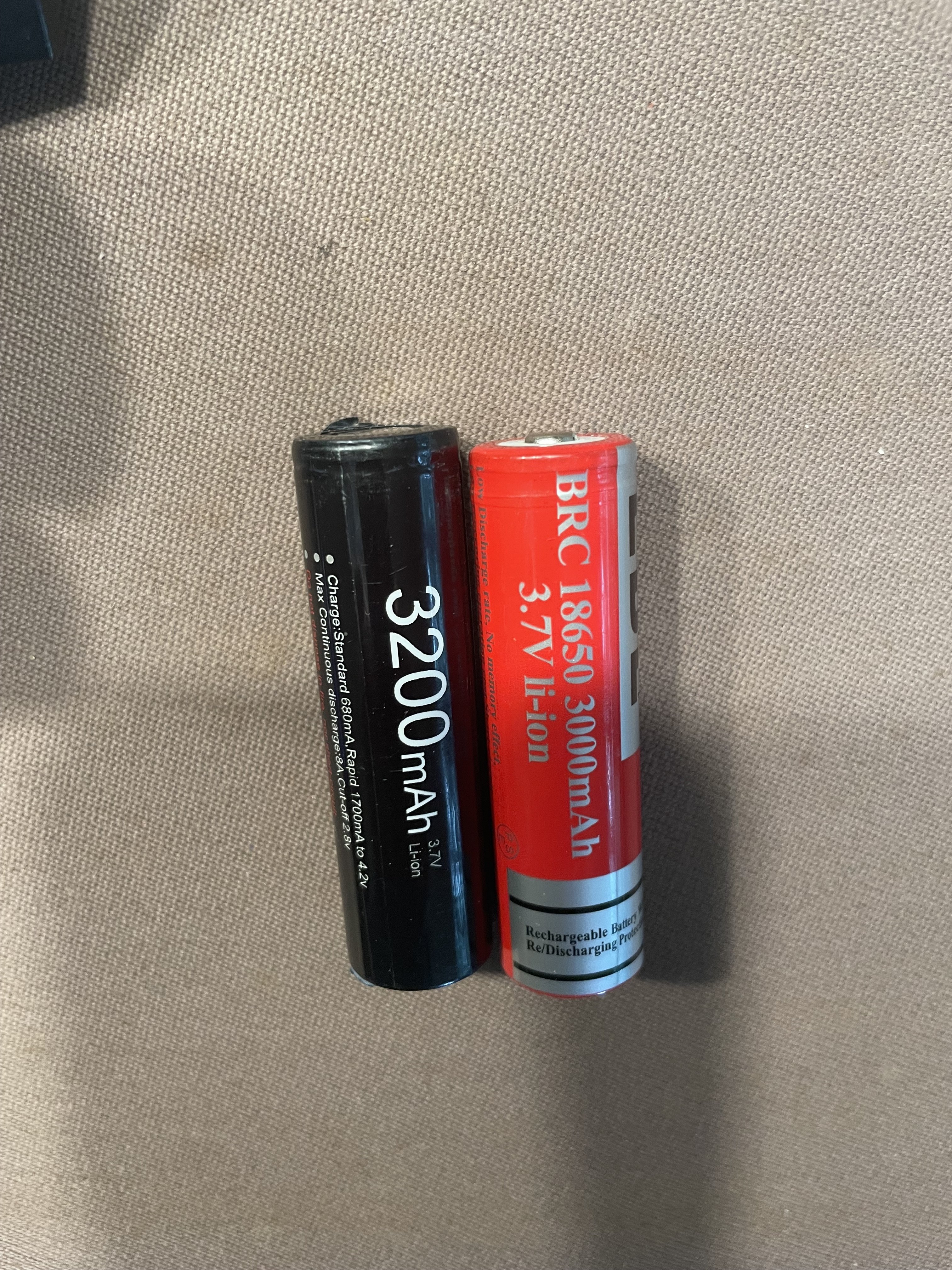

@Reedmosser Thanks. I have found a site, it's just the different maximum charging currents, discharging currents, voltages, "Wh" (which I assume means "watt hours"), and some more stuff. The manufacturer (Pard) left us hanging out to dry on the details. It's a little confusing. I don't want to fry my unit and i cant find any protected 18650 flat-top batteries, but I need more. In a pinch I swapped baterries between a torch and my Pard 3400 to 3200mAh. I figured there was enough juice to light my way back to the road and it worked out. I guess they don't make protected flat-tops.

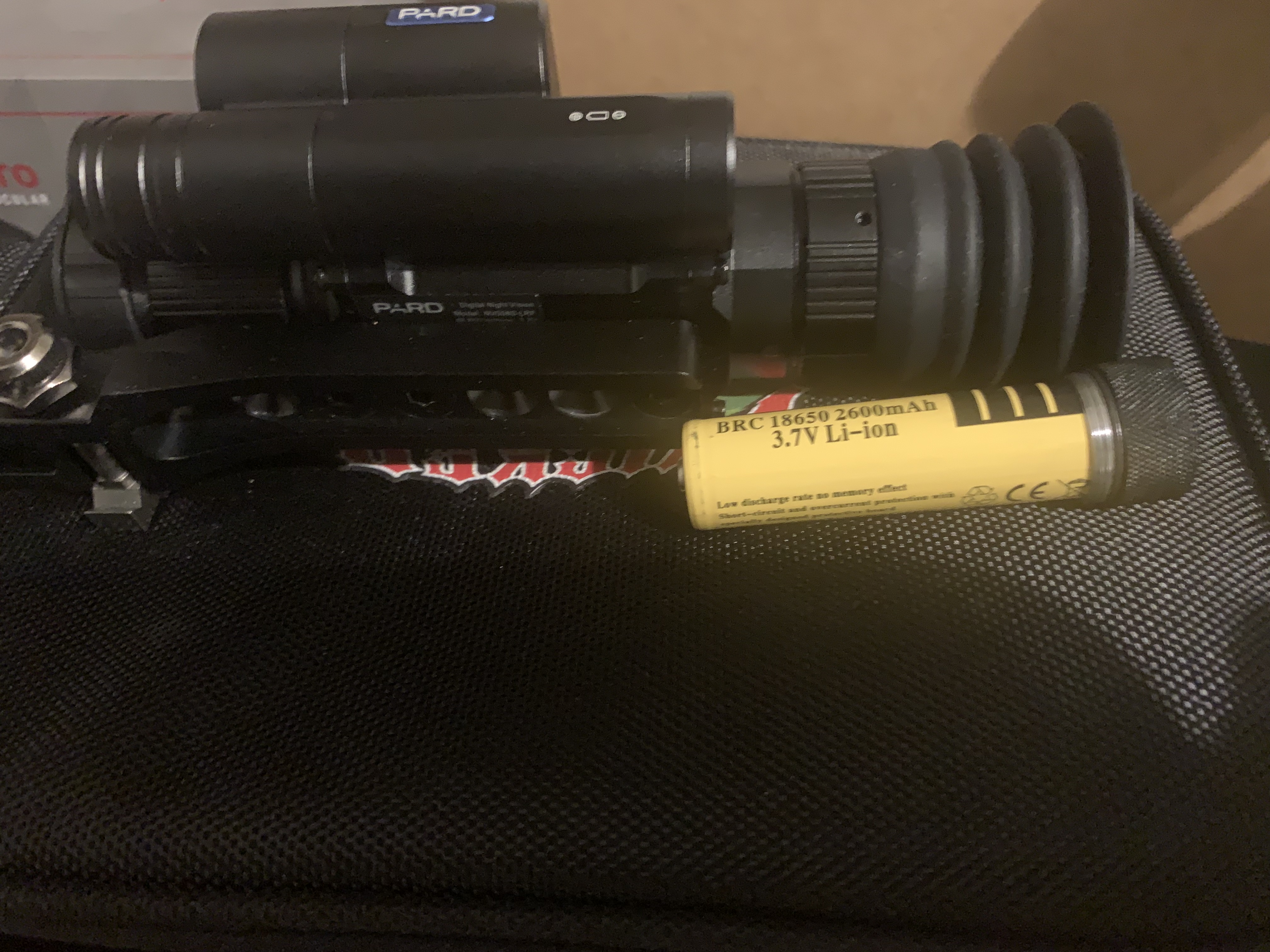

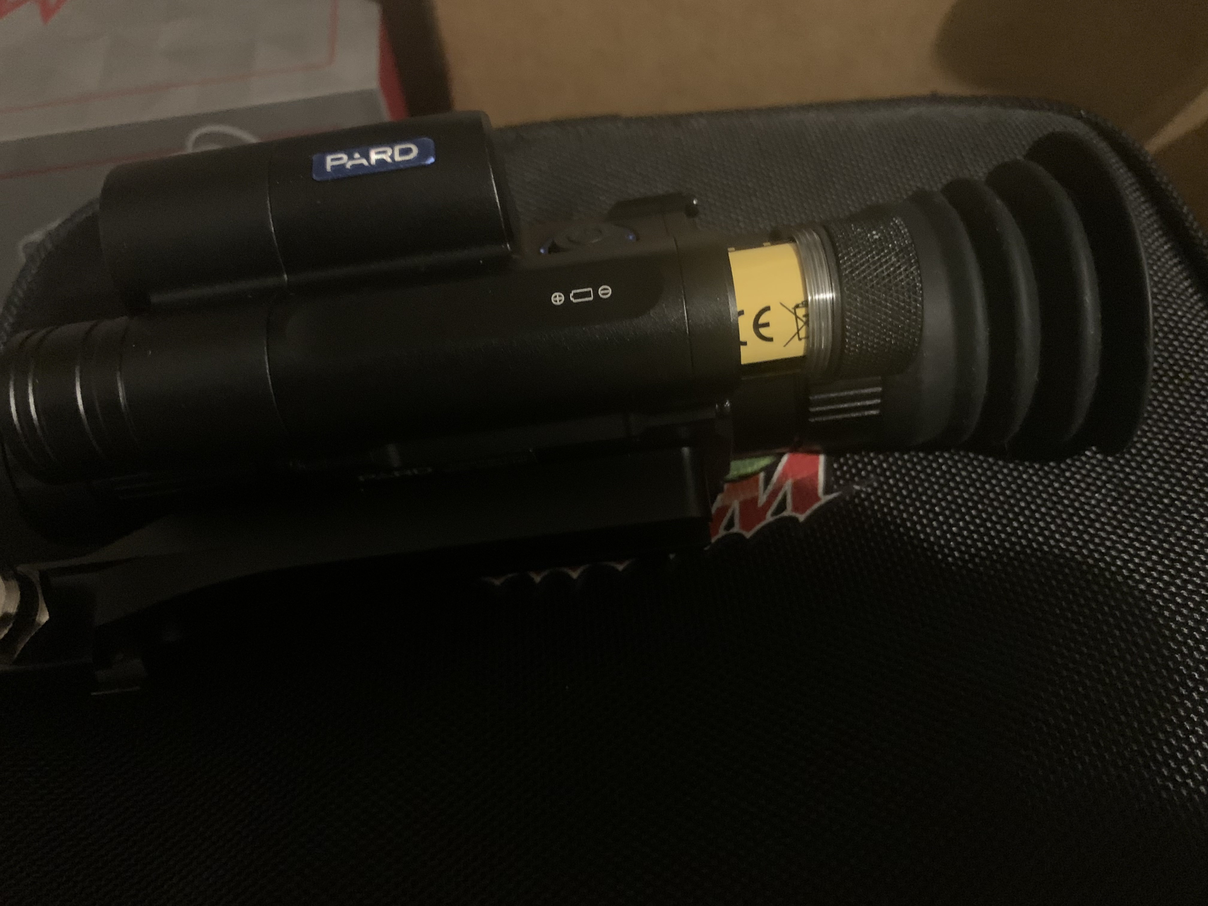

@B_y_r_o_n Good news. I got a button-top 18650 battery to fit and power on my NV008s. I didn’t measure anything I just stuck it in and screwed on the cap. Then I powered it off and removed the battery as it was a flashlight battery that I was going to use. The spring felt like it collapsed to me. As I screwed it down it got tight, but didn’t leave a noticeable gap revealing any threads.
