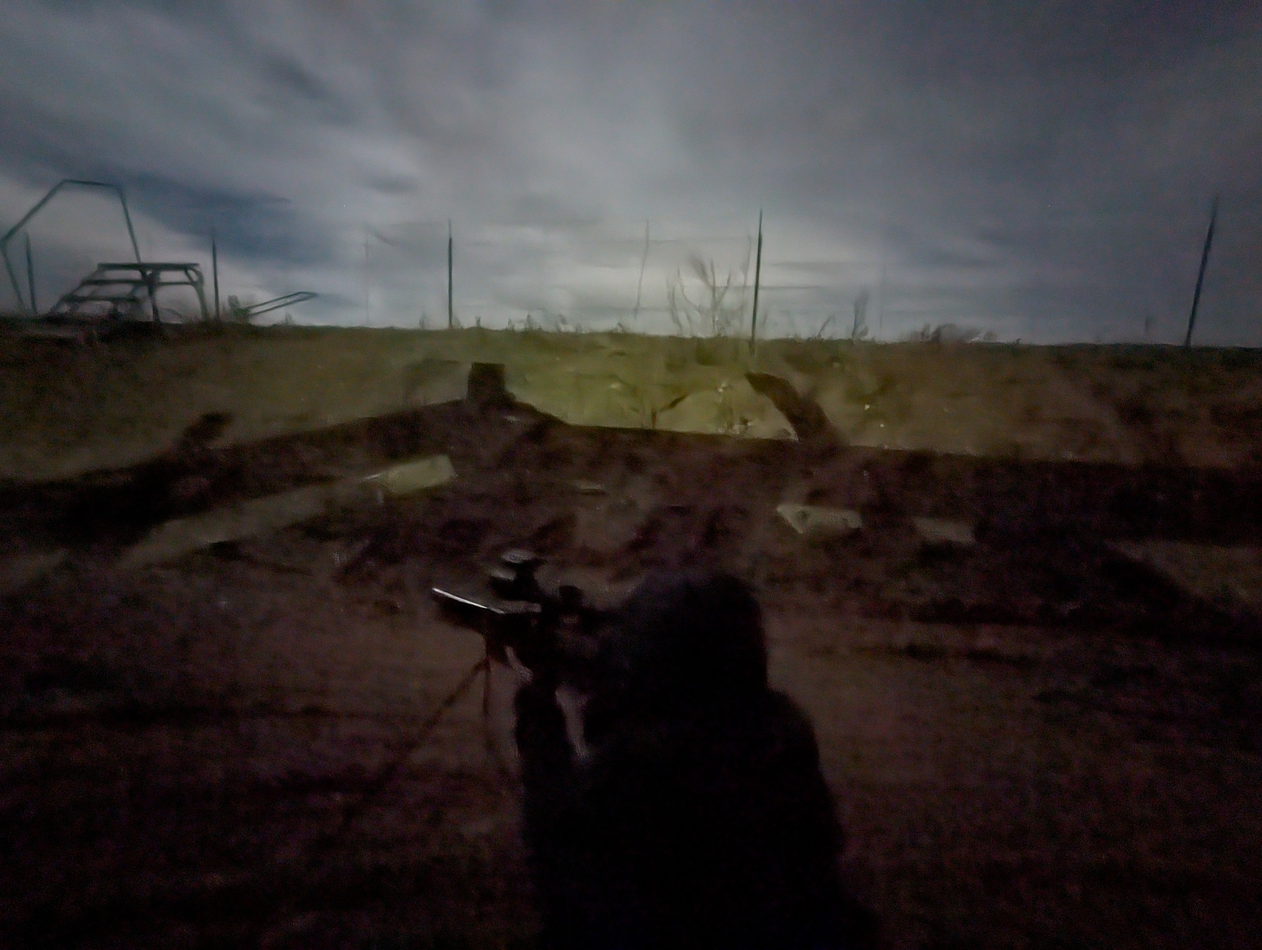

Me and the older son spent about 90 minutes at the extended family feedlots and barns after dark on Saturday. They've got a big grain silo that always has a bit of leakage around the base. They also have silage pits with corn as one of the ingredients. I fully expected some rats or mice to be lurking around but we saw exactly zero of them in the 90 minutes. We took turns scanning likely areas. Other than a bunch of cows, we saw one cottontail, and one barn cat (perhaps why no mice/rats). Here is the oldest on one of his turns scanning.

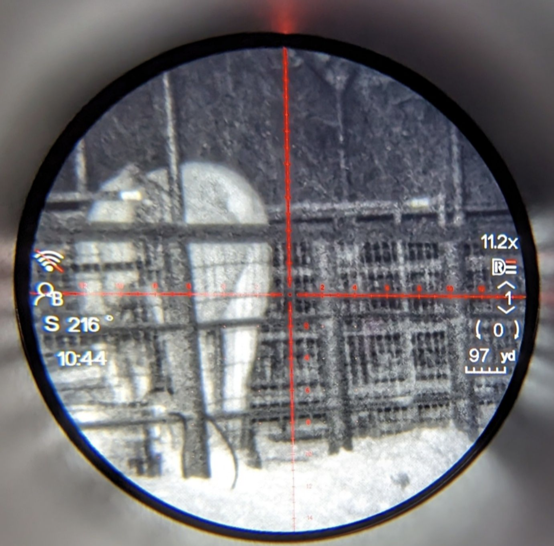

This PARD is pretty feature rich. It is an electronic day and night scope with a built in laser rangefinder, built in IR illuminator (making it night vision capable), and built in wifi (free app on GooglePlay store and I assume Apple whatever). The wifi+app allows what the shooter is seeing to be "cast" to another device (phone or tv or etc). There are 6 different reticle options, two are comparable to reticles we'd find in popular traditional style (glass lenses) scopes used by many of us these days. There are also 4 different color options (not reticle but entire scope view) to play with to see what works best for the each intended use.
The version I have has two magnifications, 5.6x or 11.2x. Which is maybe the biggest downfall I've found so far, after being used to 16x or 24X from traditional scopes for a lot of my target shooting use. The images seen when looking "through" the scope are electronically rendered, somewhat like looking at the screen on a digital camera. My oldest said it looks like VR to him. And the scope itself actually can't be looked "through" like a traditional scope. In fact, the battery goes through what would normally be the horizontal adjustment turret on a traditional scope, physically blocking the "through."
There is a "picture in picture" option in the settings that creates exactly what it sounds like in the upper margins of the scope view. Specs say the PIP option is 2x, and it "seems" like that PIP image is perhaps 22.4x? For some reason the PIP option isn't captured when recording though. Which gets me to the next point, the scope is also capable of recording video. When told to do so, it captures video in 3 minute clips. Dunno why it partitions them that way, but it does. Ie, if recording for 5 minutes straight, it will show up on the memory card as two files, one 3minutes and the other 2 minutes. It uses a TF card (128gb). I bought a two pack of the memory cards on Amazon for $15-20.
Many other features.... tells you which directions you're shooting, the angle of the shot, etc. The symbol for the hold-over indicator can be changed to suit preferences. It can hold a ballistic profile for 5 different set-ups (various pellets/slugs/zero distances/etc). Cycling through all the various settings and figuring out all the capabilities is borderline overwhelming.

Night Vision
PARD advertises the IR illuminator as capable of 350meters. I've gone as far as the heron nests in the tops of the cottonwood trees down the creek from my house. They're at about 250 yards, and I could see them bright as day in the middle of the night. My son and I had no issues scanning for critters at the feedlots on Saturday night. The cottontail and cat were immediately visible b/c of the reflection of their eyes. It is not a thermal scope, but live animals are easily seen, even at night. Here is a photo of a photo of my neighbors horse in the middle of the night @ 97 yards. (no horses were shot).

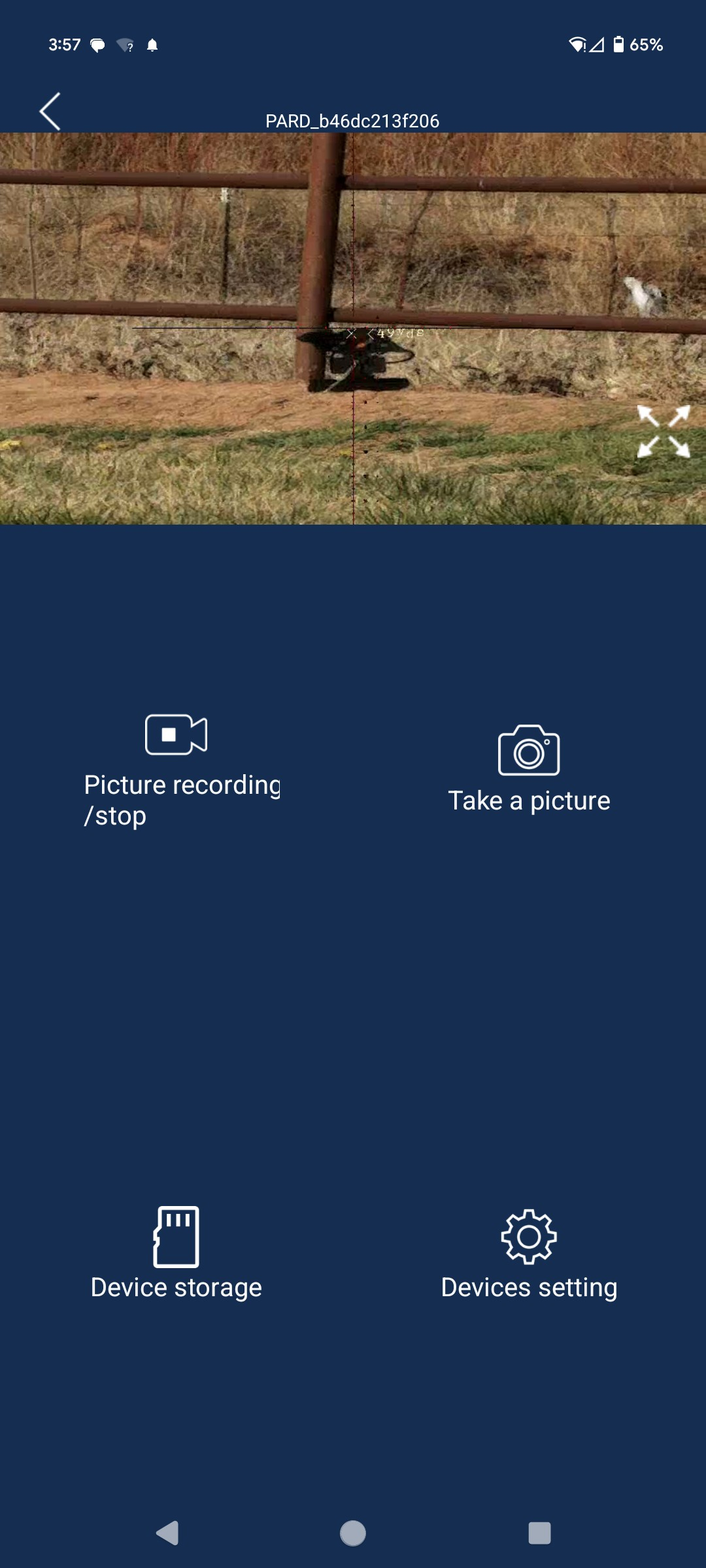

Wifi
The wifi option was extremely easy to set up and use, and proved useful when I was walking the 6 year old through how to use the scope. I downloaded the PARD app on my phone and could see on my phone what he was seeing through the scope. This helped in teaching him the "keystrokes" to get the scope to do what he needed it to do, but also provided for some instruction when he wasn't holding enough for the wind. It also showed me just how much wobble that poor little 6 year deals with in the scope from his field target position, must be due to the rifle weighing about 1/3 his body weight, lol. As far as wifi goes, we were in the backyard, so could use my home wifi. If out in the field, I think a guy would need to set up a wifi hotspot, using the phone's data plan, for this to be functional. Here is a screengrab off my phone from using the wifi+PARD app.

My biggest complaint I have is the inability to change the laser splash on the lrf. With my initial setup I could not see the splash in the scope at max zoom and it was quite far off at the lowest zoom.
There are two ways to change this; take it apart (voiding the warranty, potentially breaking it, and it also doesn't seem very easy to do) and manually fiddle with screws holding the lrf. Or get scope rings that can be adjusted. I got new rings.
It is very odd that it doesn't have the ability to adjust this. The IR lamp is easily adjustable, why not the lrf?
Overall, I like the scope. My complains are minor things, besides the lrf thing.

Does the laser rangefinder not work on yours? I'm not understanding about "not being able to see the splash." Colben and I were able to get the distance on items in the dark, pushing the rangefinder button would create a dimly flashing/pulsing/strobing effect but the distance would pop up.
Also on the lrf, it doesn't range perfectly. I know the distances in my back pasture and it ranges short.....55 actual reads as 48-49. And it only gets worse as the distance increases......I have steel paddles @ 92-93yards and they range as 78-79. I fudged the #s and have the ballistic program working for 10-55 yards, which will work for distances out to 55 yards, but does the firmware update fix misranged distancs? Or are there some settings/calibration I need to play with?
The range finder does work on mine fine. The problem was it was splashing very high. When I was zoomed in the splash was out of view and I could only see it at 4x.
As far as it not doing the correct distance; this happens to me but not like your describing. Sometimes it will show very short distances for me (like 8yards when I know it to be 30+ yards). It doesn't happen very often and shutting it off and turning it back on fixes it.
I also noticed it doesn't like fog or any other weather that may screw up the lrf. I feel this is understandable, limitations of the tech.
I'm not too sure if the update will fixes your problem, I have only taken it out to 60 yards, I don't have a range finder so I'm going off what it told me. The point of impact it was showing me worked, was hitting very close to the mark (at least as good as the pellet could likely do). I only have mine zeroed at 35 yards and 60-70 yards is likely the farthest I will shoot.
I also fudged the numbers in mine, but only the scope height numbers. My new rings has a cant so I couldn't use the real number. All my other numbers are more or less exact.
One thing to note; the farther you go out the lower the splash will hit. Make sure you are splashing your target. That box that shows up when ranging isn't always were it is hitting.
@Franklink Here is a video on how to change where the box is positioned in the scope, I don't believe how to do this is in the manual. Not sure if you have done that already. Even if you do this it will only be correct at the range you do it at, will still likely have to guess where it is at different ranges (at least during the day).
@Franklink Here is a video on how to change where the box is positioned in the scope.....
Very nice! Thank you. Figured there was a way to calibrate it but hadn't seen anything to that effect.
And yes, the scope height was what I needed to mess with to make the closest shots impact where desired. Actual scope height is around 2.75" but I had to feed it 2.25".

I really appreciate your help! I just did the firmware update and now it has the additional magnification levels. It's charging right now but I'm curious to see what else the update changes.
Per your suggestion I was also able to change the splash of the LRF to be accurate...mostly. It's good to about 95 yards now. For some reason 140 yards is still reading 95, but 10-95 are reading correctly. I'm assuming it's what you pointed out about how the LRF is pointing to a different place than the rest of the scope. And on that, to make 10-95 yards range accurately, the LRF indicator on the "screen" has to be be about halfway between the crosshair intersection and the bottom of the screen. So it's a bit strange to "range" using that lower point, than to use the crosshairs for desired impact point. Regardless, THIS I can work with, and more importantly, so can my 6 year old son.
Again, thanks to @phoenix_cow for his VERY helpful help. I appreciate it.
@Franklink
I'm glad I could help. Funny, my LRF box thing is the exact opposite of yours. My indicator is about halfway in between the crosshairs and the top. But you likely set yours for a farther range then I set mine.
Just out of curiosity; What range where you at when you configured the LRF box? I configured mine at 35yards, this is the same spot I zero at. I don't plan on shooting very far, 60 yards is about as far as I can go in my yard.
I really wish the splash on these could be adjusted like the IR light, that really is my biggest complaint for the scope.
I imagine if they had the LRF lower it wouldn't be as bad as well. As it is the splash is shooting down at an angle from where your crosshairs are, this seems to be the reason why it splashes high/low at some ranges. I really don't understand why they positioned the LRF so high on the scope.
