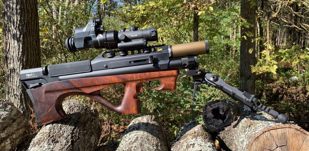

PARD 007 and EagleVision Mount on my Lelya 2.0
This is pretty slick.

Never saw those mounts before! How adjustable are they and do they mount with decent rigidity?
I was looking at trying to find or build something like the Monoloc or Badger mounts after I decom'd my Pard and started using one of my PVS-14's. I wind up mounting them in weird places behind my optics, they work extremely well stationary with my NX8's, but I have issues adjusting magnification with my ATACRs (the eyepieces extend and retract, screwing up the focus / orientation).
If you screw the diopter all the way in the adapter goes all the way fwd on the scope body. It locks on the scope like a bank vault. The coupling of the PARD to the mount has slight movement. Not noticeable when shooting.
The only downside is daytime shooting through only the Stalker requires removing the adapter to dial the diopter to your eye. Or use the PARD in day mode. Still to new to tell, but I’ll likely use the PARD as taking off the adapter sort of defeats the purpose...
The digital zoom of the PARD adds some flexibility to the fixed 6X scope too👌
