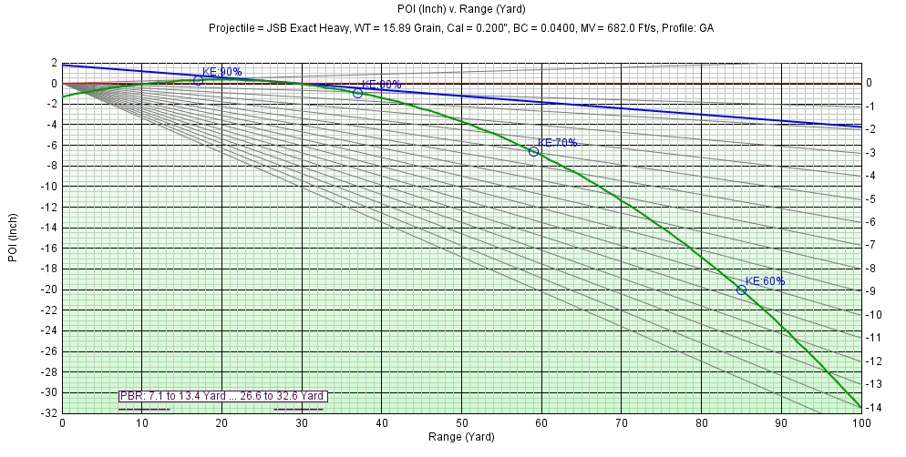

You can use a LASER in conjunction with your mil dots to measure range very accurately. This one is set up so that the LASER and zero are coincident with the top of the trajectory to keep the graph easy to read. You can range directly from the graph.
Two mills below LOS (magenta) on the LASER (blue) is at 95 yards, etc. Where the POI (green) is -13 mils. and remaining energy is about 50% of muzzle energy.
One mil below LOS on the LASER is at about 63 yards where the POI is about -3.5 mils.... etc.

The setup I show does both a ranging function and hold under at short range... Because It also tracks the pellets rise to the first zero.
