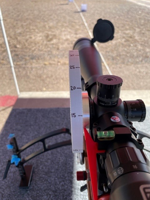

Next is a Nightforce NX8 - using a JD Garland Nautilus wheel - set up at 86 degrees F
and yes i will Definitely post some better pics.
My NX8 only has about 120-130 degrees of rotation between 10 -60 yards...... but the numbers on this wheel in the pic seem to be a lot further (farther?) apart
Love the NX8 scope --it'll resolve a 1/2 yard and the reticle is fantastic-- but the numbers all squashed in that close is aggravating. Tried commas, hatchets, wheels....

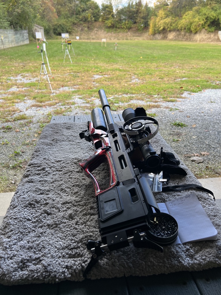

I have an Element Titan 3-18 x 50 with the 34 mm tube body and this particular Titan focuses down to 10 yards
AND
look at this spread on my 6” wheel:

Cavedweller, probably missed it but what do you use for tape and how do you keep it dry?
I use a high quality medical tape @3/8” non stretchy then after getting my final number markings I cover them with a clear tape like a book binding or gorilla tape @3/8”
But there are lots of ways to do this and some folks spray them with a clear polyurethane
