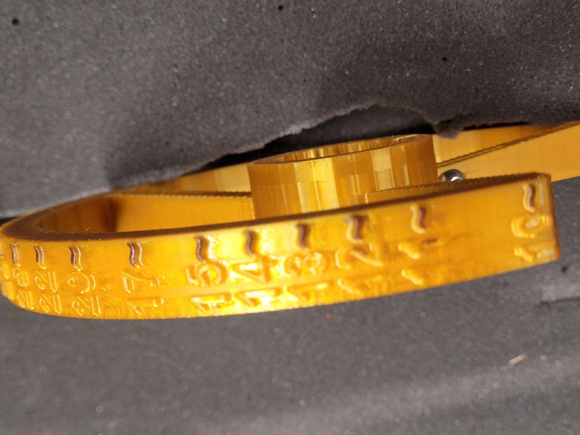

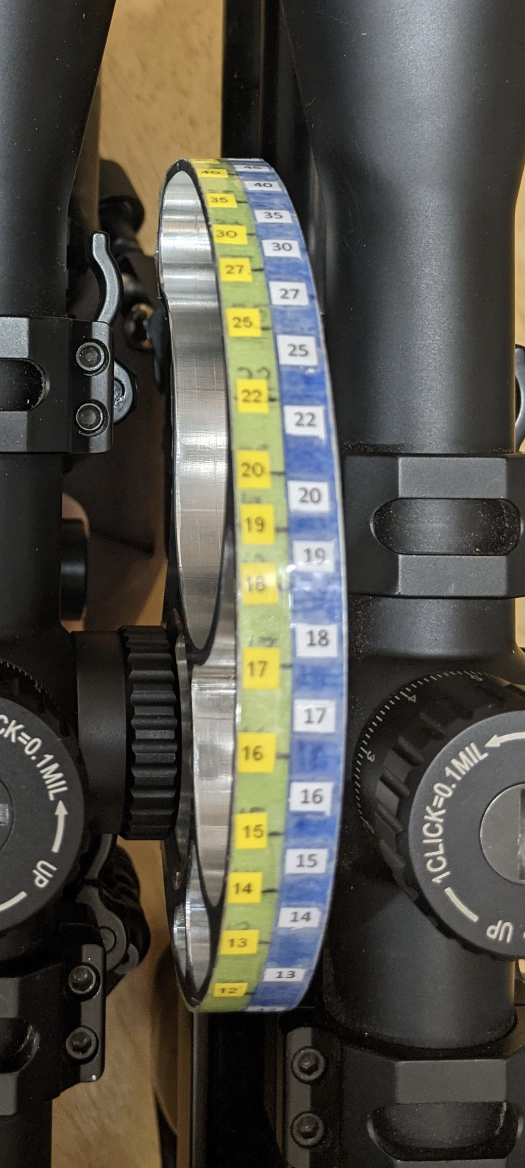

Here's pictures of the wheel as I have it marked up right now (for MY eyes). If you don't see a mark for a certain yardage it's because I haven't gotten to it yet or I have tried it and was unsure so I'll come back to it another day and try again. Hope this helps out somehow.

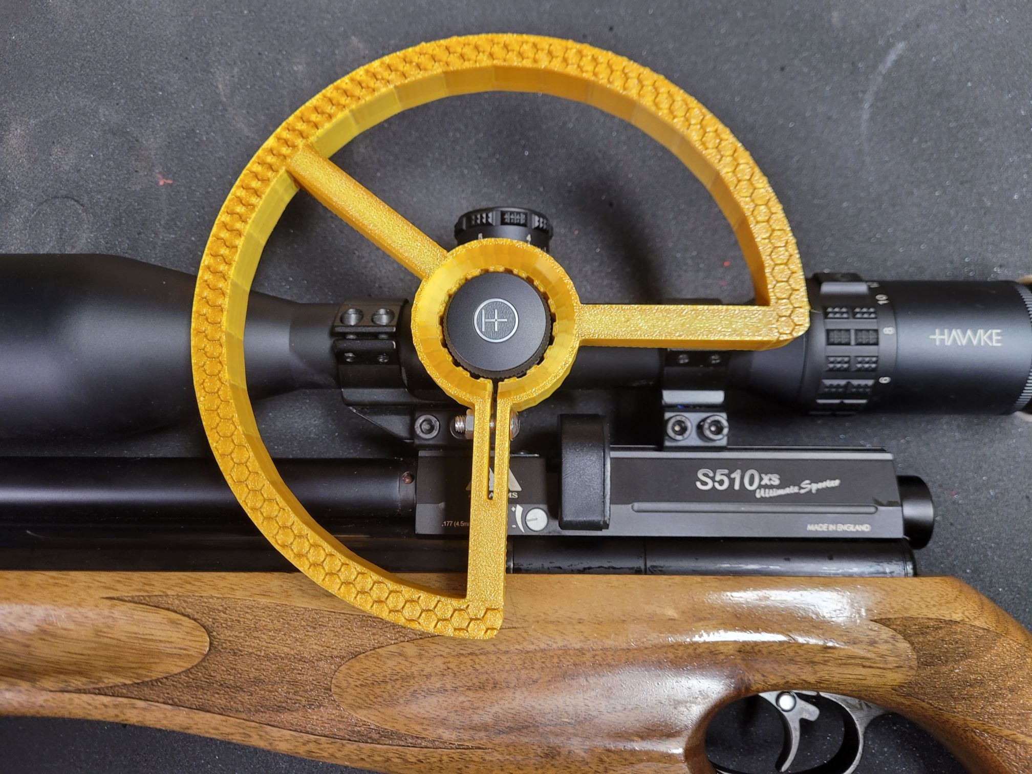

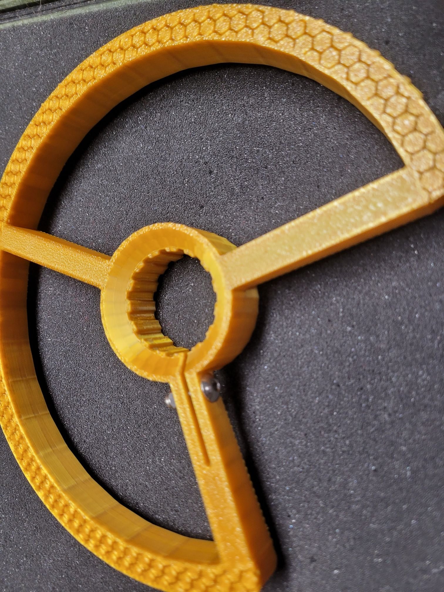

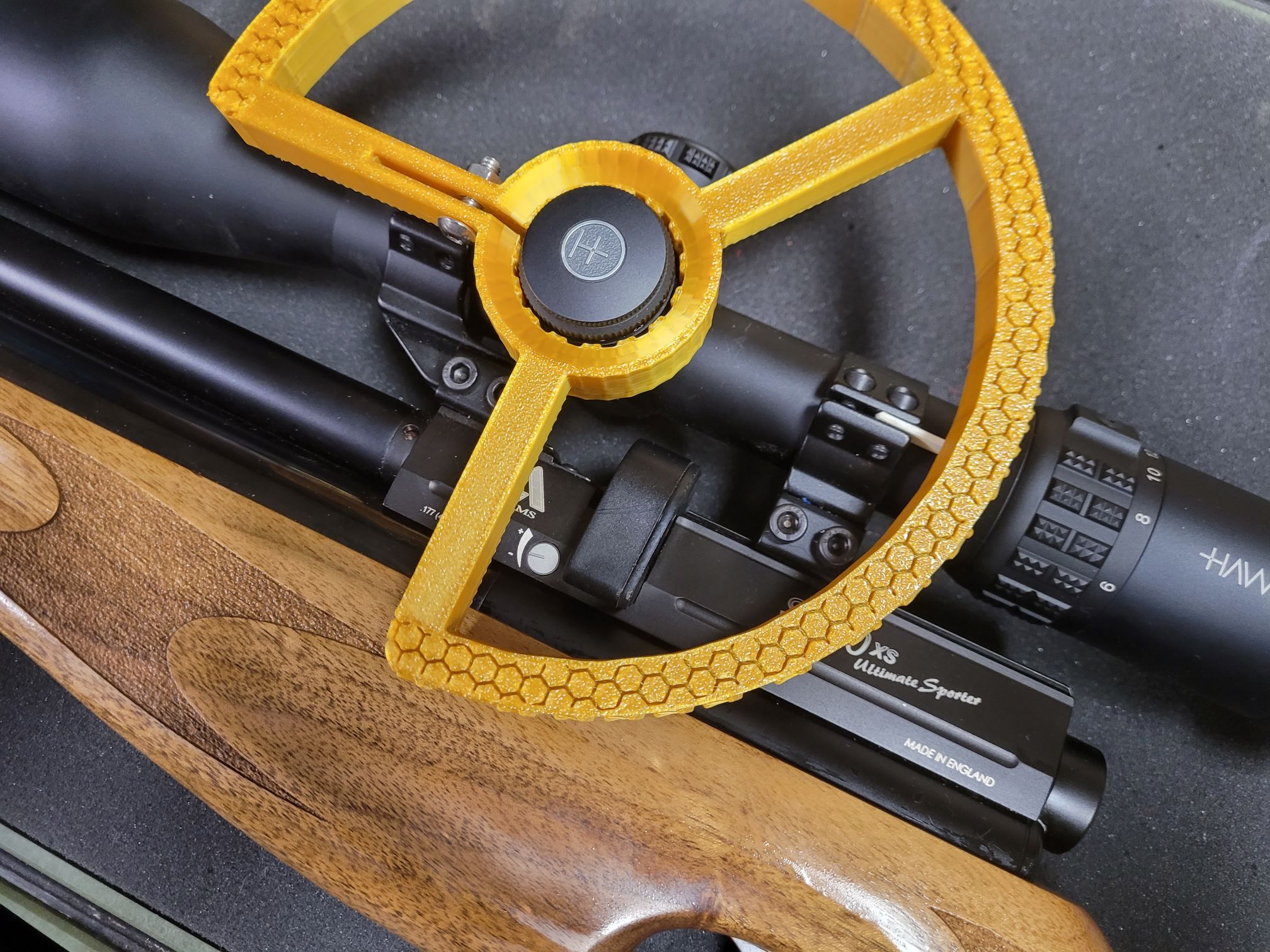

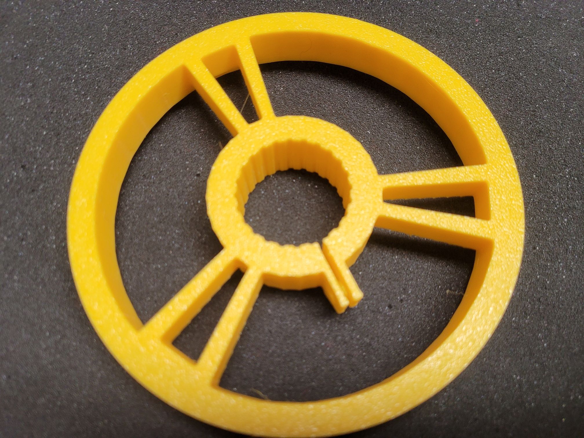

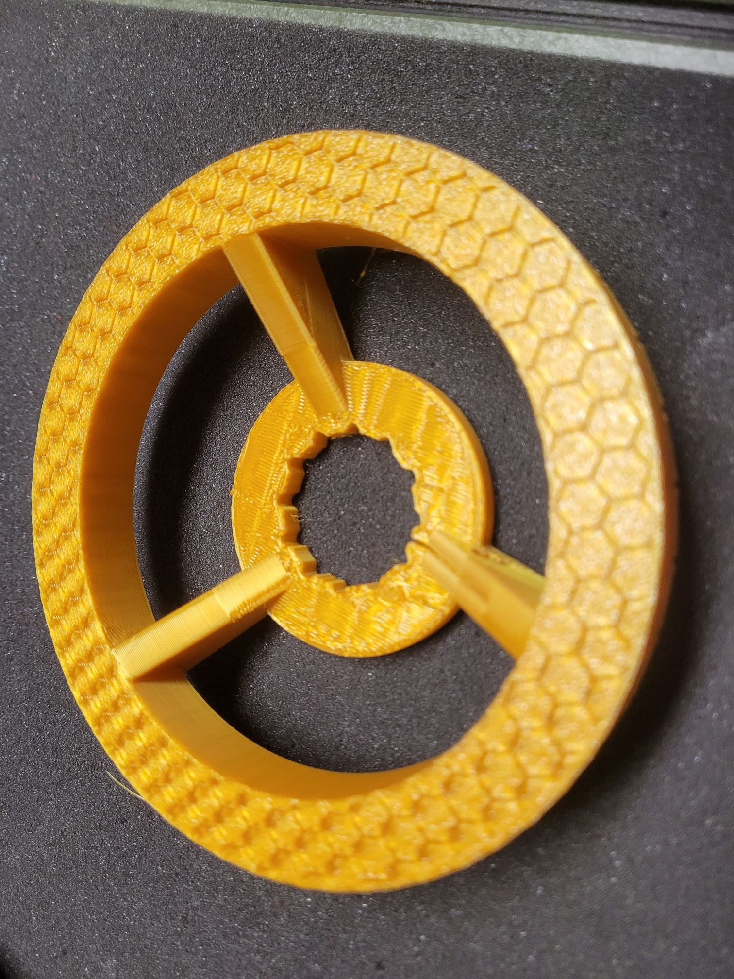

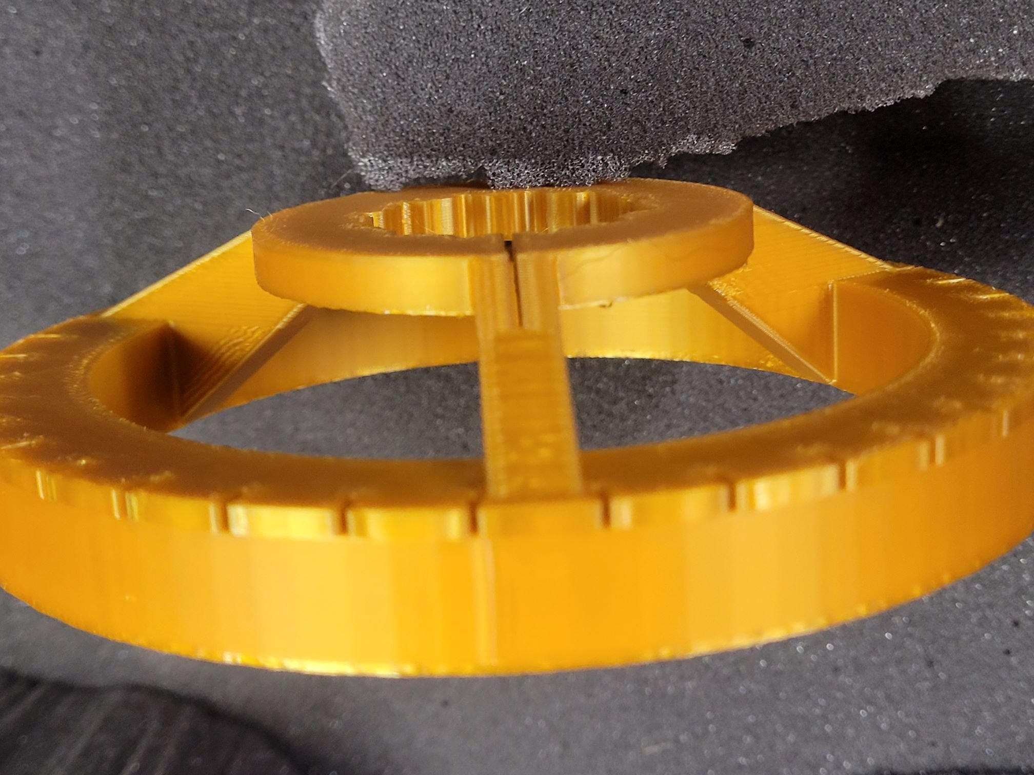

I also got into 3d printing around the same time and said to myself this should be easy to print a wheel. I started to look at other guns and other scopes and came up with a crazy mosaic of wheels and hubs for different combos.
I bought a wheel that had set screws to attach to the adjustment knob and thought to myself why not design a wheel that fit snuggly on the hub so I did. A couple of shooters saw what I did and asked if I would make them one. Then I realized that every parallax wheel has different requirements.
First lets go back to the degree of rotation between 10 and 55 yards. My Hawke Sidewinder has about 120 degrees while my Sightron has about 230 degrees. Sure would be a nice spec to know. But that has little to actually do with wheel design other than bigger wheels, longer circumference, more distance between yardage marks that get closer the farther the target.
So I have started to make wheels for different scopes with the idea that like my original wheels I can match the grooves on the parallax hub. Just slip the wheel on and if it is snug and there is no play you are all set. The few wheels I have made so far do fit very snug but I do use a slit in the hub and a small bolt to tension it as we are taking about 10s of a millimeter of tolerance.
This all may sound great but do you have any idea the differences in parallax adjustment areas. In just a few wheels I have made I have found 12,15,16,18 and 24 indents on the nobs. There are different diameters of the knobs themselves. Some scopes have illumination dials built in. Others have them on the body of the scope and limit the size of the wheel. My newest request has the adjustment knob very narrow and next to the scope body with illumination and battery cover out at the end.
There are also limits to 3d printing that you have to print building up from a flat surface. I also include marks every 10 degrees on the wheel and on my own wheels I have printed the ranging distances on the wheel instead of a flat surface for tape.
Back to my Air Arms and Hawke combination, I now have a 7" wheel with only one spoke in the way so I can remove the magazine with minimum cycling of the wheel.
Final thought, very few scopes are designed around field target. I'm glad I'm retired and can do this for fun.

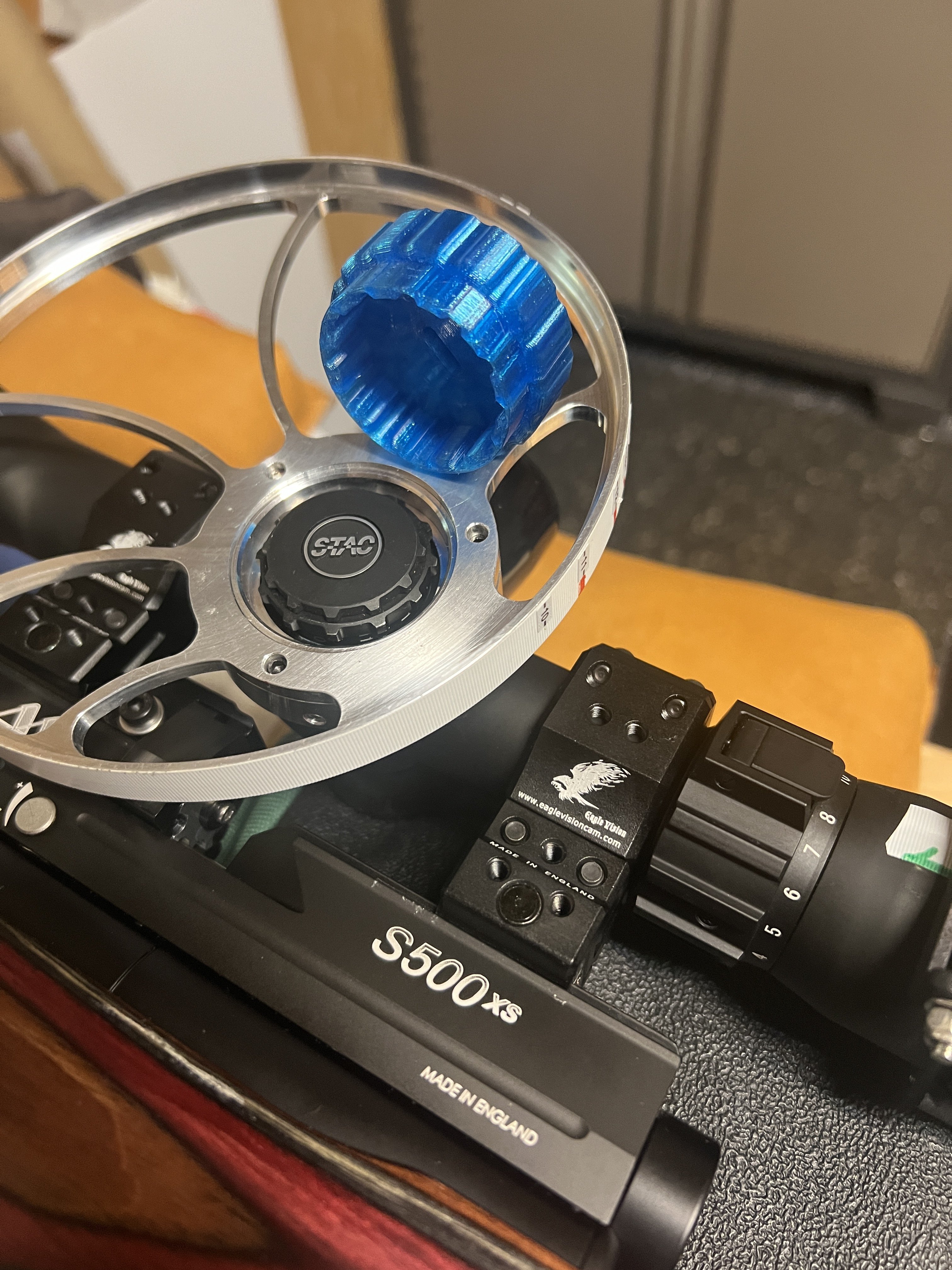

Great post but theres more!
Some wheels increase distance focus points with clockwise rotation of the parallax knob while others increase distance focus points via counter clockwise rotation of the parallax knob - whew!
Then you have to accommodate illumination knobs.
Then there is the means to create a visual and repeatable point or position indicator.
Then there is the sightron S-Tac line up.
These pics show an eccentric magnetic wheel which is removable for travel purposes.
Reactions: dgeesaman

I'm working on a S-Tac wheel for a friend who just bought one. I don't know if he can work the illumination spacing with his fingers so the knob looks like a great alternative. We have some dark woods courses in Ohio that illuminated reticles help with. I don't think there is a case made that you could keep the wheel on for storage.
A pin spanner works also but scope werks prints these keys so…. Easy

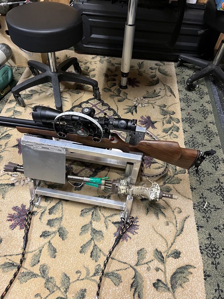

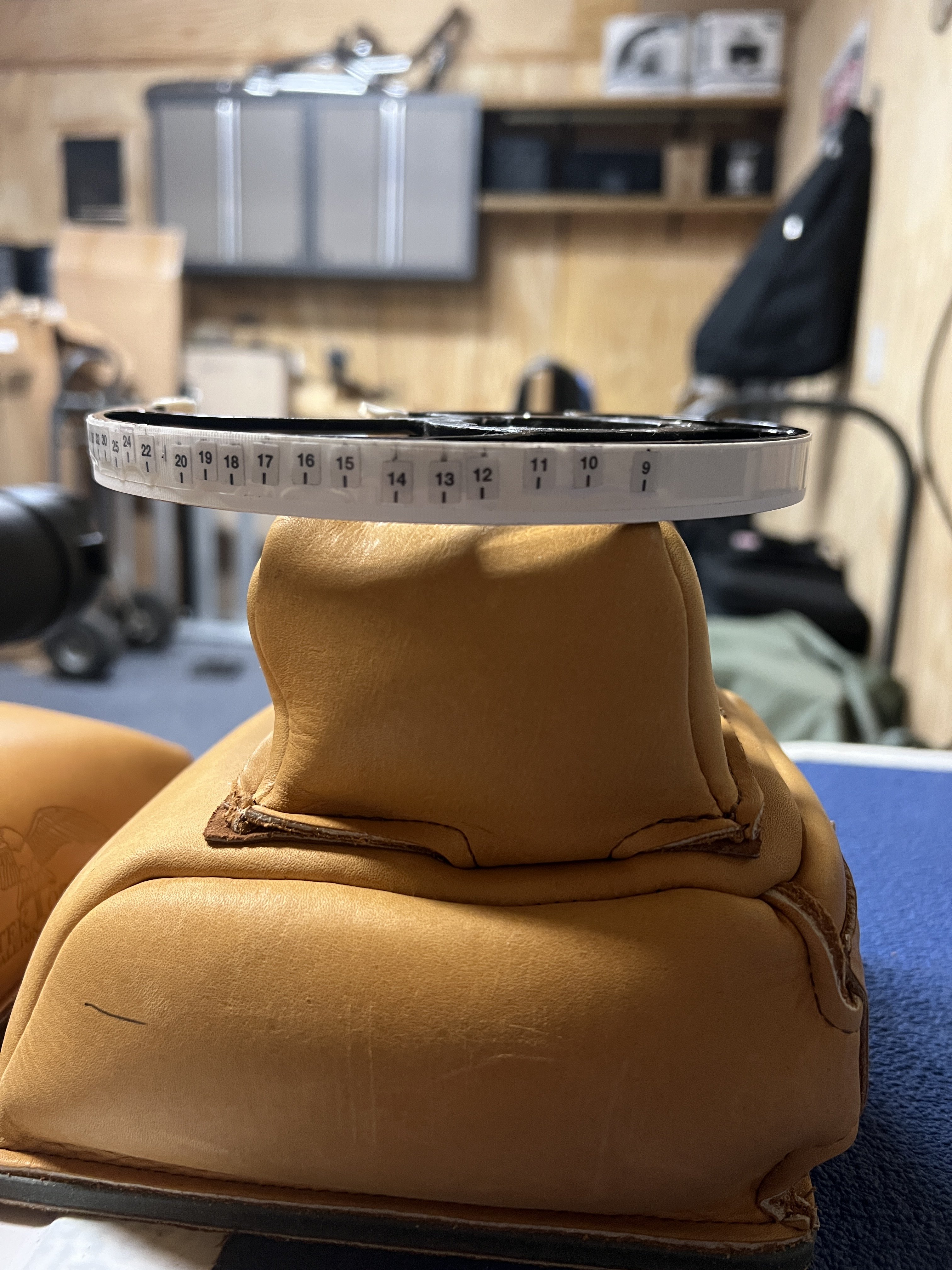

Here's some of the distances I've completed so far on my new Falcon X505-FT scope. I'm liking the spacing from 45-55 yards.
I still need to get back to it and fill in the rest of the distances. Weather permitting this time of year.
It'll be interesting to see how many single yards I can fill in between the major marks I have on the wheel in the pictures.
I'll update when I get it done.

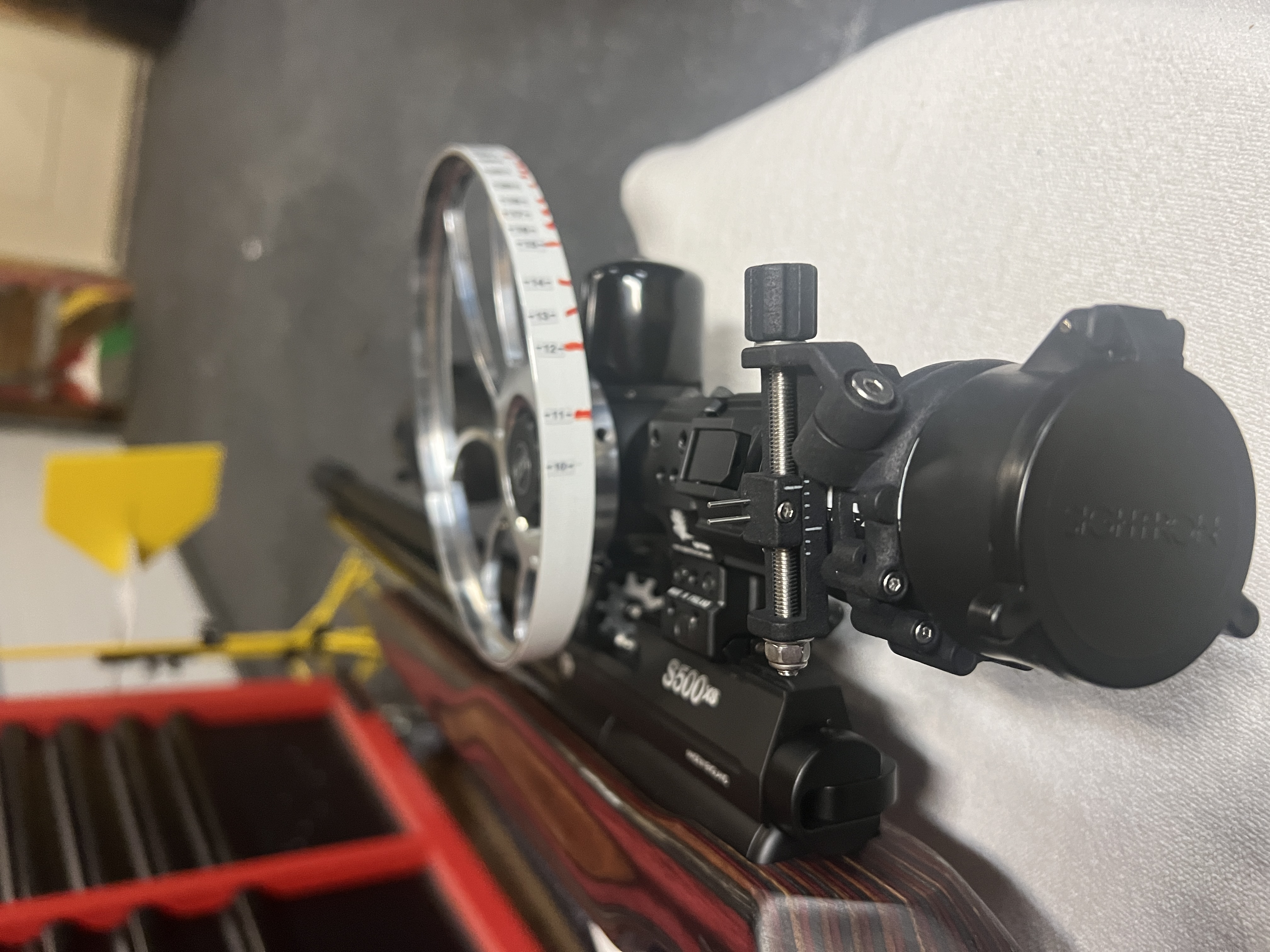

And.....Thanks JD!......Great job on the new aluminum magnetic wheel!
View attachment 416241 View attachment 416242
