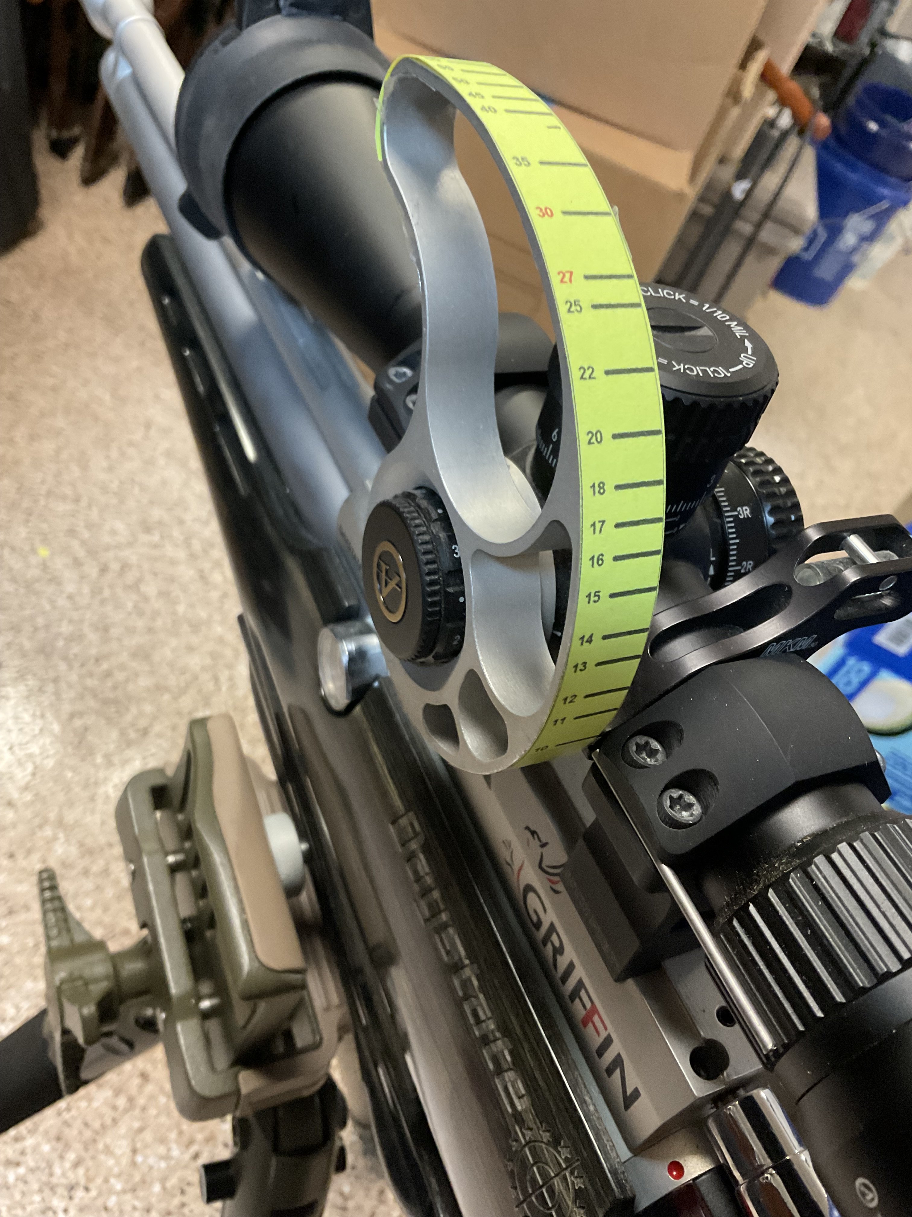

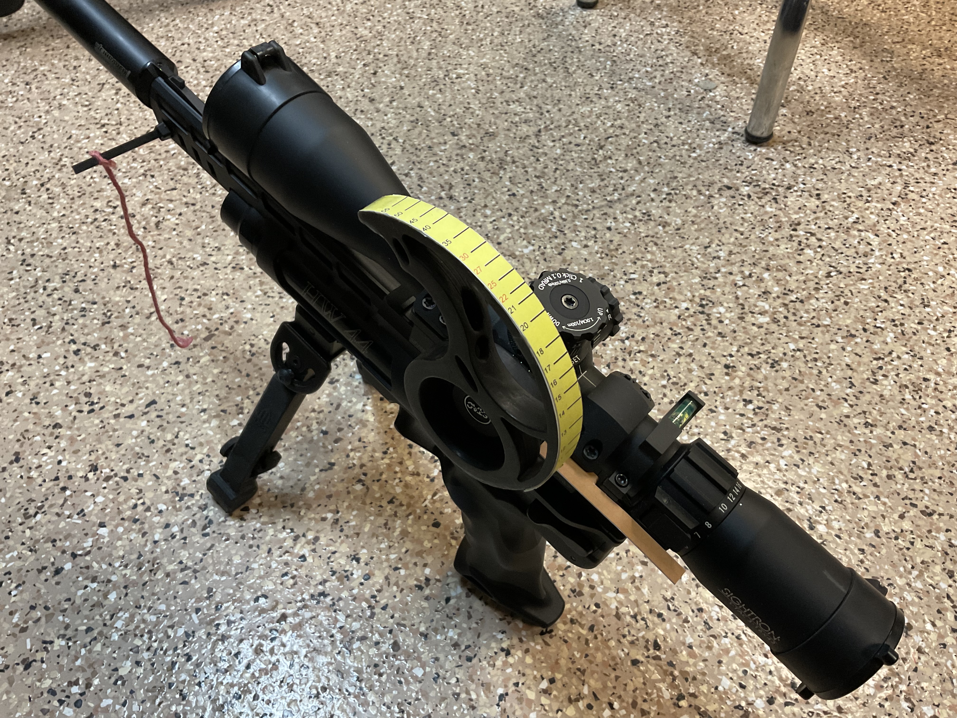

Here's the 10-55 on two different scopes and their wheels.
Falcon X50, 10 is @ the 8.5" mark, and 55 is at 3.75." So 10-55 uses about 300 ish degrees. (yardage marks at 50x)
And Athlon Midas Tac 6-24x. 10yards @ 8.5" and 55 yards at 3 and 1/8". 10-55 only uses about 180 degrees of rotation here. (yardage marks @ 24x, every single mark shifts down about 1/4" when at 16x).

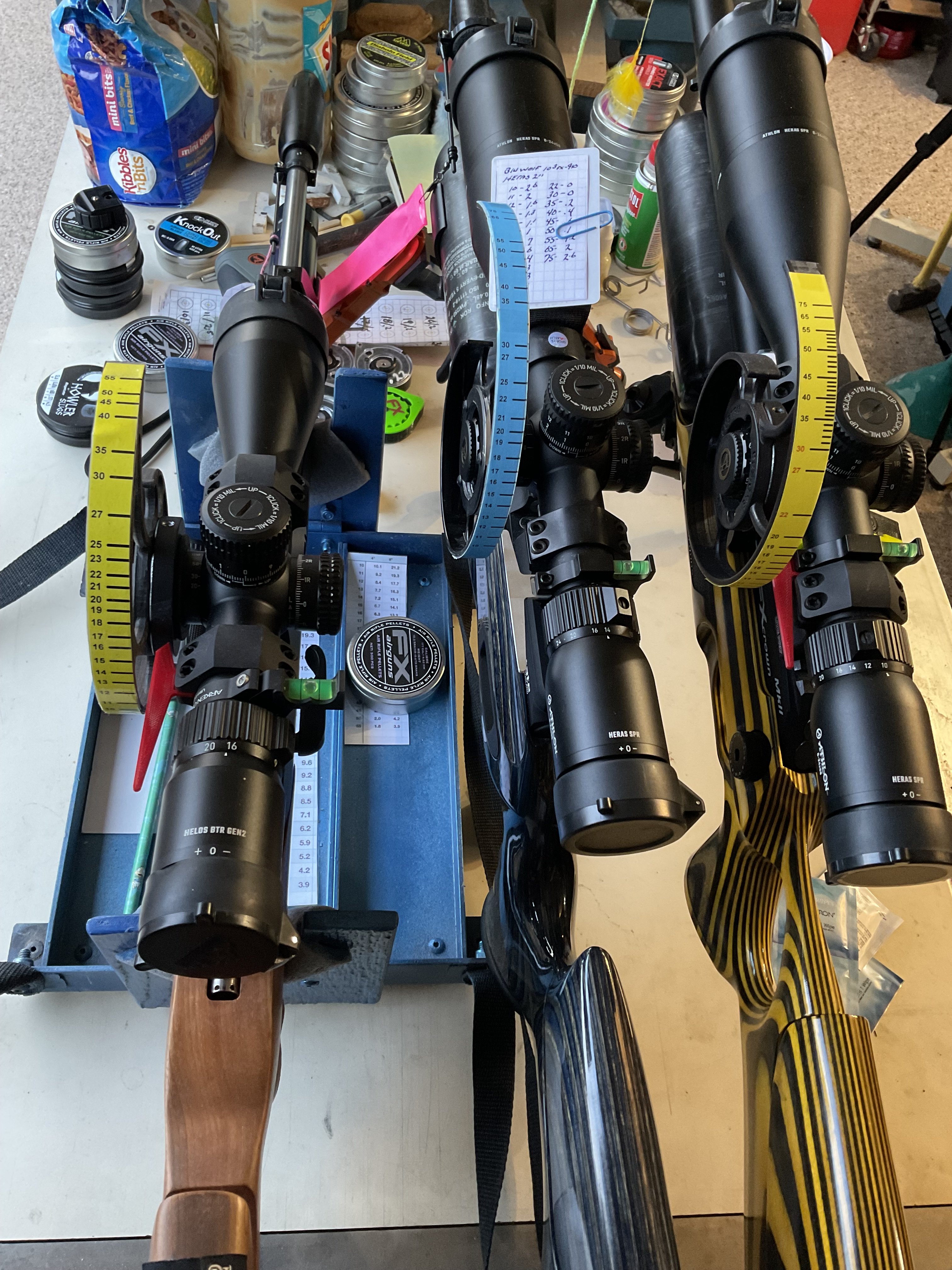

I guess I‘m a little annual and some of my tape colors have to match my gun 🙂 these 3 wheels are all from JD and they are nautilus wheels and all on Athlon scopes. The silver wheel is from scope-werks and is a nautilus, the pistol wheel I printed myself on a Sightron . I hand do my tapes then transfer the dimensions on a program for scope-werks and it prints out real nice. The cool thing about the program, you can save all the tape dimensions and alter them when things change.
Very nice can you name your scope”s”
And Athlon Midas Tac 6-24x. 10yards @ 8.5" and 55 yards and 1 and 1/8". 10-55 only uses about 180 degrees of rotation here. (yardage marks @ 24x, every single mark shifts down about 1/4" when at 16x).

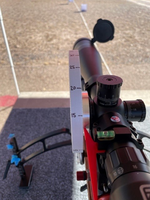

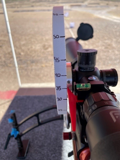

Here's some of the distances I've completed so far on my new Falcon X505-FT scope. I'm liking the spacing from 45-55 yards.
I still need to get back to it and fill in the rest of the distances. Weather permitting this time of year.
It'll be interesting to see how many single yards I can fill in between the major marks I have on the wheel in the pictures.
I'll update when I get it done.
And.....Thanks JD!......Great job on the new aluminum magnetic wheel!

thats a great spread from 40-55 yards.... wow! But after looking at the reticle... why the heck couldn't they simply number each line or every other line. Arghhh.

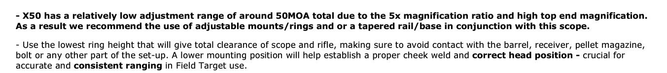

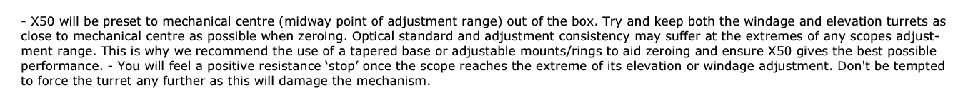

As I was browsing through the Falcon website I came across this little bit of information:
So........I guess I'll be double checking how close to being optically centered the scope is and if it's very far out of whack, I'll pick up a set of adjustable rings for this and change them out before getting too far down the road with this.
recommend eagle vision 30 MM inf adjustable side mounts.

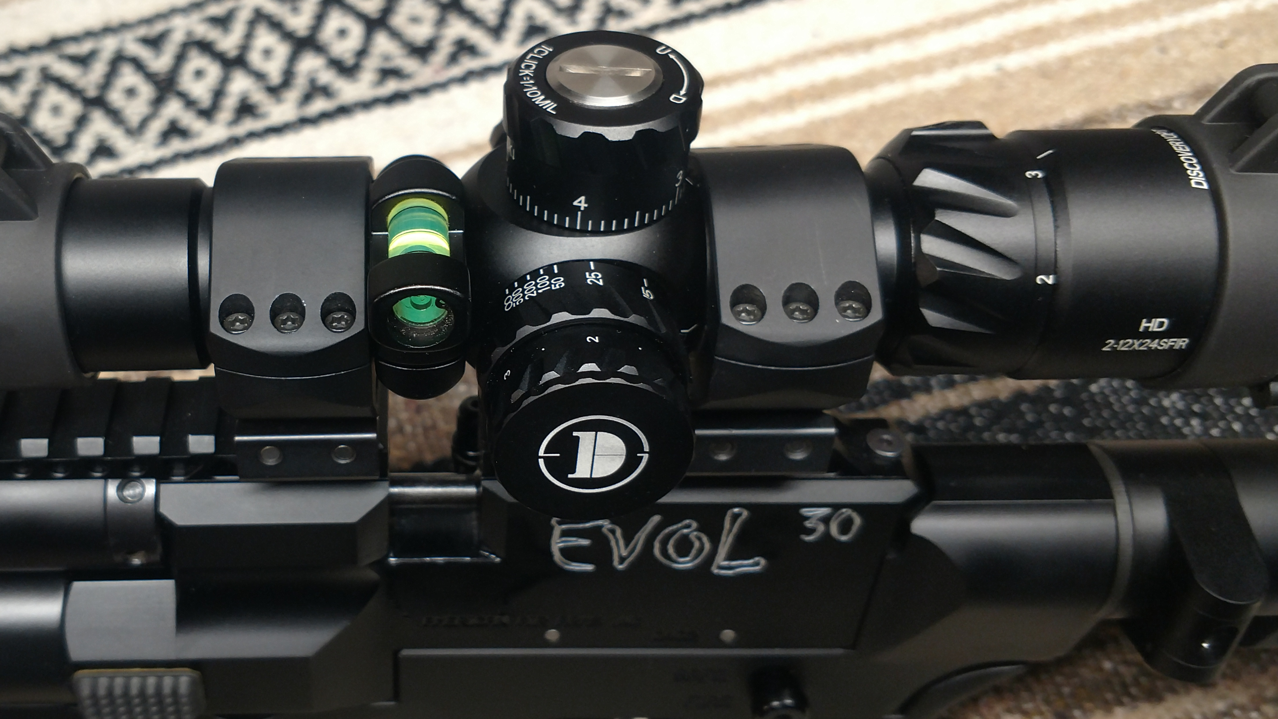

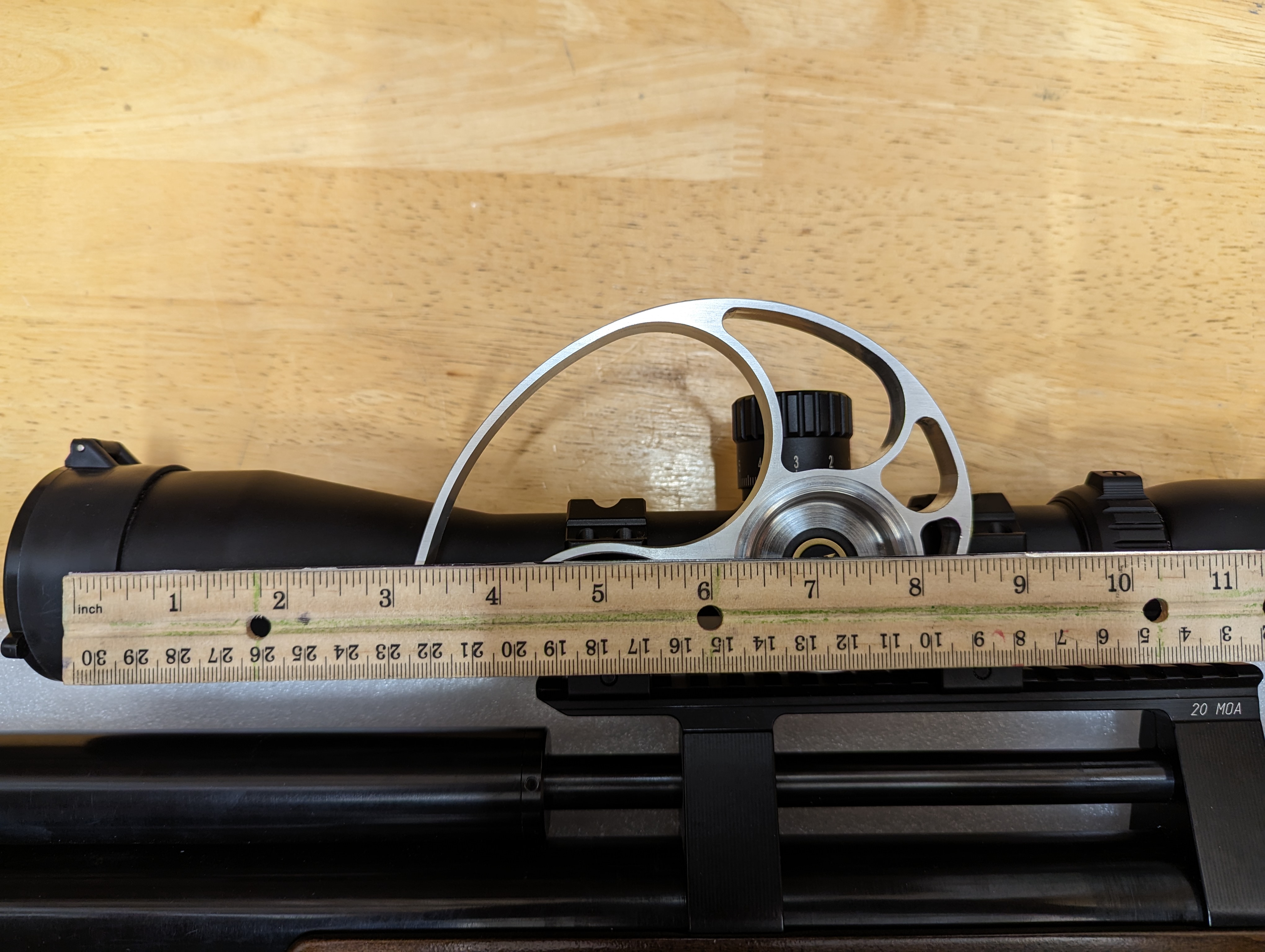

I haven't used a wheel to range in field target matches, but thought this may interest someone here because of the super low 5 yard parallax adjustment and the amount of degrees in between the lower yardages. Here's a look at the DiscoveryOpt 2-12X24 SFIR FFP parallax wheel. In the picture, it is set on 10 and shows 90° to the 25, but the 5 is more than 90° away from the 10. It gets noticably tighter as it goes to the 50, 100, etc, (so a curved wheel is probably appropriate to spread out the longer ranges?). I've read where two yardage tapes are used based on temp and sunlight, so wouldn't a shorter scope like this without a big objective lense be less susceptible to clouds/heat/sun effecting your accuracy?
looks like it would work for Pistol HFT as 12X is max magnification.
Rifle HFT 16x is needed (or desired).
$175.00 is a good price point: https://www.discoveryriflescopes.co...-etched-575g-24-4cm-shooting-hunting-army-use
View attachment 416241 View attachment 416242
that is a great spread between 50-55! wow.
