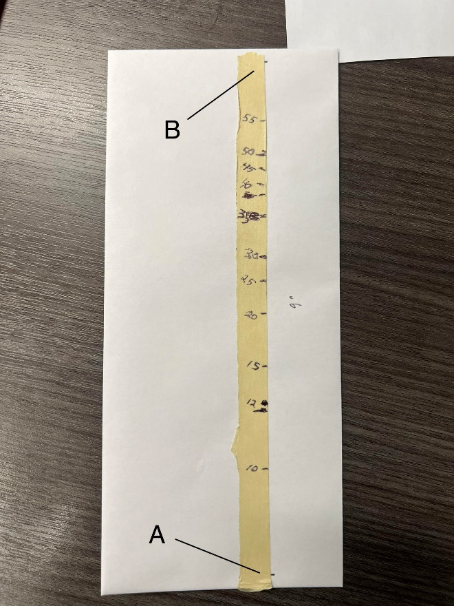

Step 4: Remove your scope tape and apply it to a sheet of paper. Using a ruler and starting with mark A, measure a known distance and mark B. The longer the distance the better. I generally measure out 9 inches.

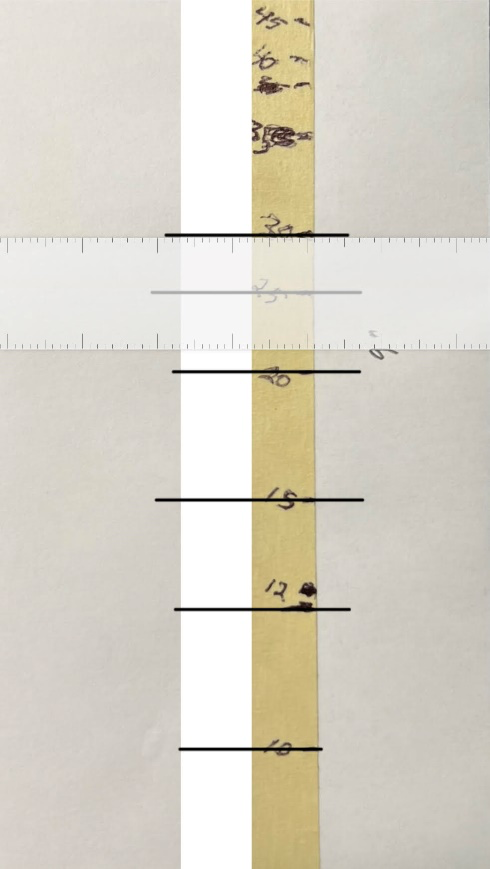

Step 5: Using an iPhone take a good picture of the sheet of paper. Go to your photo in the gallery and select Edit, choose the pen tip, click the plus button (bottom right). Select the box and create a rectangle beside your scope tape. I try to make it the same width and length as the masking tape. Click the fill button then fill white.

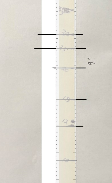

Step 6: Select the ruler at the bottom of the page. Use two fingers on the ruler to move it around. Select the pen and use the thin line (left) with the darkness slider all the way to the right. Transfer all your yardage marks onto the white box. You can pinch and zoom to transfer the exact location of these marks onto the white rectangle you created.
Step 7: Transfer A & B – It is important to transfer mark A & B onto your white rectangle. Do this as accurately as possible.
Step 8: Cleanup - After all yardage marks are transferred, turn the ruler to 90 degrees and cover the portion of yardage marks you want to keep on the white rectangle. Using the eraser, erase the excess. Note – lay the ruler over the marks you want to keep and erase the rest.

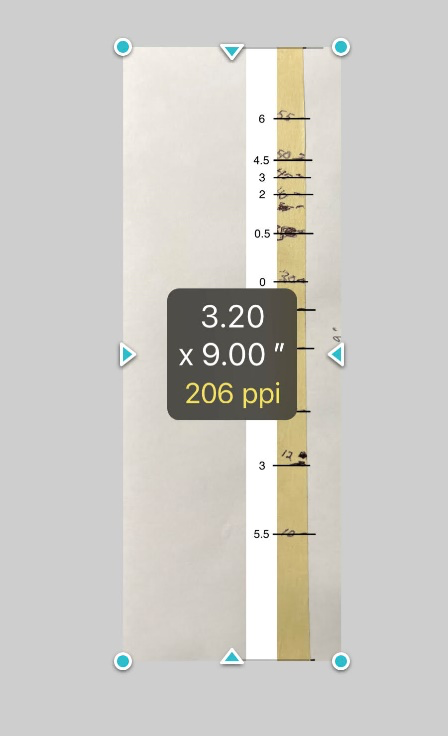

Step 10: Printing to size – Open Print to Size app and click the plus button. Select your edited photograph, Crop the top of the image to cut through line B (created in step 4). Crop the bottom of the photograph to cut through line A. A measurement will be displayed in the center of the image. We are only worried about height. If you measured 9 inches from A to B, you want to get to exactly ## x 9.00” to be displayed. You may crop the sides in to just the white box you created but it is not necessary.

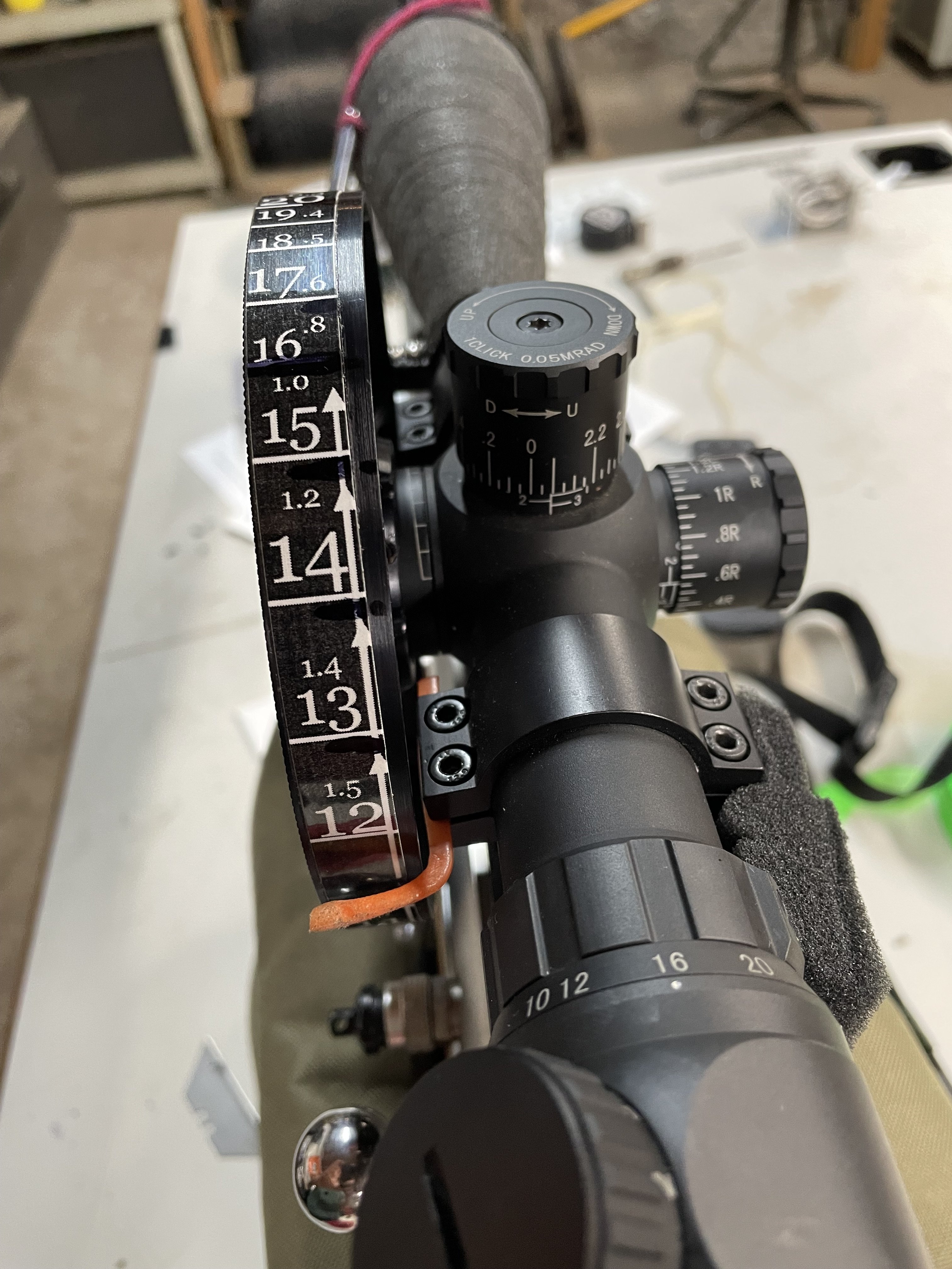

Step 11: Print – Send your image to the printer and cut the new tape you created. Apply it to your parallax wheel by lining up “A” on the tape to the mark or score line on your parallax wheel. ENJOY!
