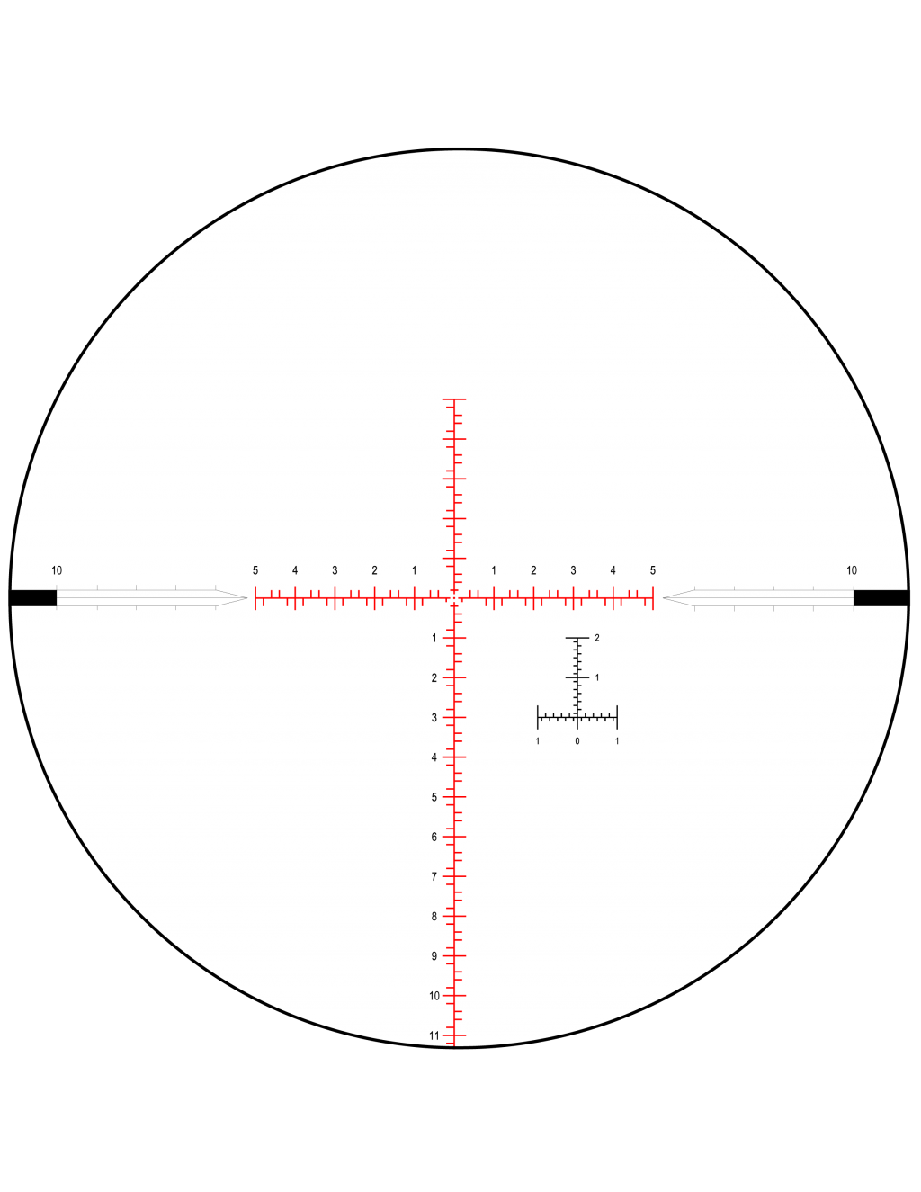

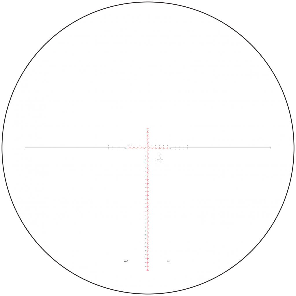

It depends on what type of shooting you'll be doing. If you like to shoot at small, tiny objects at close distances such as 10 yards, then definitely get a scope that can focus down to that distance. If you hunt a lot, then some of the scopes that only focus down to 25 yards should be fine if you lower the power level to 3x, 4x, 6x. You also mentioned FFP scopes and their reticles being hard to see at lower powers. My suggestion is to get a scope with .2 mil spacing for ranging.
When you have the magnification up on the higher end, it sometimes looks cluttered but when you lower the magnification, the .2 mil spacing seems to come in as one and the reticle appears to be thicker. It also helps to get a scope with daytime bright or close to daytime bright illumination. Set your FFP scope on the lowest magnification and have the illumination on the brightest setting. I do this with my Nightforce NX8 2.5-20×50. I also have an Athlon Cronus BTR Gen2 4.5-29x56 on order and from what I've heard, it has daytime or close to daytime bright illumination but it only focuses down to 25 yards.
Here's an example of .2 mil spacing on an FFP at 2.5x...
