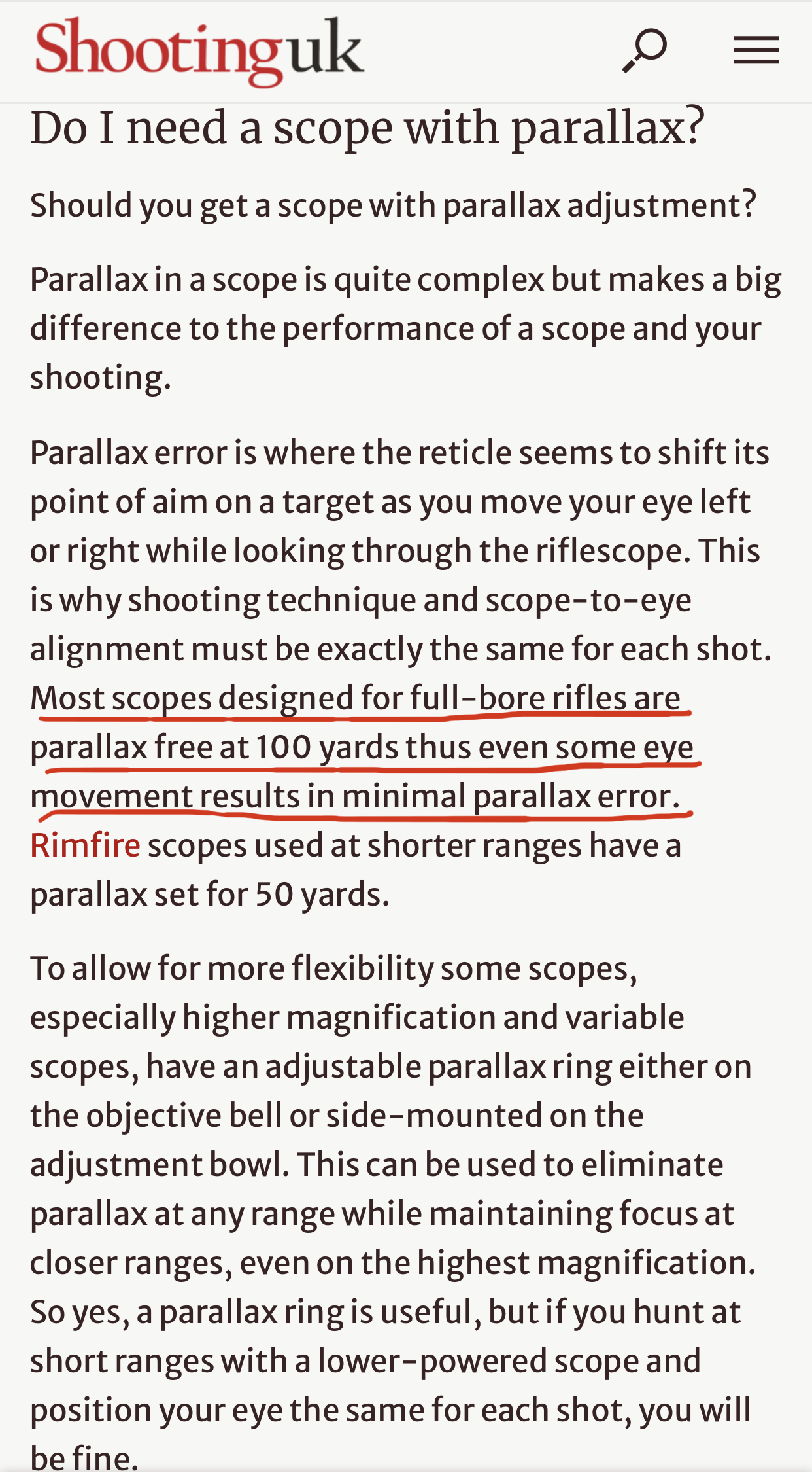

I found this and thought it may help some.
