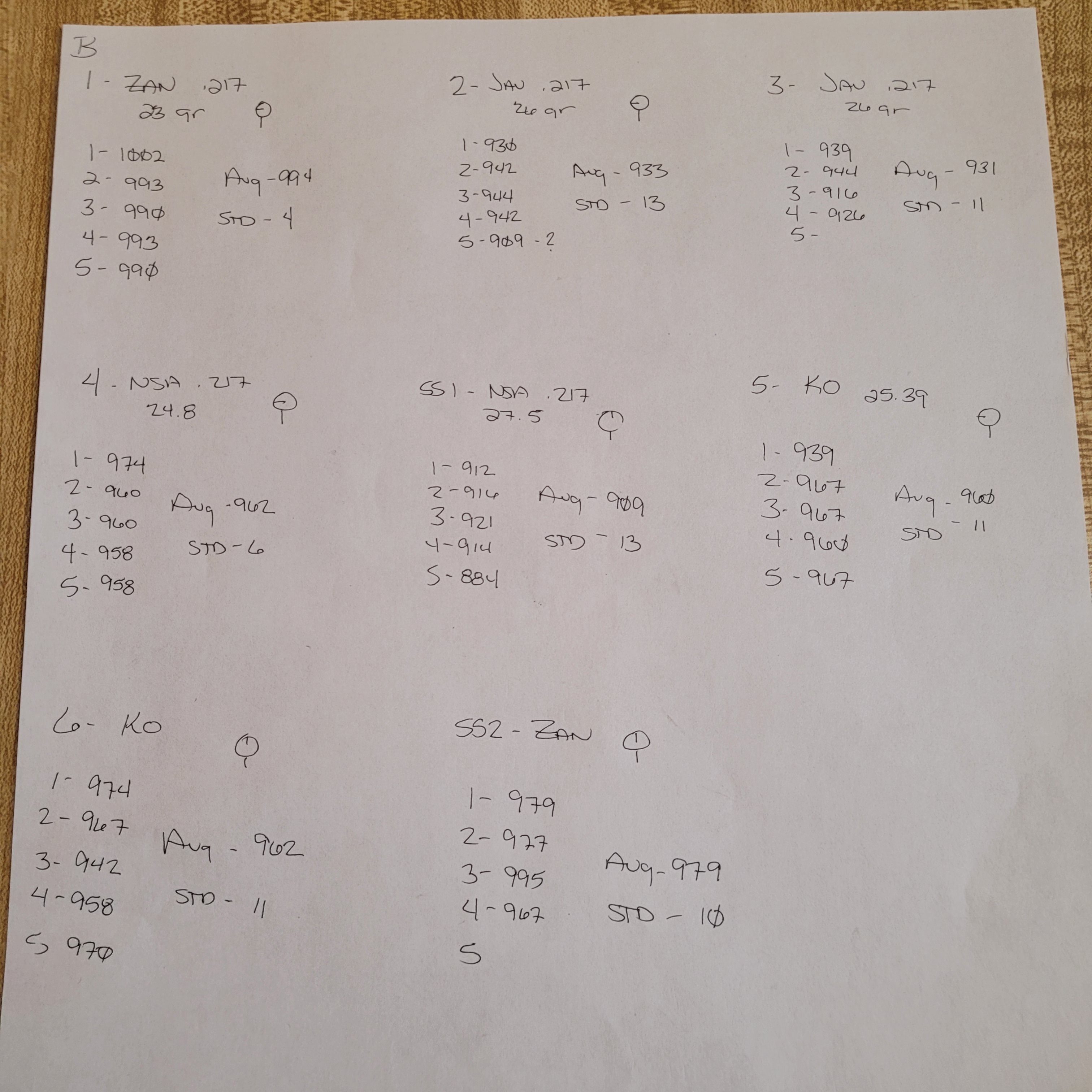

The set up was as it looks above, a basic plastic table with the rifle and chronograph. I tested a bunch of different Javelin slugs in both .216 and .217, NSA slugs in .216 .217 and .217, Zan slugs, Daystate Howlers, H&N .217 slugs, and Knockout slugs. Also did a few baseline shots with the FX 18.1 pellets as well as the 25.4 pellets so people can approximately get a close set point. All of the shots were 5 shot groups with the regulator set at approximately 2200 psi. You will see on the page with the chronograph numbers that there is a circle with lines on it. What these are showing is the position of the hammer spring adjustment screw. I removed the stock from and put a mark at the 6 o'clock position.

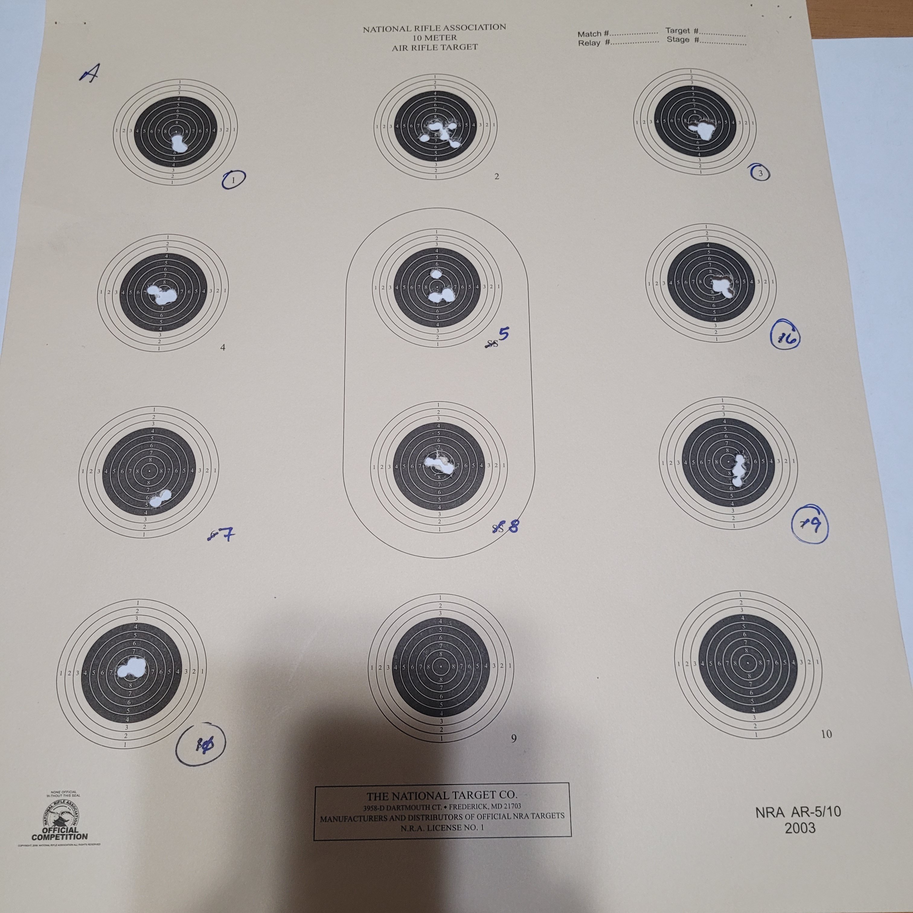

These are the targets that I shot on Monday to see what the slugs would do. I had my chronograph to see if there was anything odd about the shots. Just wanted to see if there was anything that stood out. There were a few that showed promise and today I wanted to get some solid number and do some minor adjustments.
Again all shots are with the Regulator, the blue one, set at approximately 2200 psi, shot at a range of around 20 yards. Next week I am planning on hitting the range again and doing some grouping at 50 yards, 75 yards and 100 yards to really see if I can get a slug to perform well enough to hunt with as well as use for my local NRL22 matches.

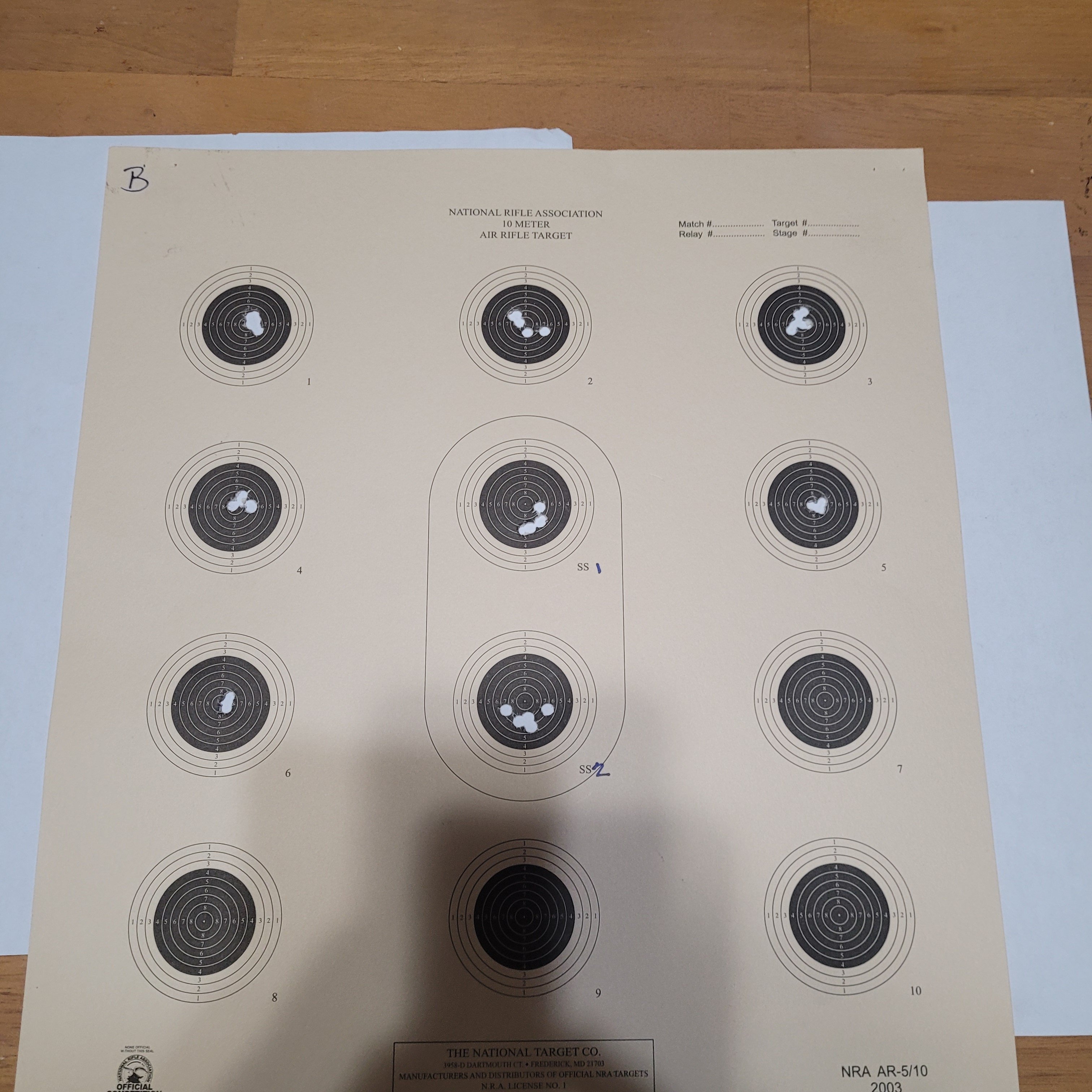

I am using some 10m targets for the tests to keep things together and to see any kind of movement of groups. In the upper left hand corner you will see and "A" and a "B" these will correspond with the chronograph number page. The targets themselves are numbered 1 through 10 with 2 sighters in the middle. Now I messed up and numbered the sighters on card "A", so those numbers are written in blue marker. On target sheet "B" I remembered the sighters the chronograph page has SS1 and SS2, for sighter spot 1 and sighter spot 2.
Here are the target pages that were shot at 20 yards. All groups are 5 shot groups, the only one that was different was the seventh bull. I was getting slugs stuck in the barrel with the NSA slugs so I stopped shooting them at that point. Chronograph page will be under each target sheet to help keep track of things and to see what is going on. The circled numbers on the target sheet are the slugs that were showing promise and ones that I wanted to test further.
The chronograph sheet above you will see the circles with the lines on them, this is the hammer spring adjustment location. This will allow me to fine tune the rifle if needed and get a repeatable setting. I would LOVE to see this on any of the rifles coming out. Makes resetting the rifle and sharing tunes with others really easy.
