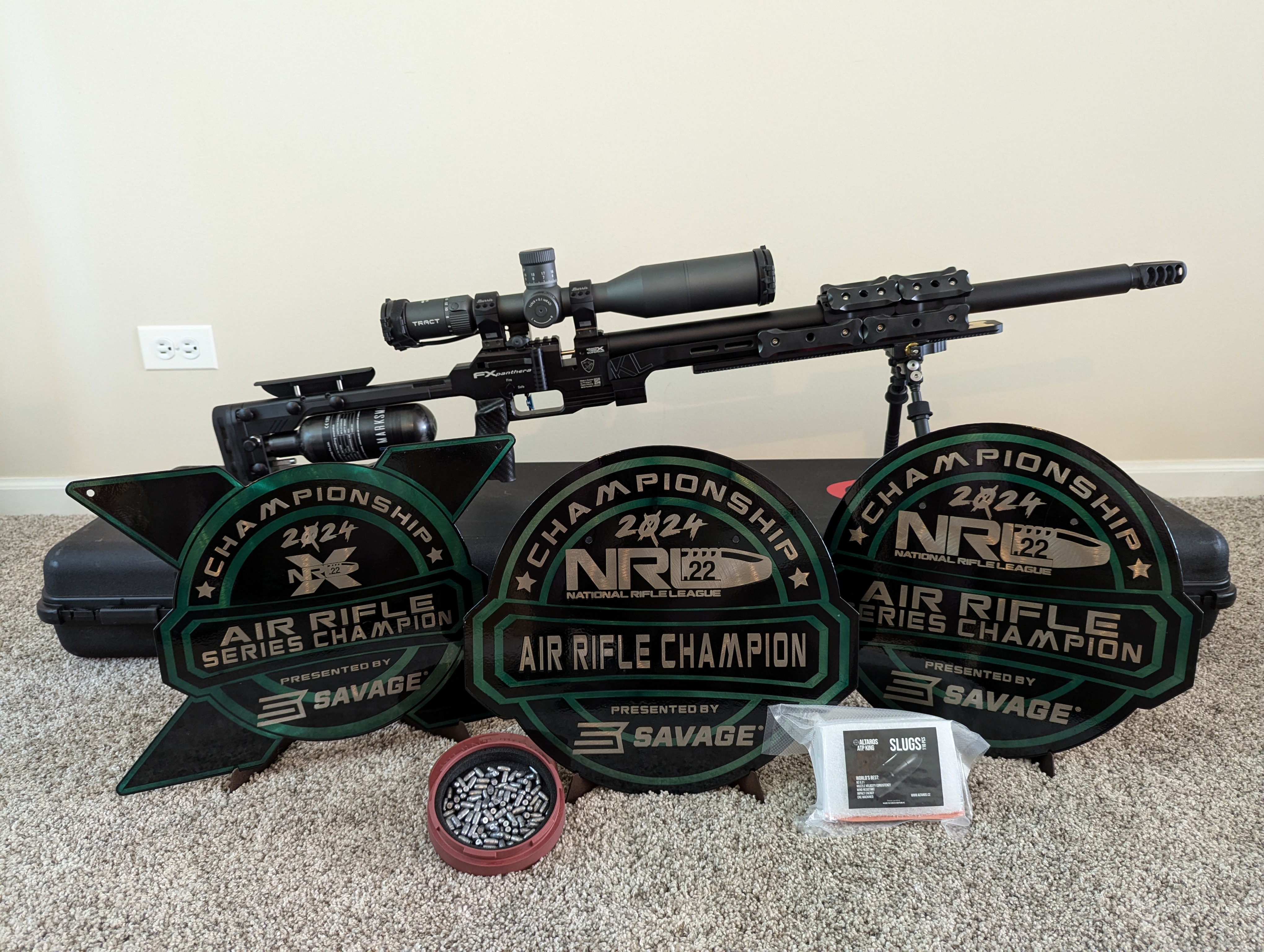

just a thought..a members accomplishmentView attachment 590210
