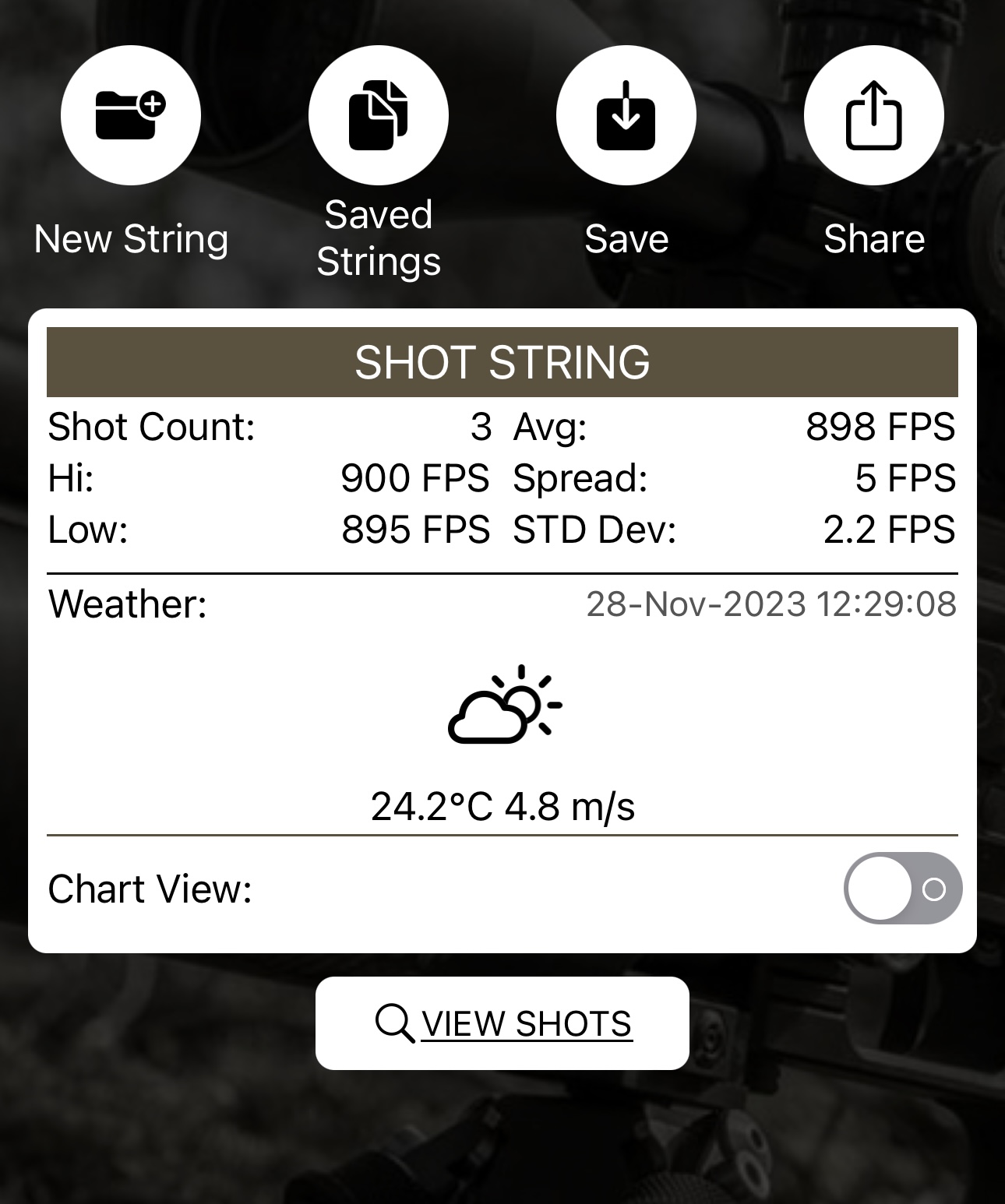

I picked up some .22 40gr kings and on the same 125bar setting and at 2 on the micro they running at 890 average. Once I get some time to do some group tests I’ll report back. Thanks @Centercut

I’m always careful to point out that I shoot them at 895fps. You should find the reg pressure that gives you the ability to tune them to 98% of max speed, providing a buffer for reg creep and refresh.
Thanks Weevil, I think with the longer barrel I may need to drop my reg another 10 bar or so to get into that bracket, need to get a few packs or the 32s so I can find the sweet spot from the 700mm

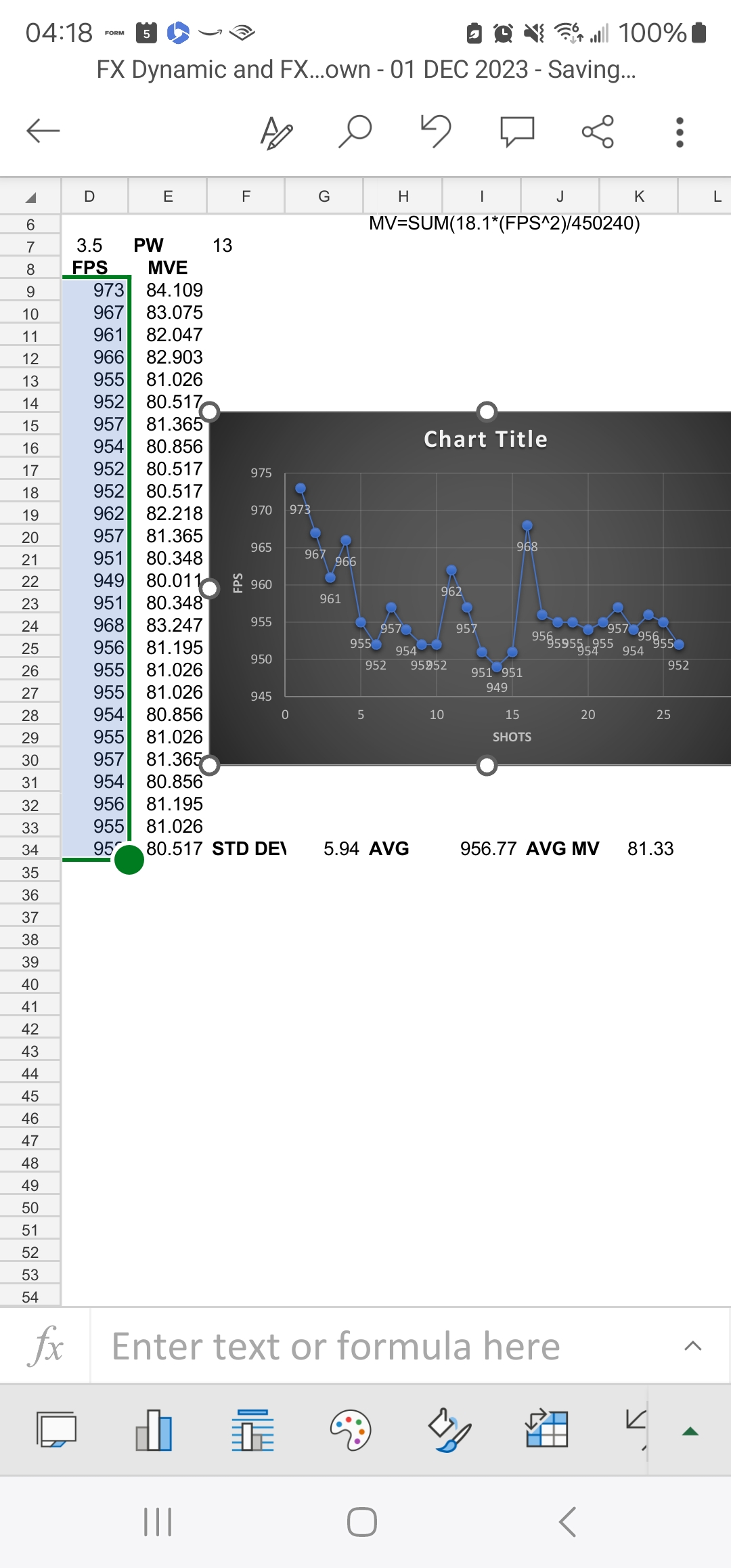

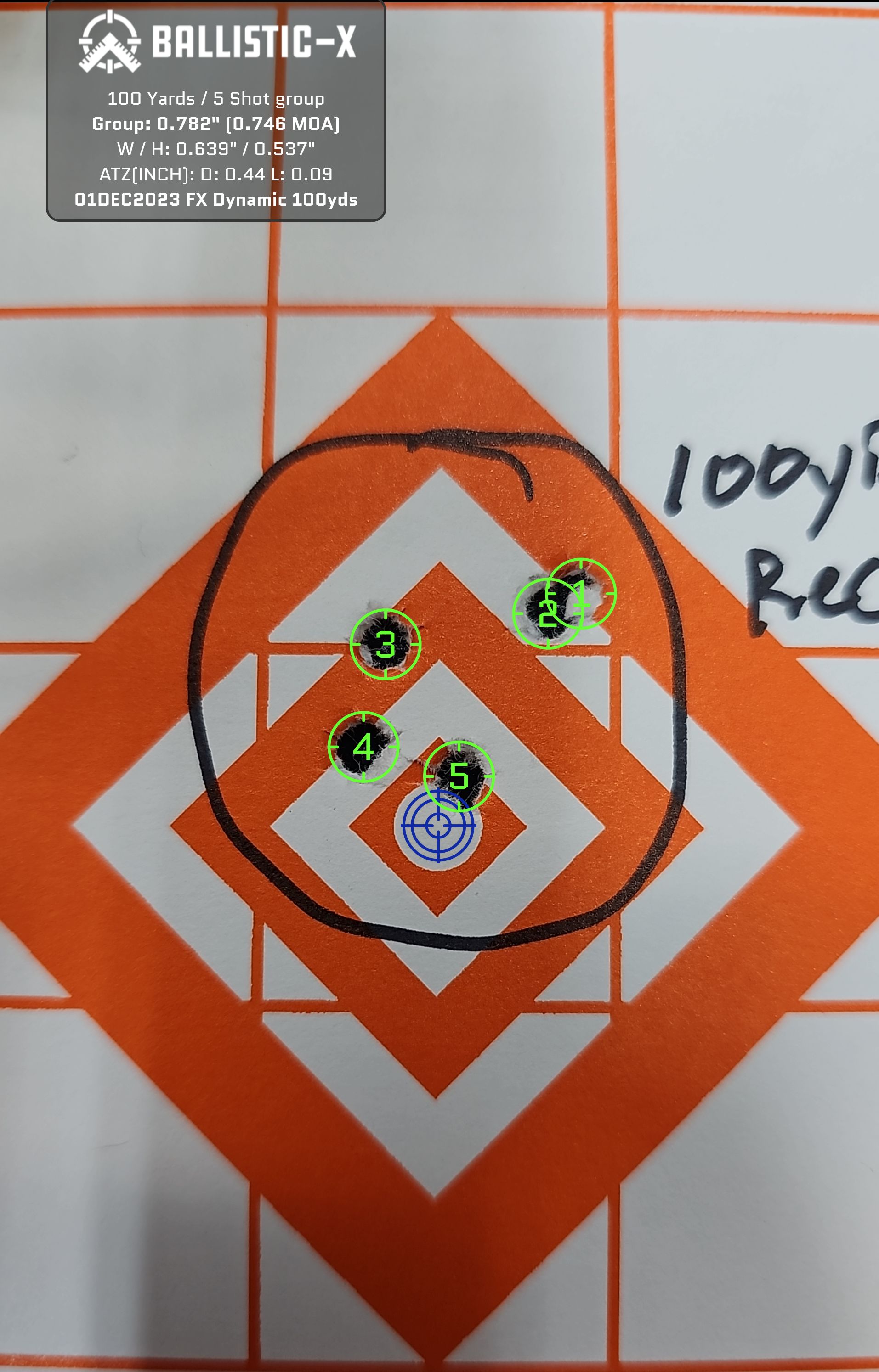

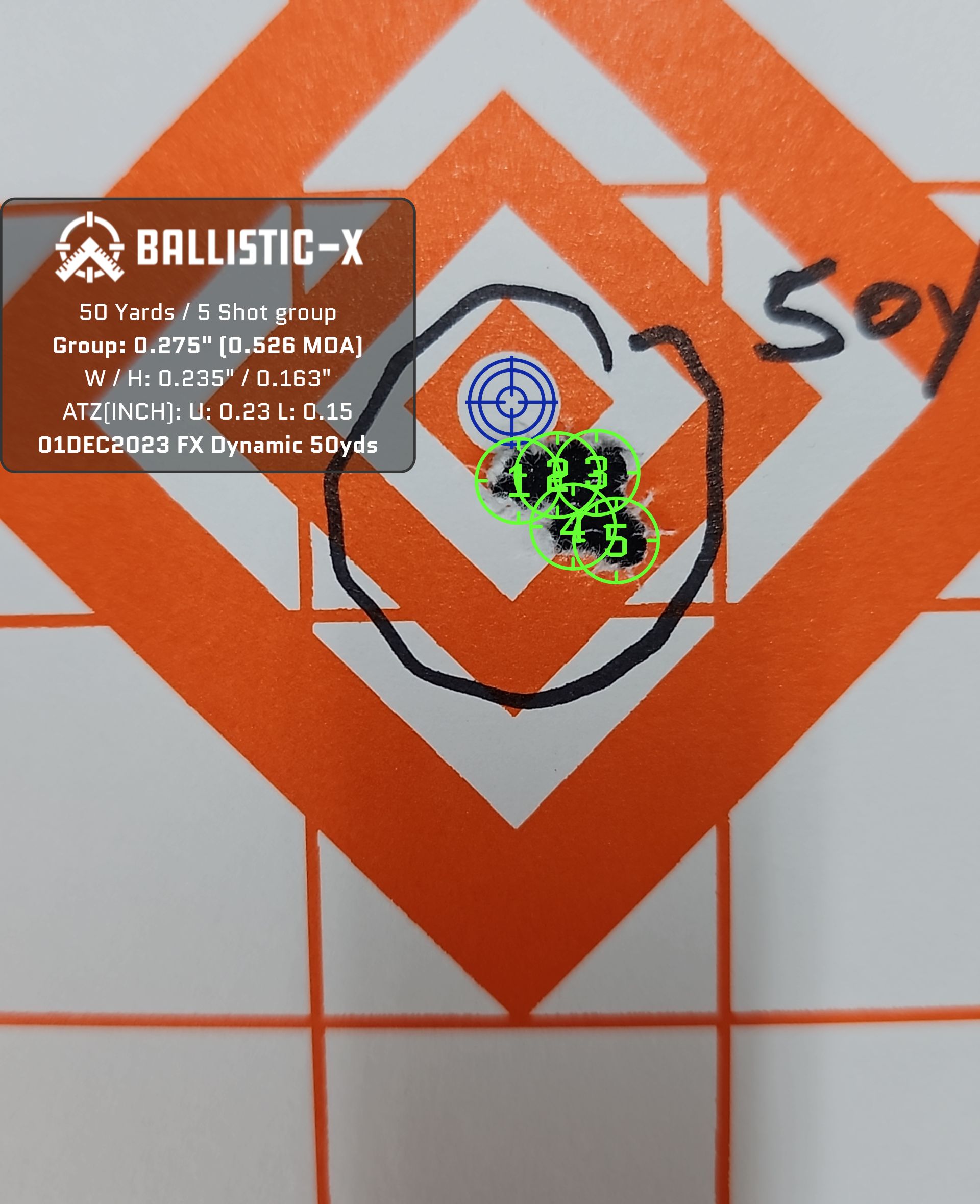

In a Walther 17.7 twist I'm running edit/32.3 Altaros Smooth at 885 fps in my Thomas HPX-S.
I haven't hardly shot them at 100Y but here is two 3 shot groups while confirming dope at 100Y.
In a Walther 17.7 twist I'm running 32.5 Altaros Smooth at 885 fps in my Thomas HPX-S.
Looks good Steve. The spread is all vertical, how does the SD look for that Thomas? Your variation is only vertical which looks like a speed difference and not a wind difference. How does that compare to the .25 V3 with 49.5 Smooth or 60 Queens?
