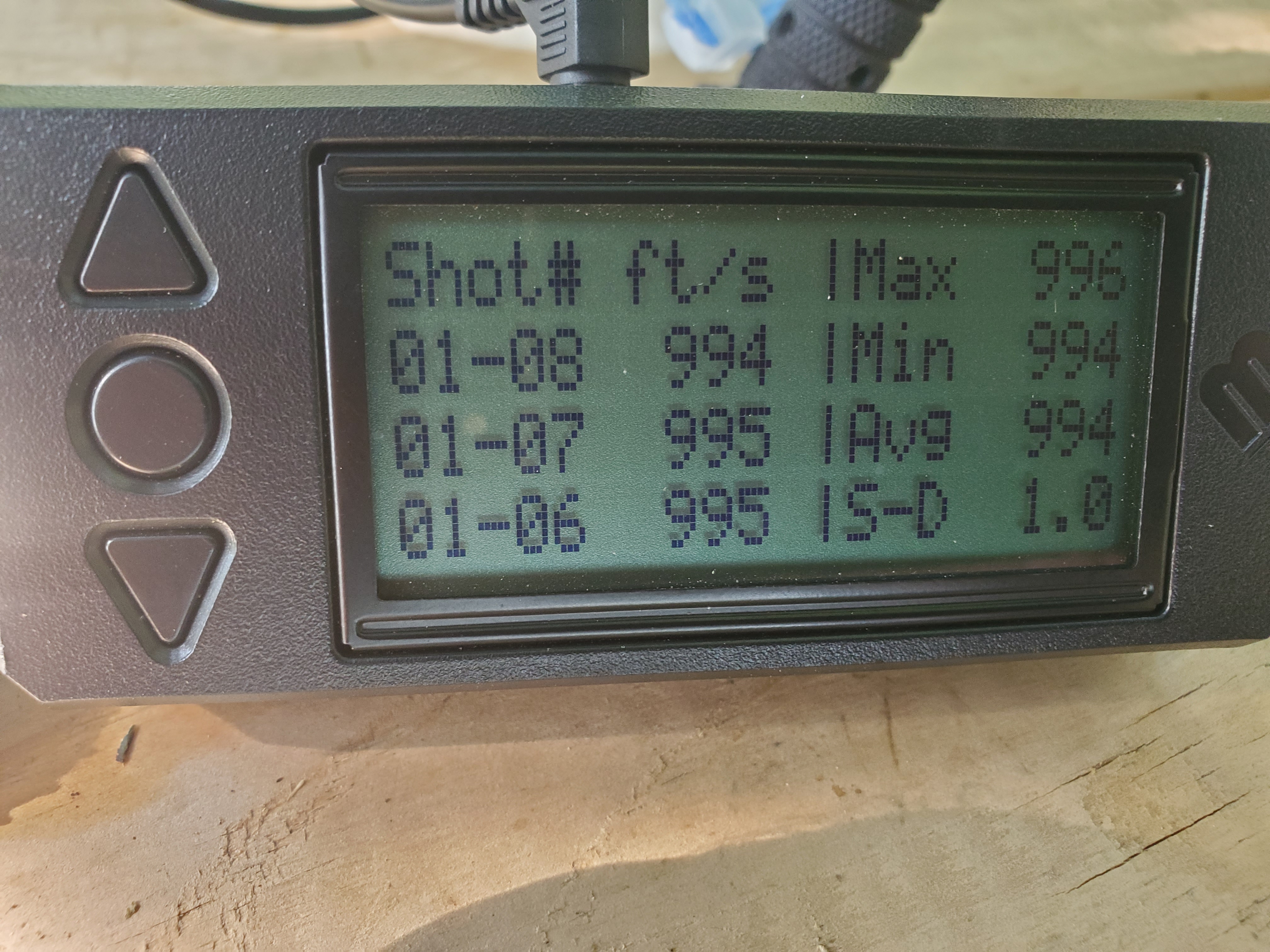

What is the chronograph reading telling you? Is your gun is producing consistent numbers? Are you letting the reg recover between shots?
I believe it is recovering between shots. Ill pay attention later today to confirm.

Ok yes 3.0 puts it in the peak barely.
Same reg pressure 145bar
3.5=999
3.0=994
2.9=990
2.5=900
Clicked it down a few clicks and at about 2.85 at 985 and groups improved. Ran out of time. Will report back after more lowering to 2.8, 2.75
I was firing too fast for the reg to get fully full. Made about 5 fps difference on chrono. Pulling the trigger about 3bar under full reg.
