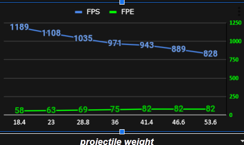

This graph should be close to representing what a .22 cal Panthera would do with various projectile weights at its max (180 bar~ iirc) set point with the magnum xl plenum and 600 mm barrel. I do not own one but it lines up with what you got on the 36 gr.
Thanks for the graph. I didn't realize the 600mm comes with the magnum XL plenum. But you're absolutely correct

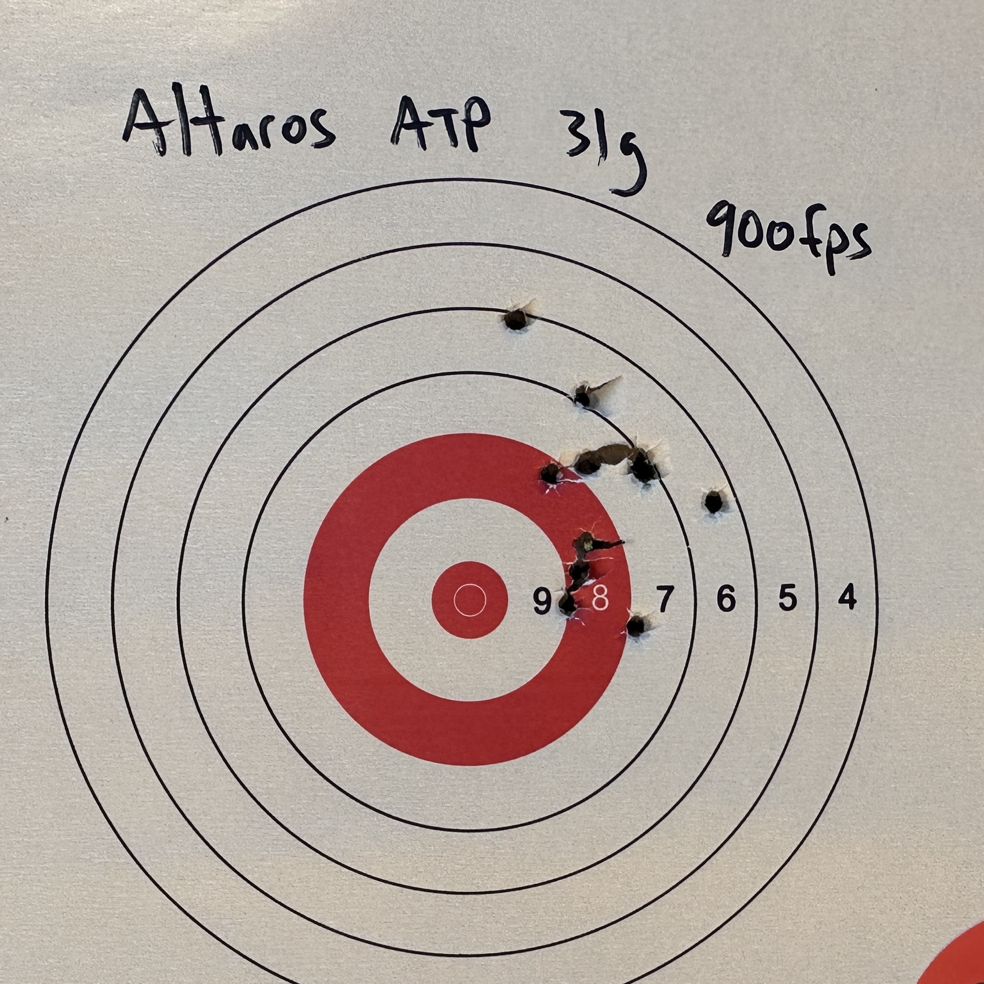

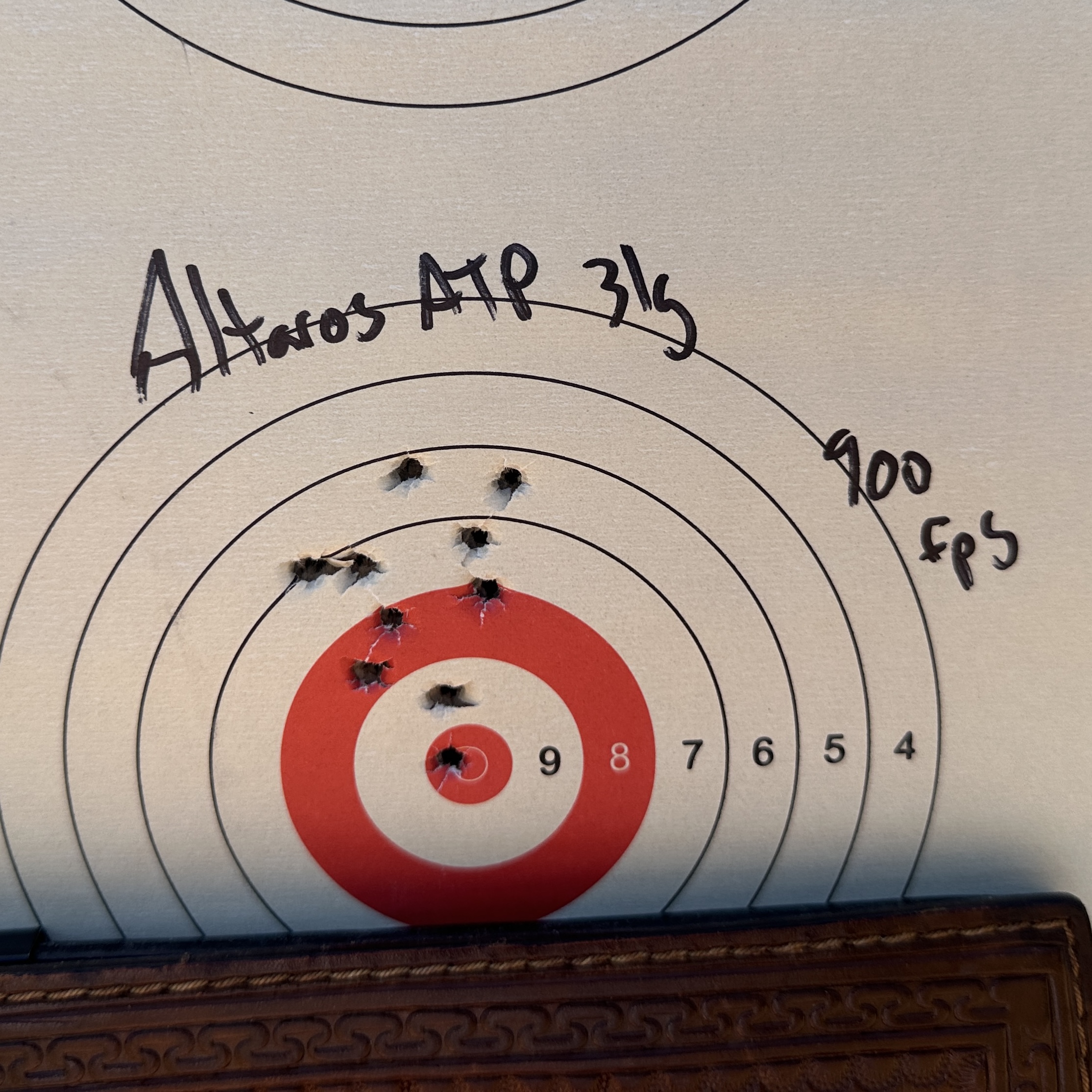

I had the opportunity to do some slug culling today. 10 shot groups (not trying to hit the bull) at 100y in gusty L to R winds.
With my reg set to 140b and the QTS at 2.45 (there’s actually 50 steps between whole #’s) I shot the Altaros ATP 31g slugs at 900fps with good results.

Yep -600mm. Micro at 2.9. I was shooting Javelin 26g with same settings at 980. But after trying the ATP smooths, I bought 2000 and tossed everything else out.
I only had the ATP 31g (not smooth) so I ordered some ATP smooths to try out.
I like that i didn’t have to push the Panthera too hard to get good results with the Altaros slugs. But I feel like the ŽAN 30.5g at 975fps outperformed the ATP 31g today. Though it was close.
View attachment 381750View attachment 381751
