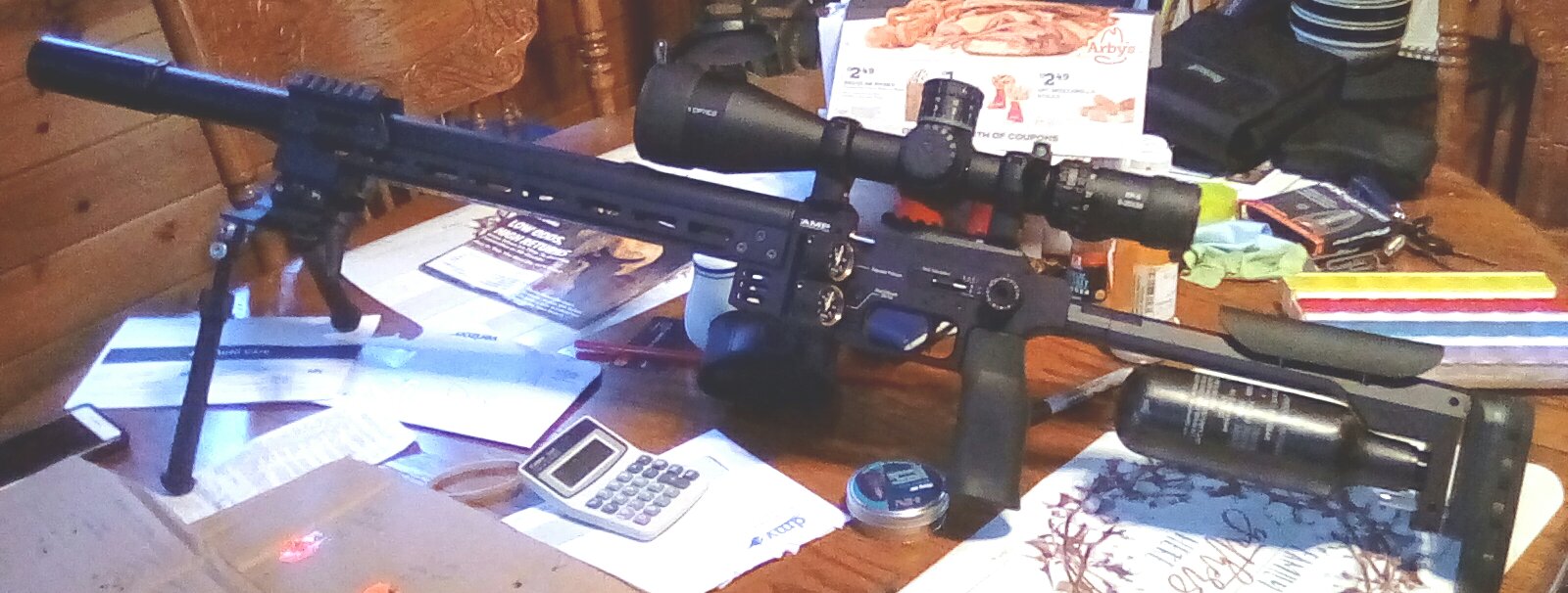

FX Panthera 500 mm slug and pellet tune

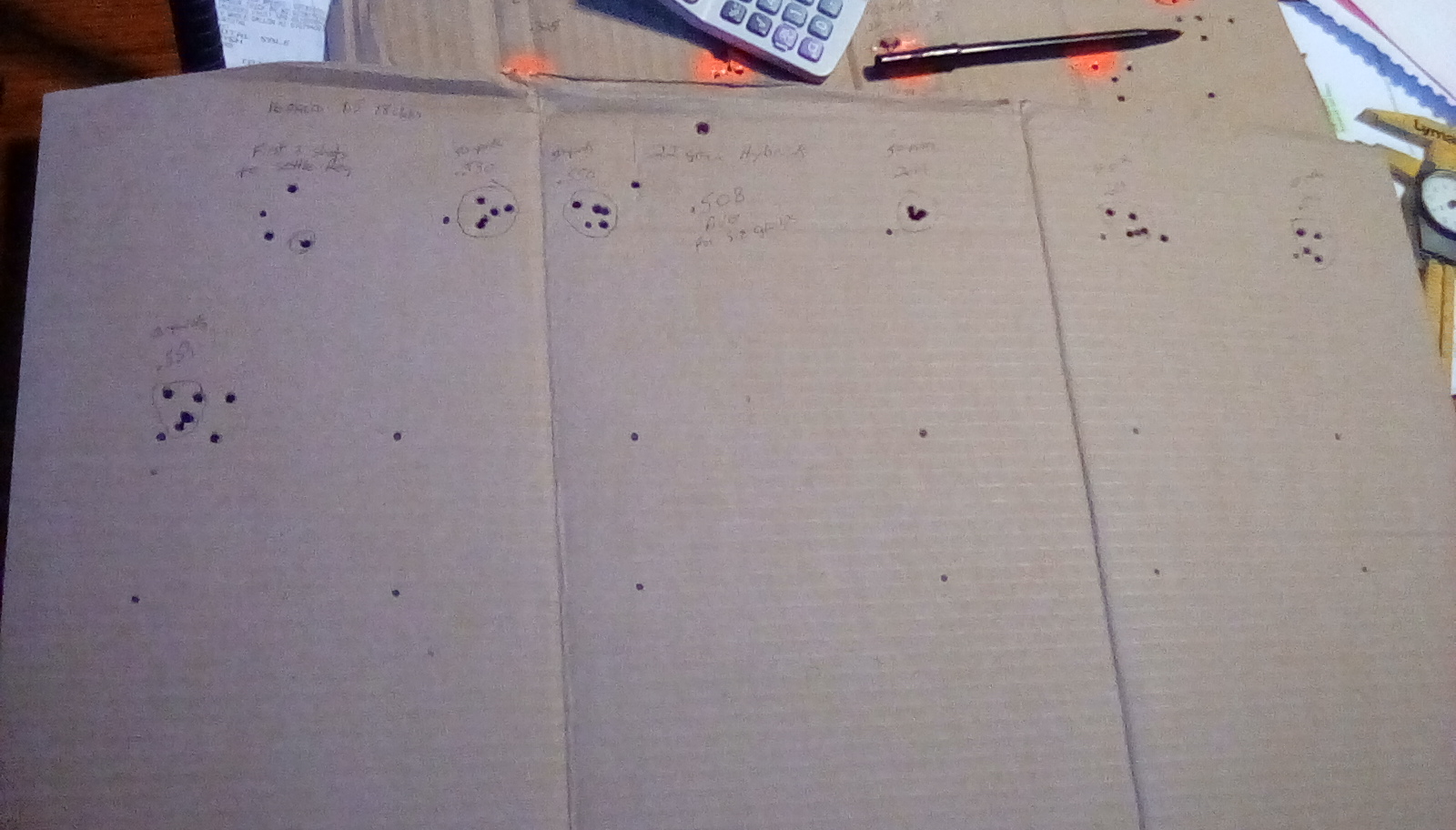

Finally figured out what tune the 22 grain hybrids liked. Macro 16 micro 1.5 and 18 clicks and 132 on regulater. Six 5 shot groups averaged .508 with the speed averaging 933 fps.

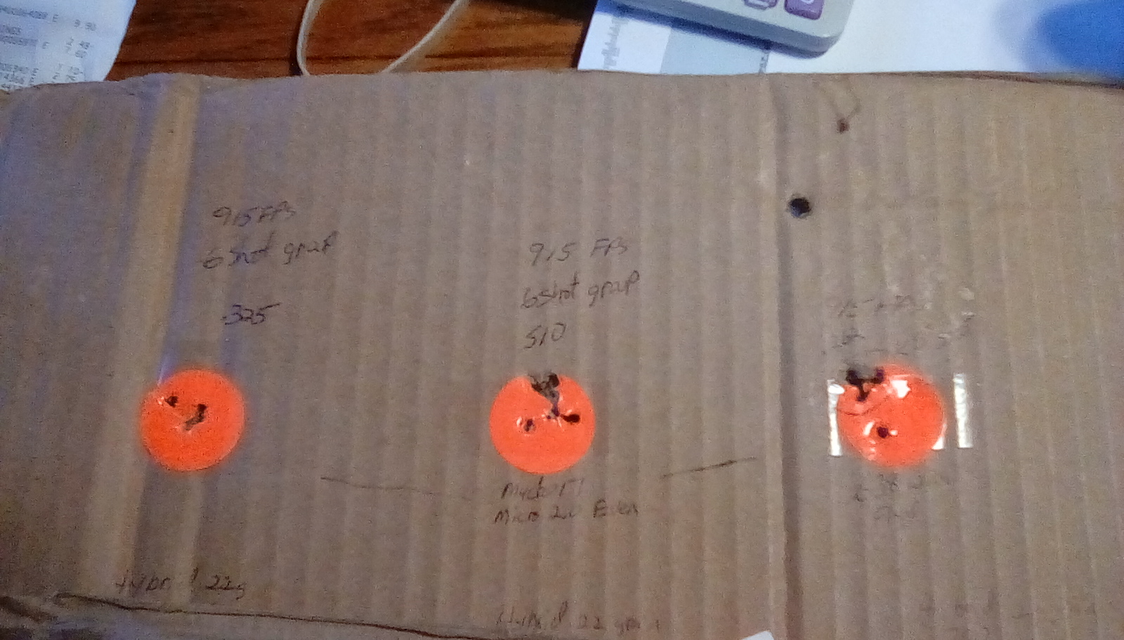

25.39 redesigns liked 17 on macro and 2 even on the micro. I have shot several groups in the .300 to .400 range and it likes 915 fps. Orange dots are pellet groups. Shooting black sharpie dots with hybrids . All groups are at 50 yards
