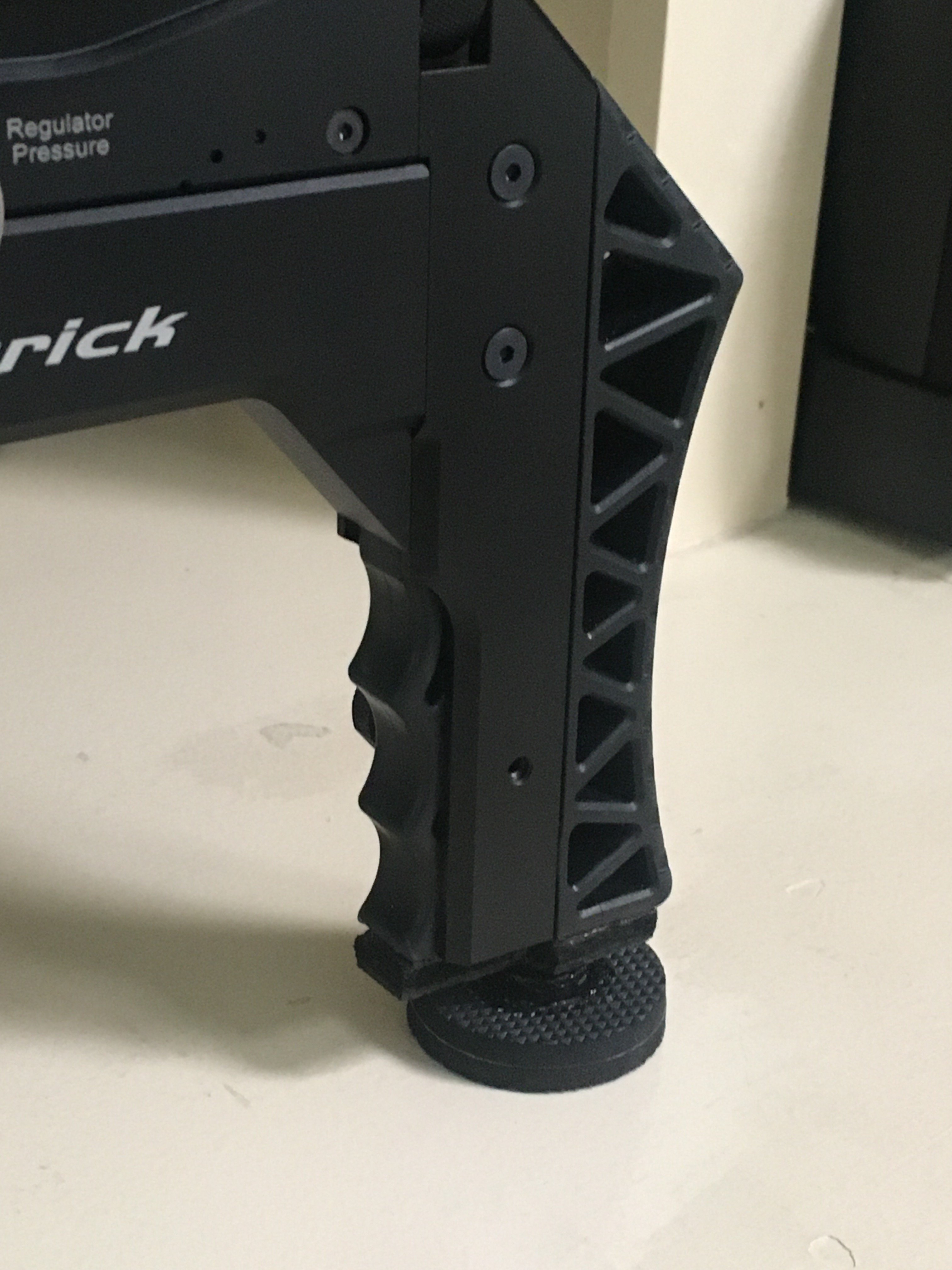

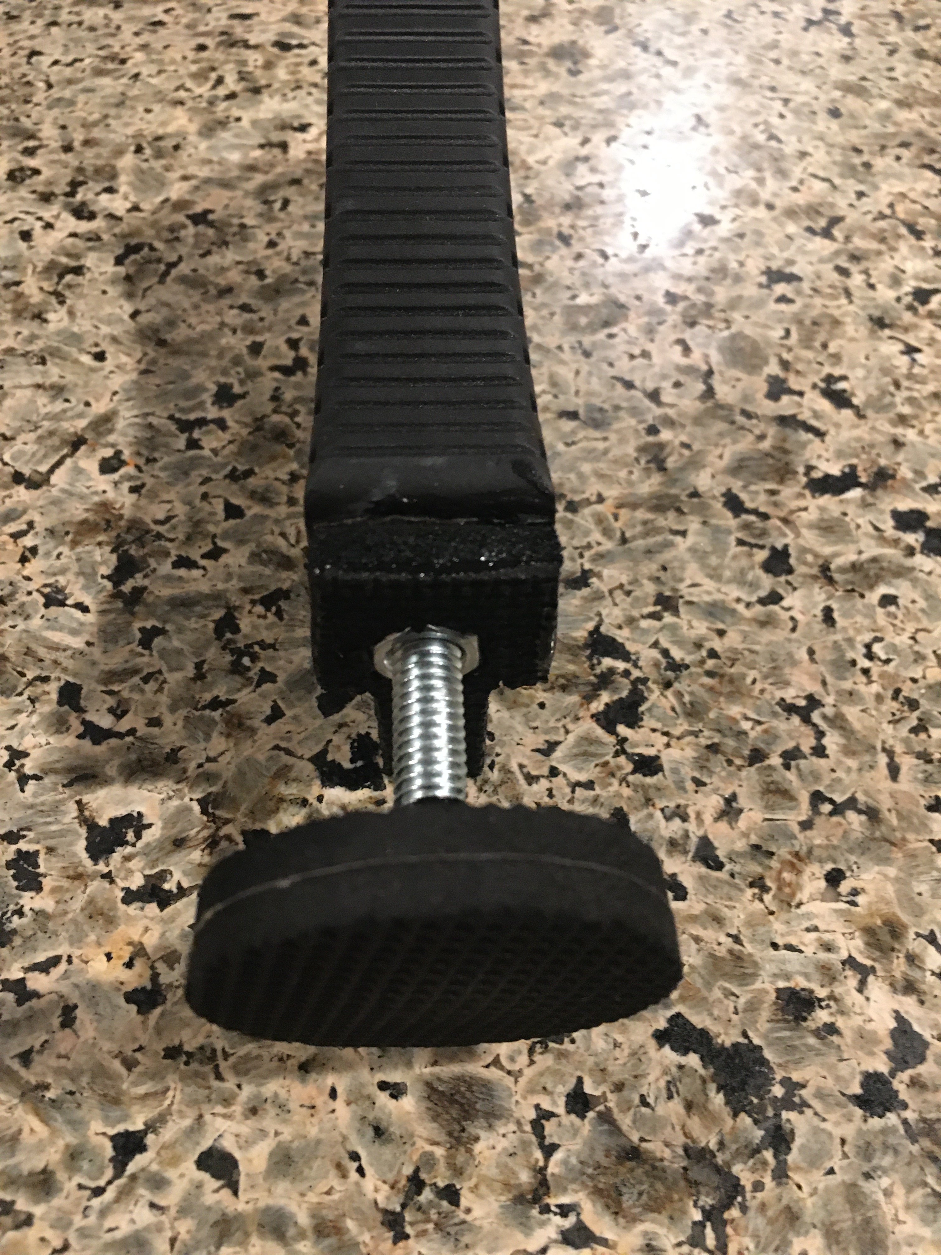

The budget includes the tripod. I know I know that’s not a lot. But my lack of funds have me doing stuff like this…. It was $.78 and works as well as I need it to.
