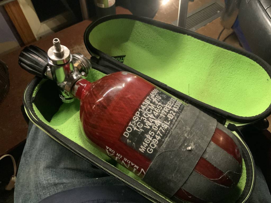

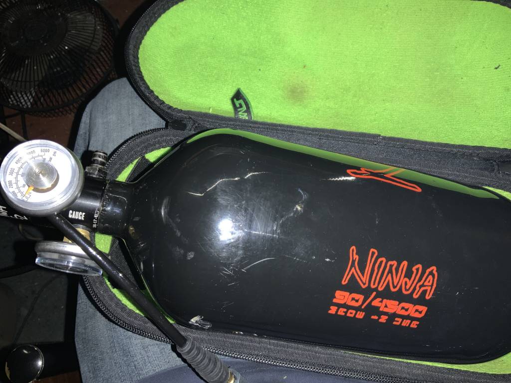

This is an old paintball tank I use to tether with. It is 4500 psi with the ninja 4500 psi reg for PCP rifle filling. It works great. The tank is a 90 ci 4500 psi tank as it is printed on the tank. I removed the paintball gun regulator and installed the ninja pcp regulator
So this is the skinny on paintball for the last 20 years! The carbon bottles have been filling from 3k-5k depending on rating just like our stuff. They have been running dual regs for over 20 years, they have been running solenoid triggers for 20 years! The paintball teams never use co2@7-800 psi, it was always nitro or compressed air.
If you remove the bottle reg or the reg guts, with the property rated fittings! They work great for the backpack or tethering! I have several for this purpose! 👍🏻 Beegee11, you got this! And they have the fill nipple on the side to fill from your scba tanks or compressor,very nice!

I have a typical D.I.N valve and fill whip on mine. I also carry it In my car to top up a low tire if needed.
